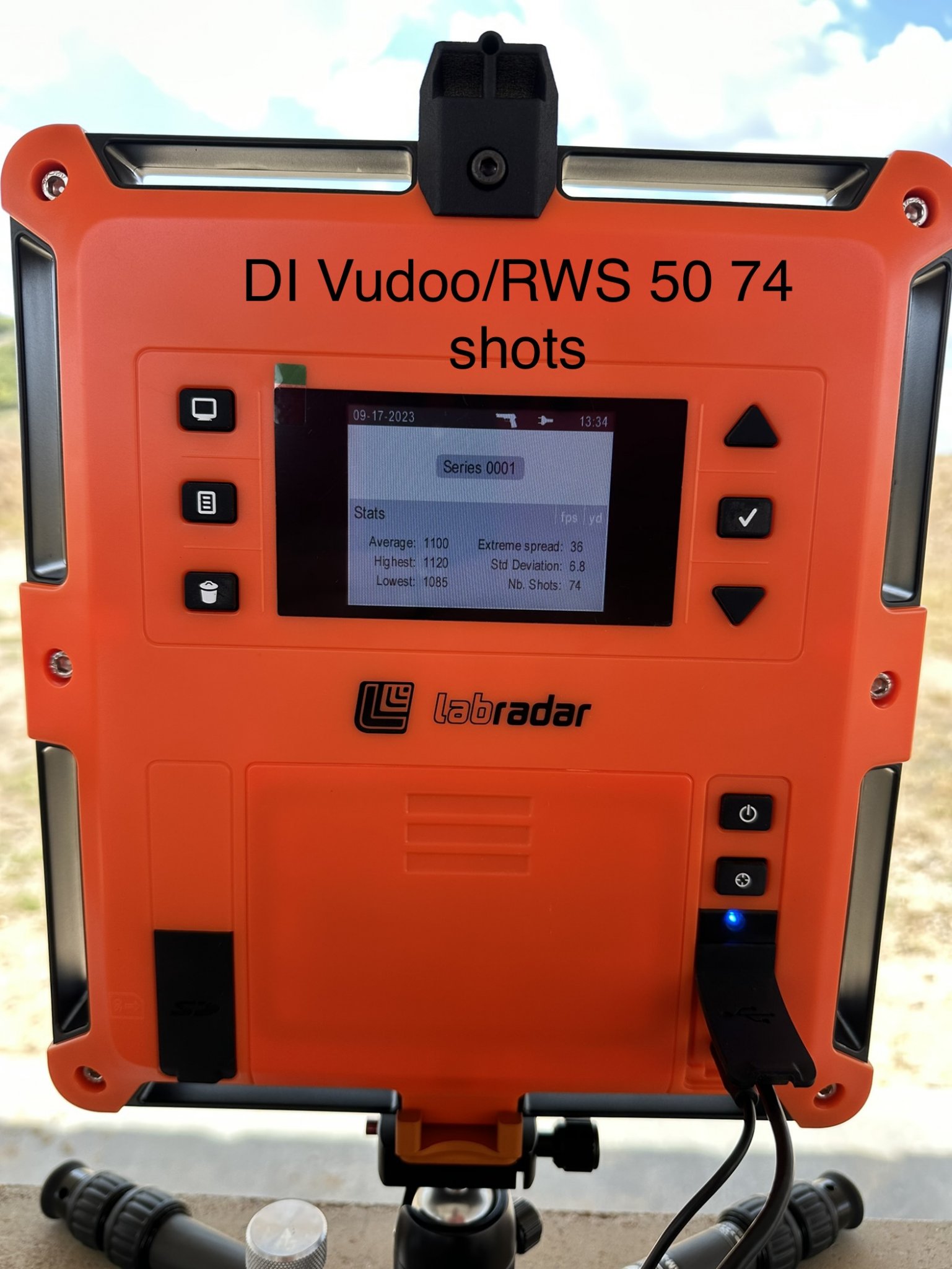

I know this isn’t exactly on the same topic but this past weekend I shot 75 rounds over my lab radar (1 shot didn’t pick up) of my RWS 50 that shoots pretty damn good through my DI precision Vudoo. Just wanted to see a big sample size over the chronograph. I would say it’s pretty good for rimfire and 74 rounds.
