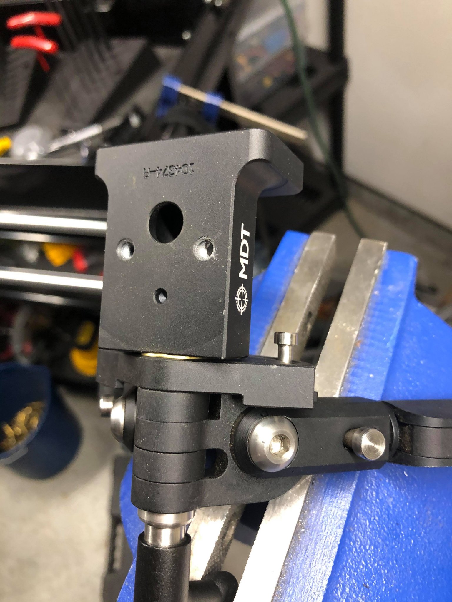

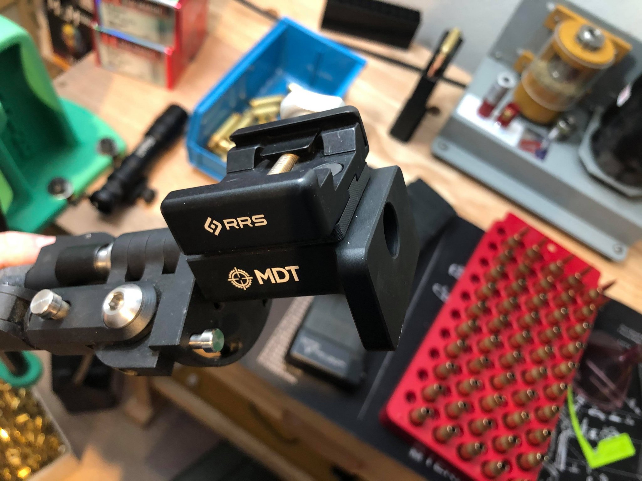

I love my Ckye Pod but didn't really care for the pan and also wish it had the RRS clamp so I can use acra and pic rail...
Took apart the pan head and found there was two convenient 10-32 tapped holes in the base. Weird since they aren't used for anything, maybe for fixturing for production?
But makes this to easy, so whipped out a little adapter plate so I could mount the RRS clamp for the atlas (and I guess any altas mounting platform) on the Ckye. And it's all solid mount so no pan that can come loose. 3D printed ABS for now, if I like it I might fire up the mill and make a couple of out AL.
It will fit got my cz back tonight fitted the ckye pod on to the 419 arca 12 '' rail with no problems well try it next month after getting a scope for it .
