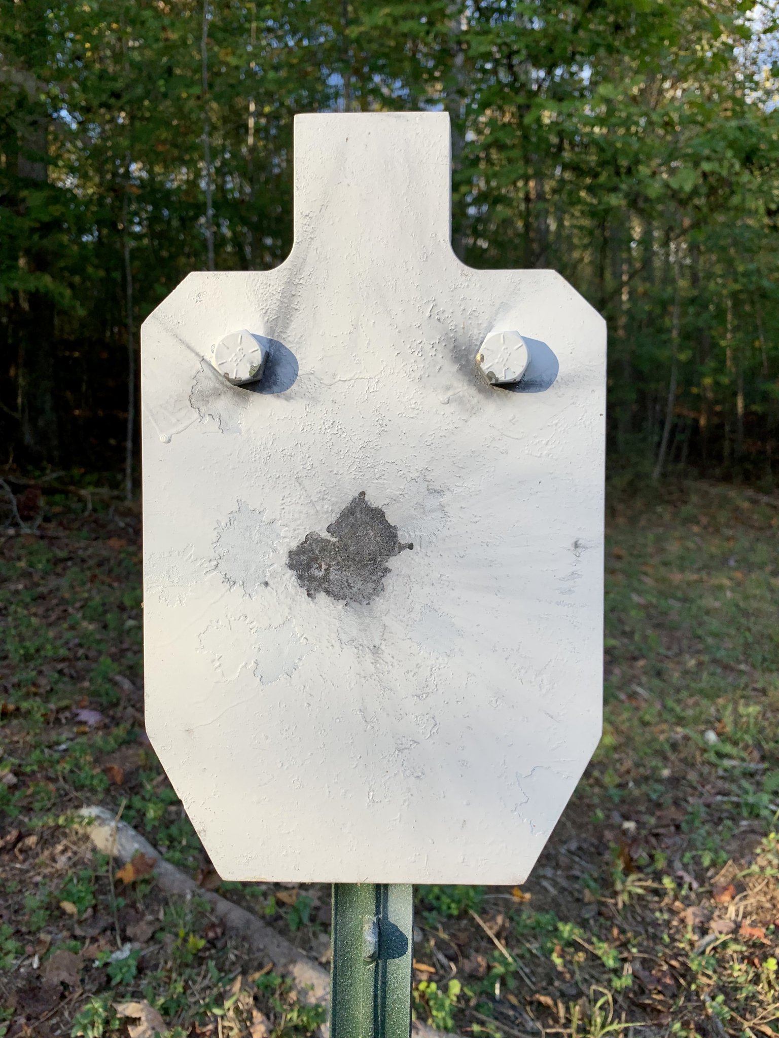

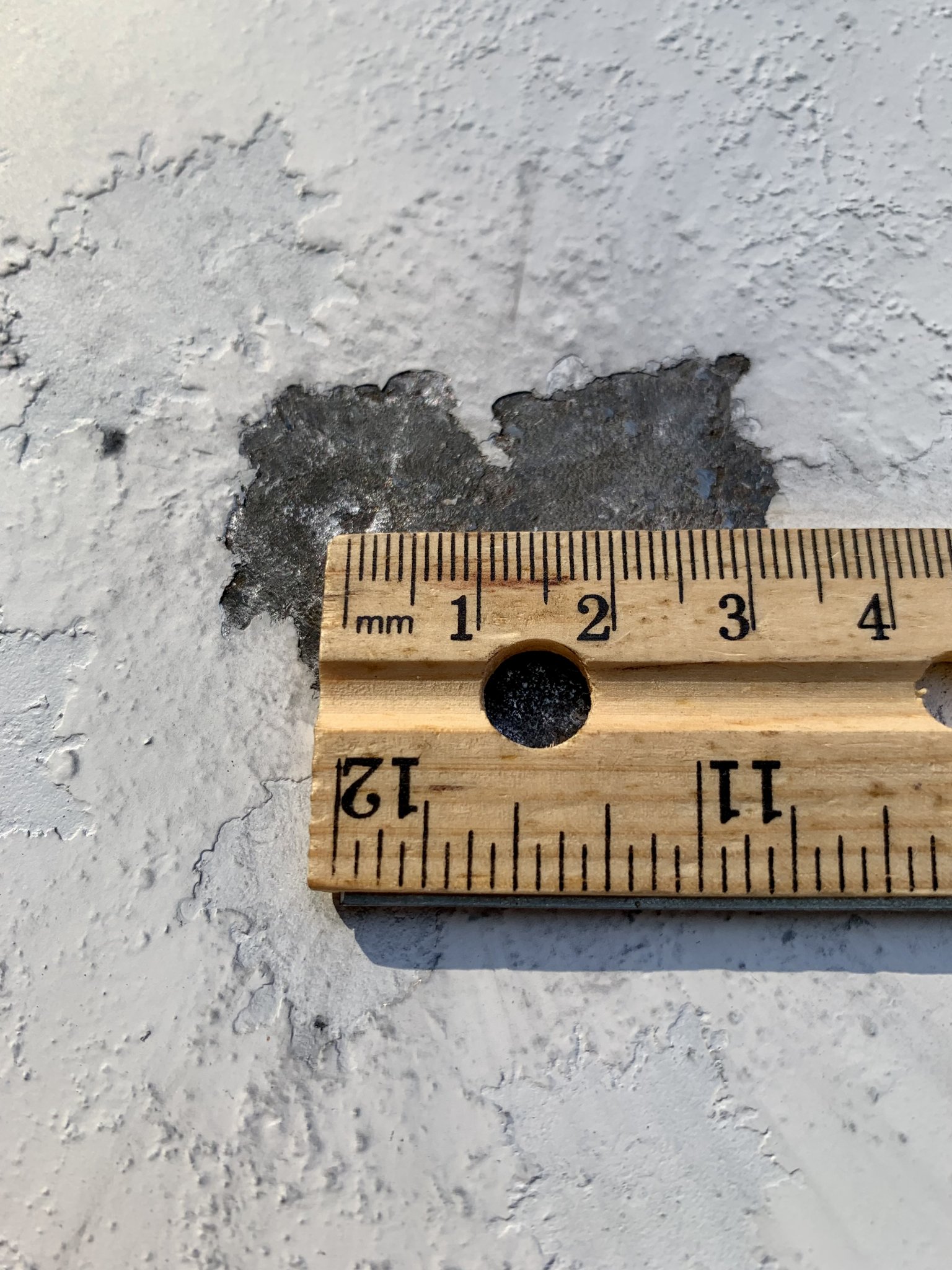

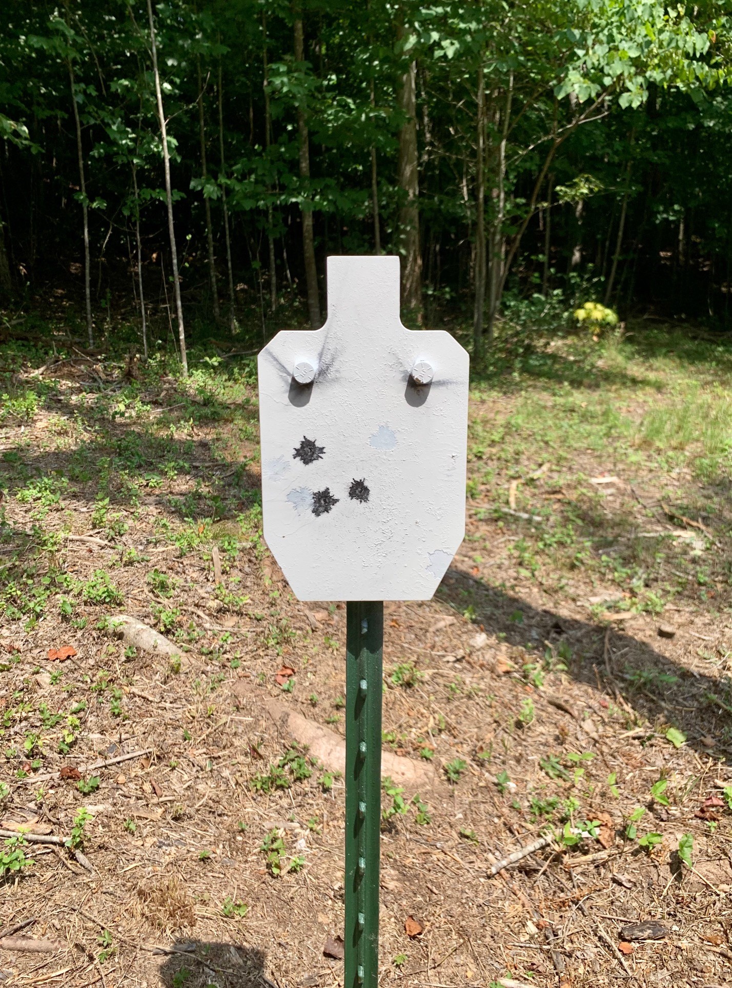

I needed to run a few more rounds through the SPR before I felt confident in developing a load. It only had 40 rounds down the tube, and I'm still running the load from my last upper. Wife asked to go too. Sure why not; it's just trigger time.
I crack off three and rang steel at 200, 300, and 400. I set it up for 300 because that is the largest plate at 12", and the wife leaves a gray spot in the center. I say lets try 400. She throws three rounds at a 40% IPSC at 400 yards and...
We drove out to the target, and it was a 2 3/16" group. She asked if that was good, and I said, well I know bolt guns that don't shoot that good.
I've since switched the plate rack at 400 to 4", 3", and 2" squares for a sort of KYL rack. I centered the 4" first shot, dropped the first low at the 3", and caught it with the second, and center punched the 2" with the fourth shot.
I can't recommend CLE and Bartlein enough. CLE puts together one damn fine rifle with arguably the best customer service, and we all know Bartlein turns out the best tubes.

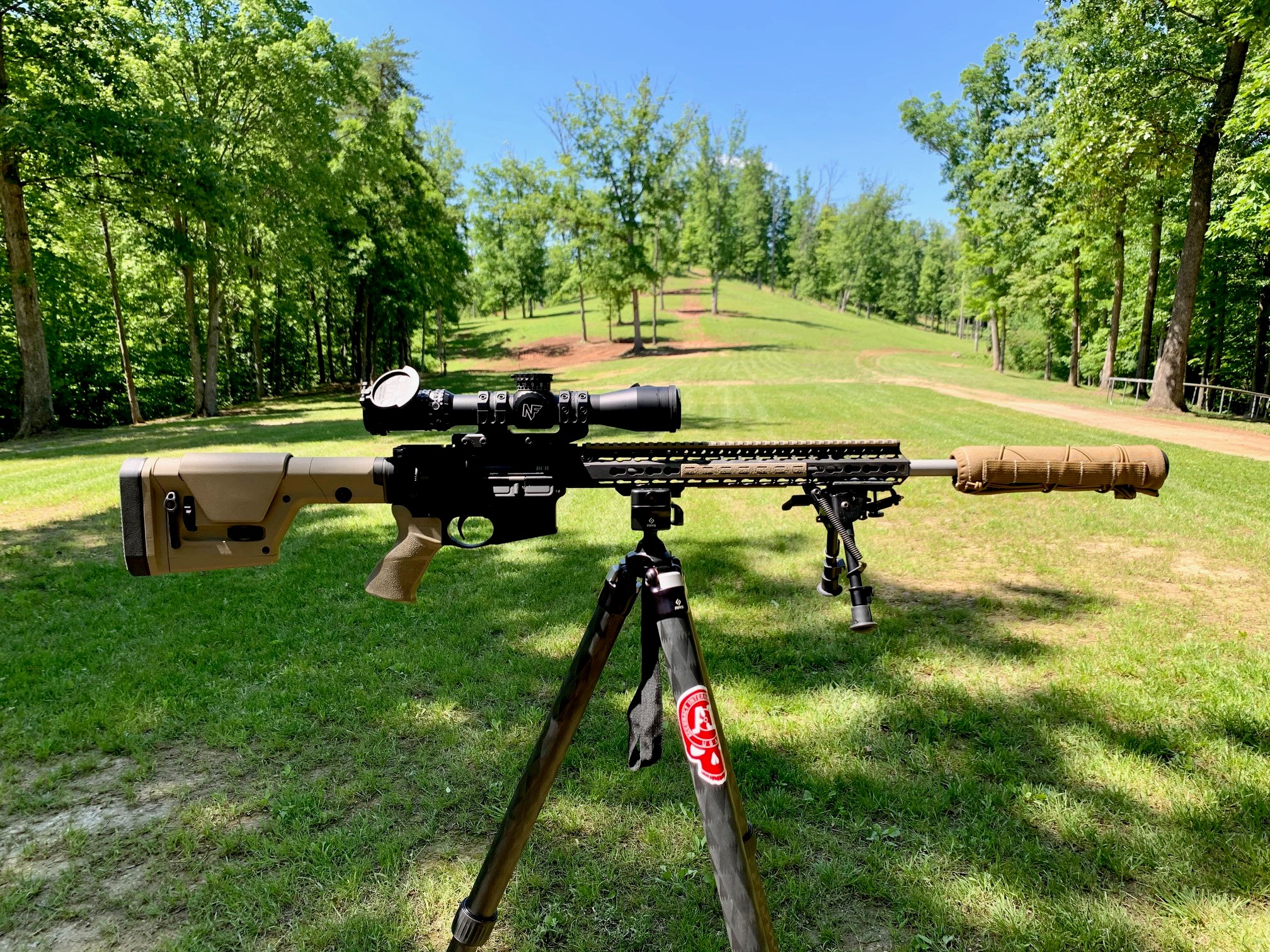

What caliber ?
Reactions: Brandon05_88
@bigjake83 @blbennett1288
CLE 5.56 Match Chamber
Bartlein 18.1" 1:7.7" twist four groove with intermediate gas length, and gas port in between lands
A slightly thicker than SPR contour with 0.875" between chamber and gas block, 0.740" to the muzzle with 5/8-24 threads
It is bedded with Loctite 620.
Vltor MUR-1A upper
BCM KMR 15" rail
BCM BCG and 3x3 ambidextrous CH
BCM low profile 0.750" gas block
CLE gas tube
BCM lower
Geissele SSA-E
Tubb's flat wire spring
H2 buffer
Magpul PRS gen 3
Nightforce 4-16x42 F1 with Mil-C in a Spuhr 4016
Berger 77 OTM
Varget 23.5 grains
Lapua brass
CCI BR-4
Vltor MUR-1A upper
BCM KMR 15" rail
CLE gas tube
BCM lower
Geissele SSA-E
H2 buffer
Magpul PRS gen 3
Berger 77 OTM
Varget 23.5 grains
Lapua brass
CCI BR-4
2.250"
The first 20 rounds unsuppressed chrono'd 2,633 fps with an ES of 28 and a SD of 8.
