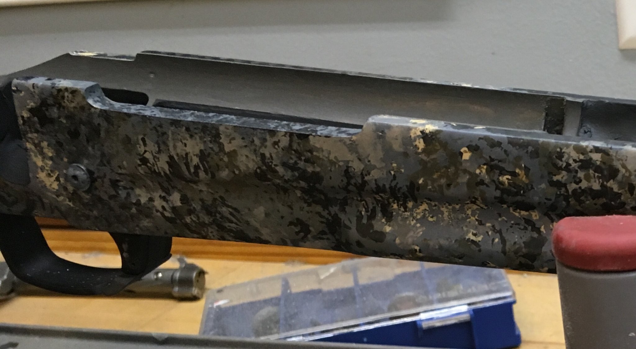

I use 70% isopropyl rubbing alcohol and start clean-up immediately after securing the action in the bedding of the stock. I finish with WD40 to moisturize the parts. I use Devcon and cover the action above the stockline woth gift wrap scotch tape. Devcon metal particals are abraisive and will rub off paint and finishes on the action or polish a shiny streak along the stock line from wipimg away excess bedding material with q-tips. I have bedded at least 25 different rifles in this manner. Never had any issues after I figured out the scotch tap trick to prevent the abraisive polishing from wiping away the Devcon.
This method requires nearly zero sanding or finish work to the exterior perimter. Of course you will have to mill oit the mag well and trigger area omce the action is removed after curing. I use a dremel with a carbide bit. I have a pretty steady hand so it looks very clean when complete. Not the nest pic, but the only one I had on hand.

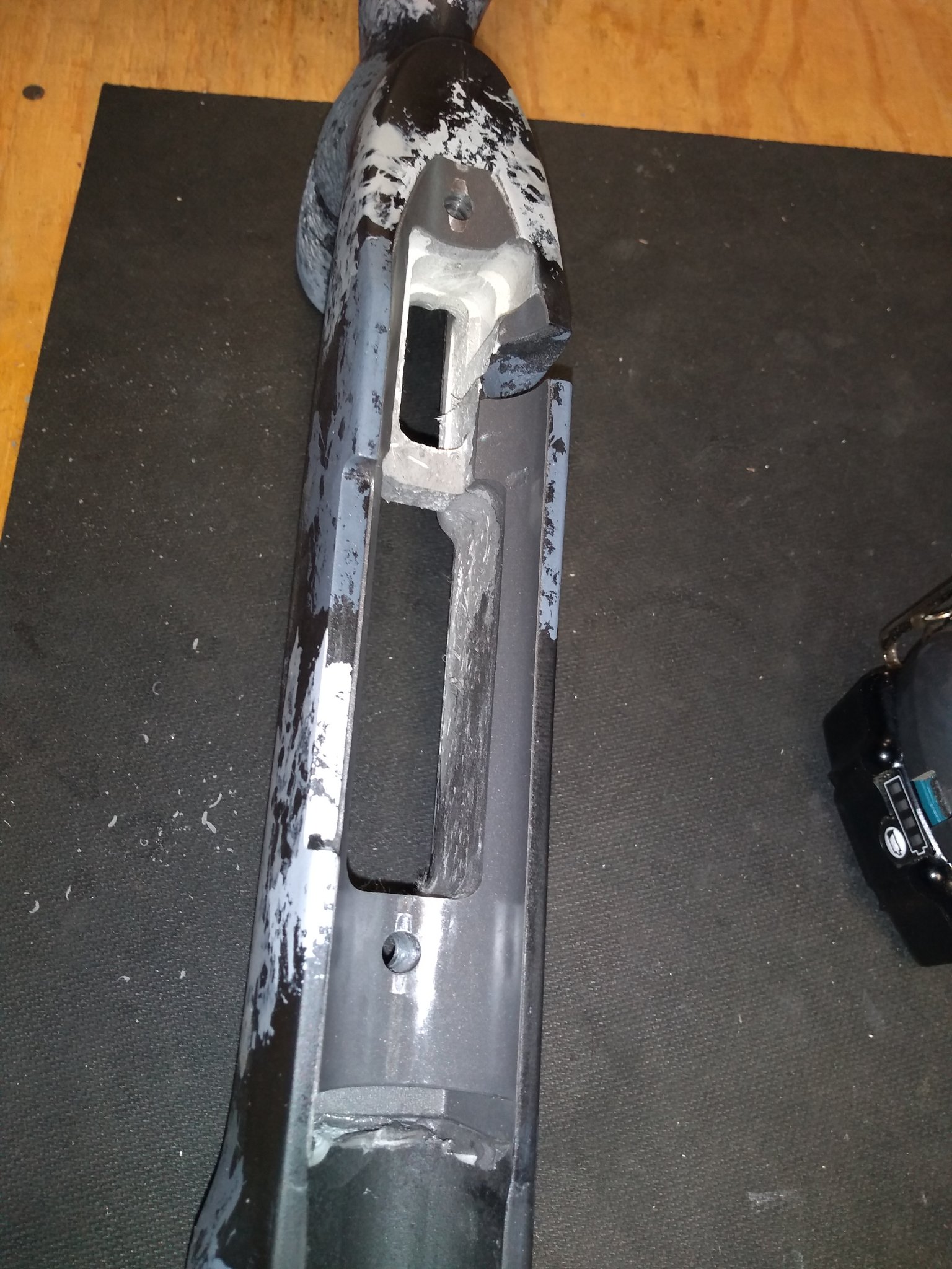

I used frog tape and more or less babysat with alcohol this time , i would it’s my best so far....... minus the fact I forgot to tape the lug ! F*
I use bedding studs and finger tighten them. The action didn’t make it to the pillars on this one but has an even 1/8 inch bed height front and rear. Is it ideal to have the pillar showing contact or does it matter as long as it’s stress free?
