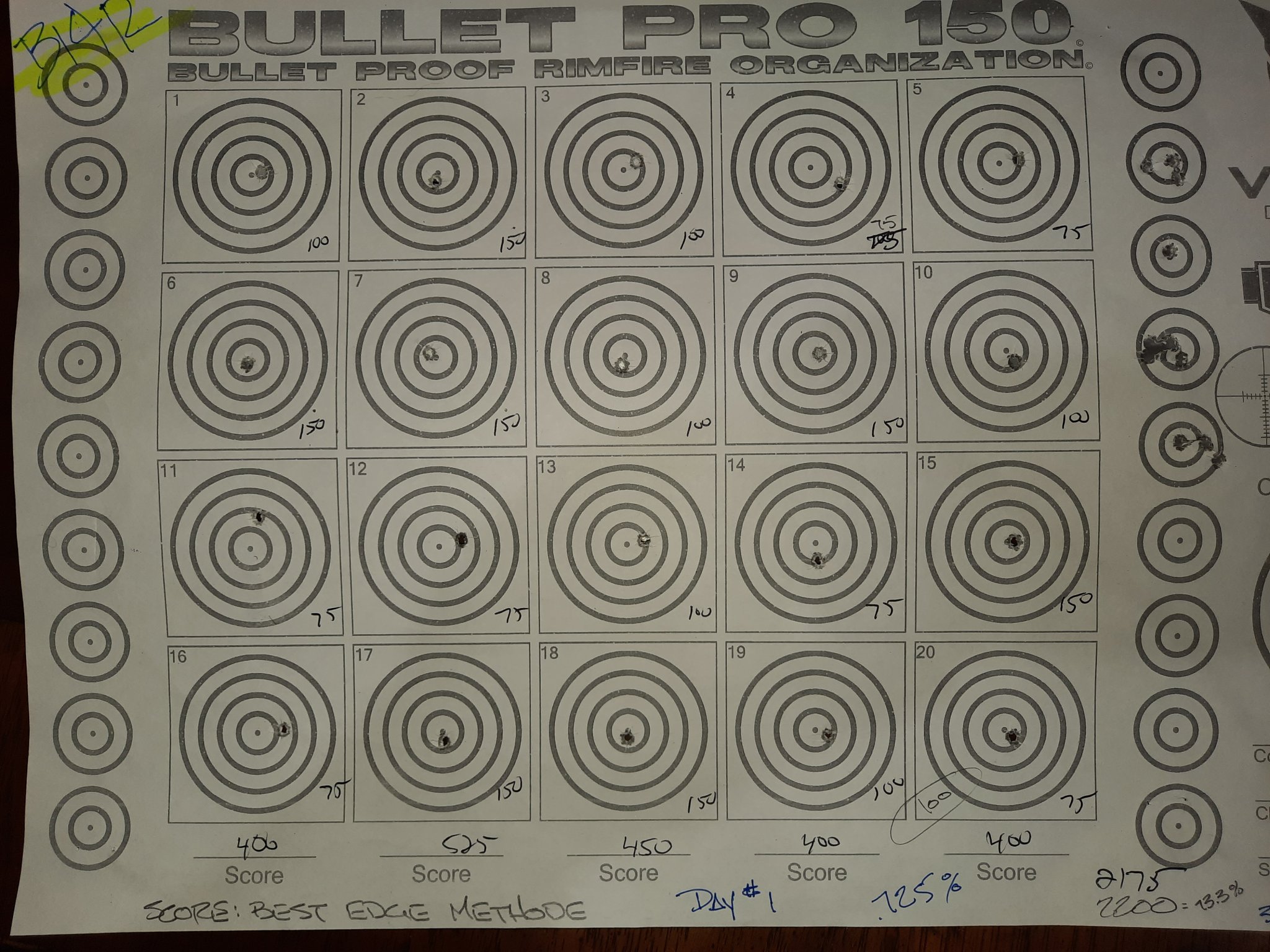

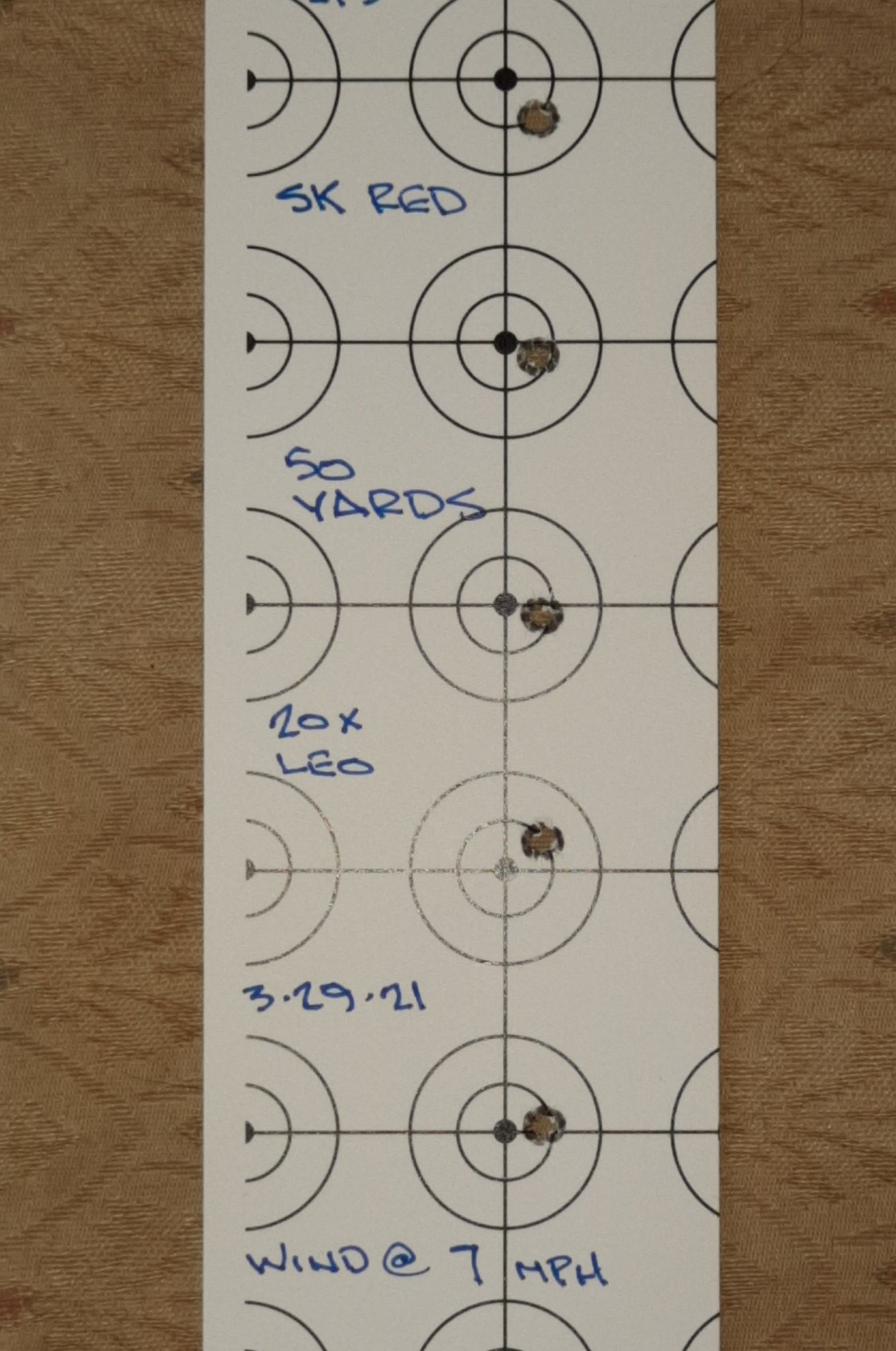

    I don't recall any of my guns ever having too much factory lube. Not my junky $275.00 Zastava ( those five shots surprised me ) I say junky because of the rudimentary trigger, the rest is fairly nice. or my many Anschutz or V22, or SAKO, etc. They all seemed appropriately lubed to me.
    When my accuracy starts to fail, I look to me first. I would make sure that I'm doing everything the same with every shot. You should send your gun for lot testing. My V22 shot 1.11" and then .34" while getting tested simply with different lots of Center X. Strangely, Midas Plus was slightly WORSE!
    When my gun is shooting well and then it stops more than once..... that's usually me getting tired or losing focus. I have changed my cheek pressure or I'm not pulling the gun into my shoulder with the same force.
    My POA with the Zastava was the .12" diameter circle and I had a tiny scope mounted and not one of my Trijicon 5-50s on her.

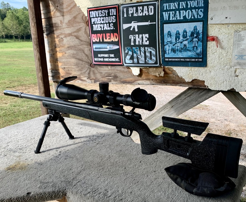

    @AirGunShawn Good info all the way around! I dive too and during my last trip to the cenotes (NSS-CDS advanced cave driver) in the Yucatan I had a burst disc pop. If it hadn't been for the spare set of doubles I had I would have been stuck as top side tender :( Pro Tip... Creative air fills can bite you in the ass! 4200PSI on Scuba Pro steel 100s sends people running for cover and you damn sure want to point the pressure gauge away from you when you crack the valve :LOL: As for the Bergara... I should have scrubbed it stem to stern as soon as I got it but I overlooked the bolt. They are NASTY from the factory and with good reason I assume. Broke my own rule with this one. Lesson learned and I'll check out those potions and lotions you mentioned! Can't make it to Lapua this year but hoping to take a week and hand deliver it sometime in 2022. Hopefully a time of year when it is "cooler" in Mesa. Lastly that is a good looking Bergara! I like how you filled in the logo! Here's mine...

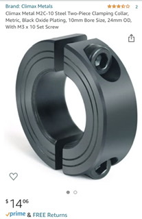

    Are those aftermarket adjustment wheels under your cheek piece? I hate to spend 295.00 on my Atlas bi-pods but they are very nice.
    I know you appreciate yours..... :)
    I wish I would have gotten the black stock but it's still a nice rifle for the money. I also hang-glide and rock climb. If your not willing to be responsible for yourself and make superior decisions, buy quality equipment, take lessons when your supposed to... you just wont last very long.

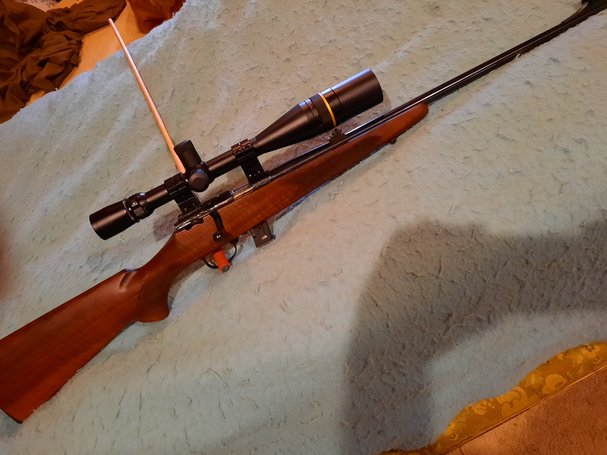

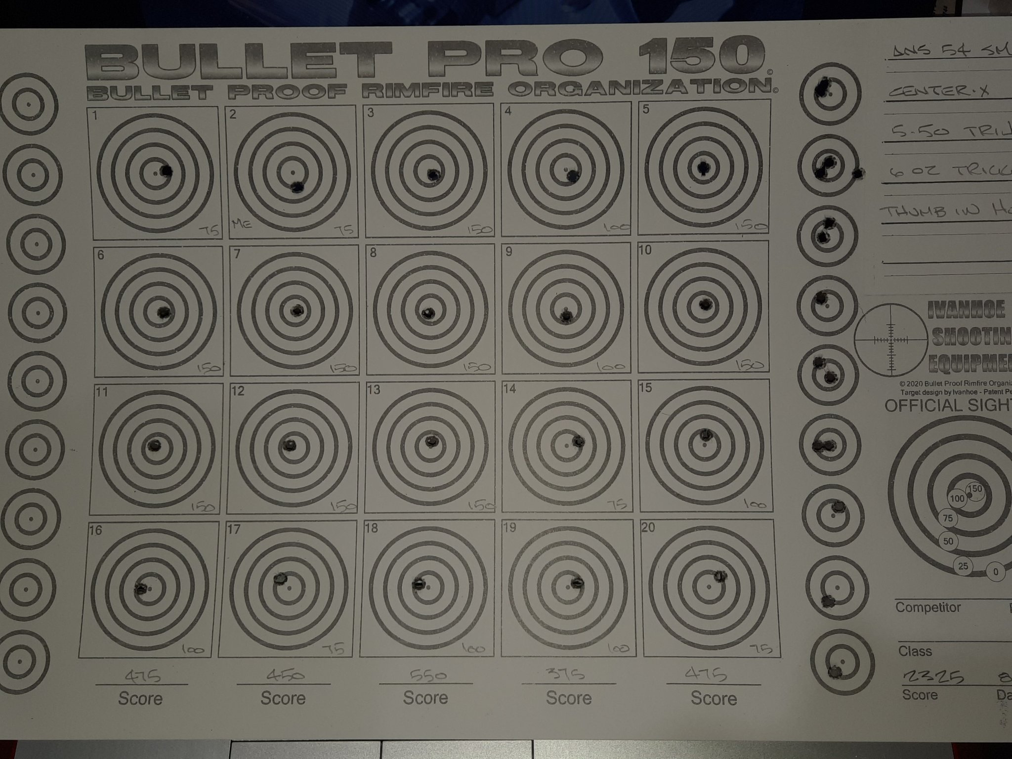

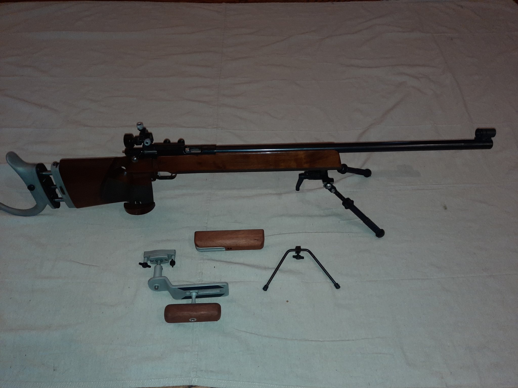

    I know that Lapua in Arizona has a fixture for your B14R. I'm going to be sending in my 1971 Anschutz 54 ( target below ) and Kimber 82G very soon. The testing is $50.00 for each rifle and that is waived if you buy two cases of ammo. You would need to check with Ohio.

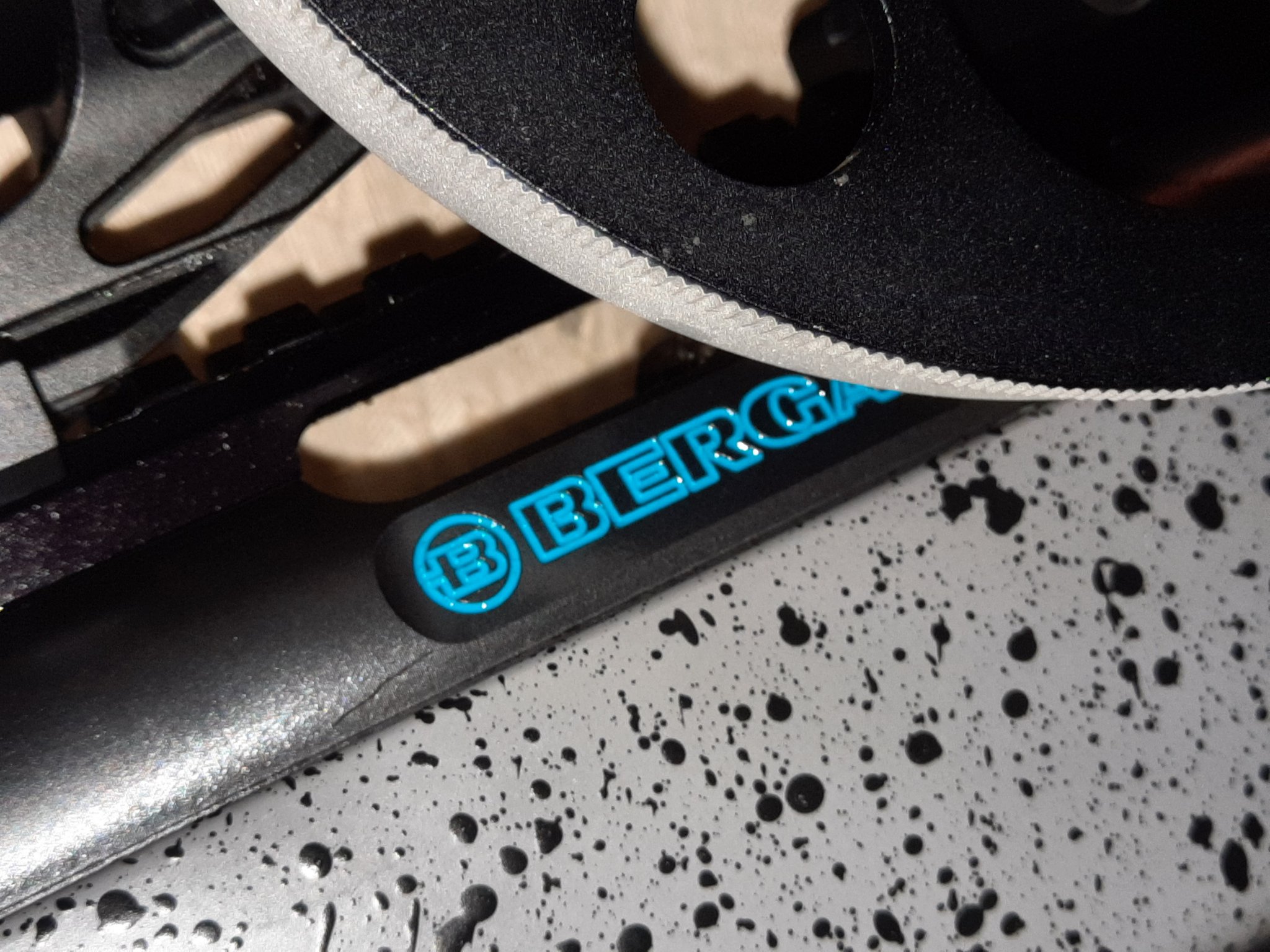

    As far as the enamel or lacquer finger nail polish in the Bergara logo...... I tape off the area and then hap hazardly paint over the entire logo and surrounding area. Then I take a thin flexible piece of rubber or plastic ( Bondo scraper is shown ) to remove the bulk of it like a windshield wiper does. Then I wrap my scraper with a piece of paper towel and get it damp with a small amount of lacquer thinner to remove the surrounding ghost or shadow. By wrapping the scraper, and using on it's edge as shown, you minimize the removal of color from the engraved area. After a short time, you can apply this to rounded features as well. It's a three minute procedure that turns out pretty crisp. I tried Lacquer pencils from Brownell's and could never get good, crisp, even fill like the factory gets.

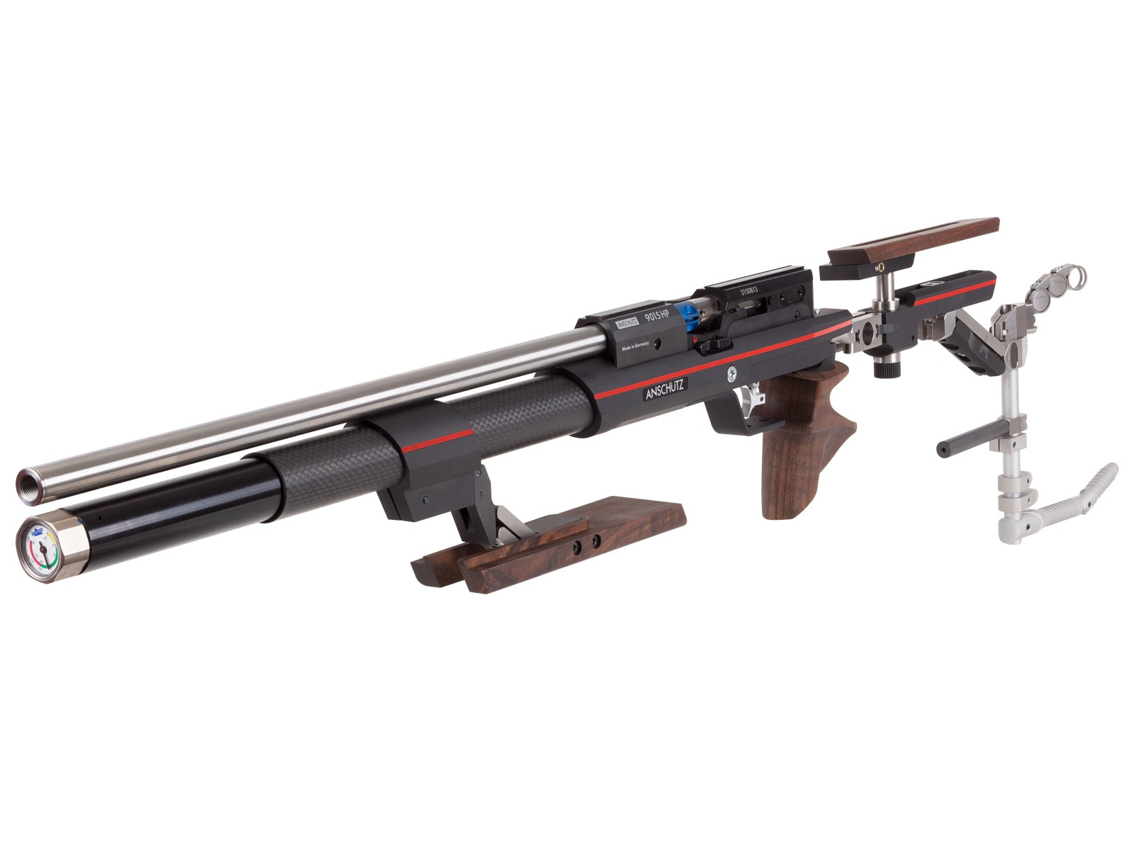

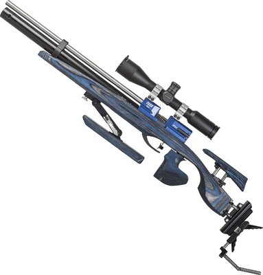

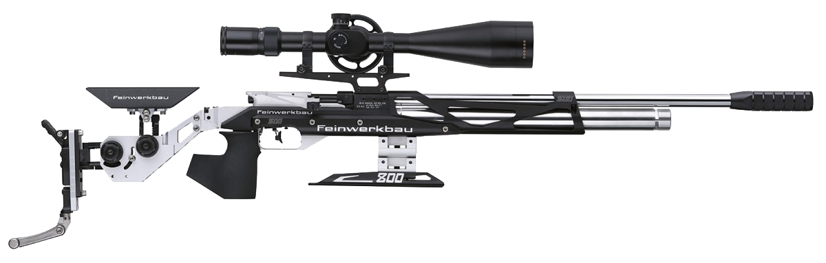

    With any luck.... ( Proper planning ) I should be able to get back into air rifle Field Target competitions next spring.

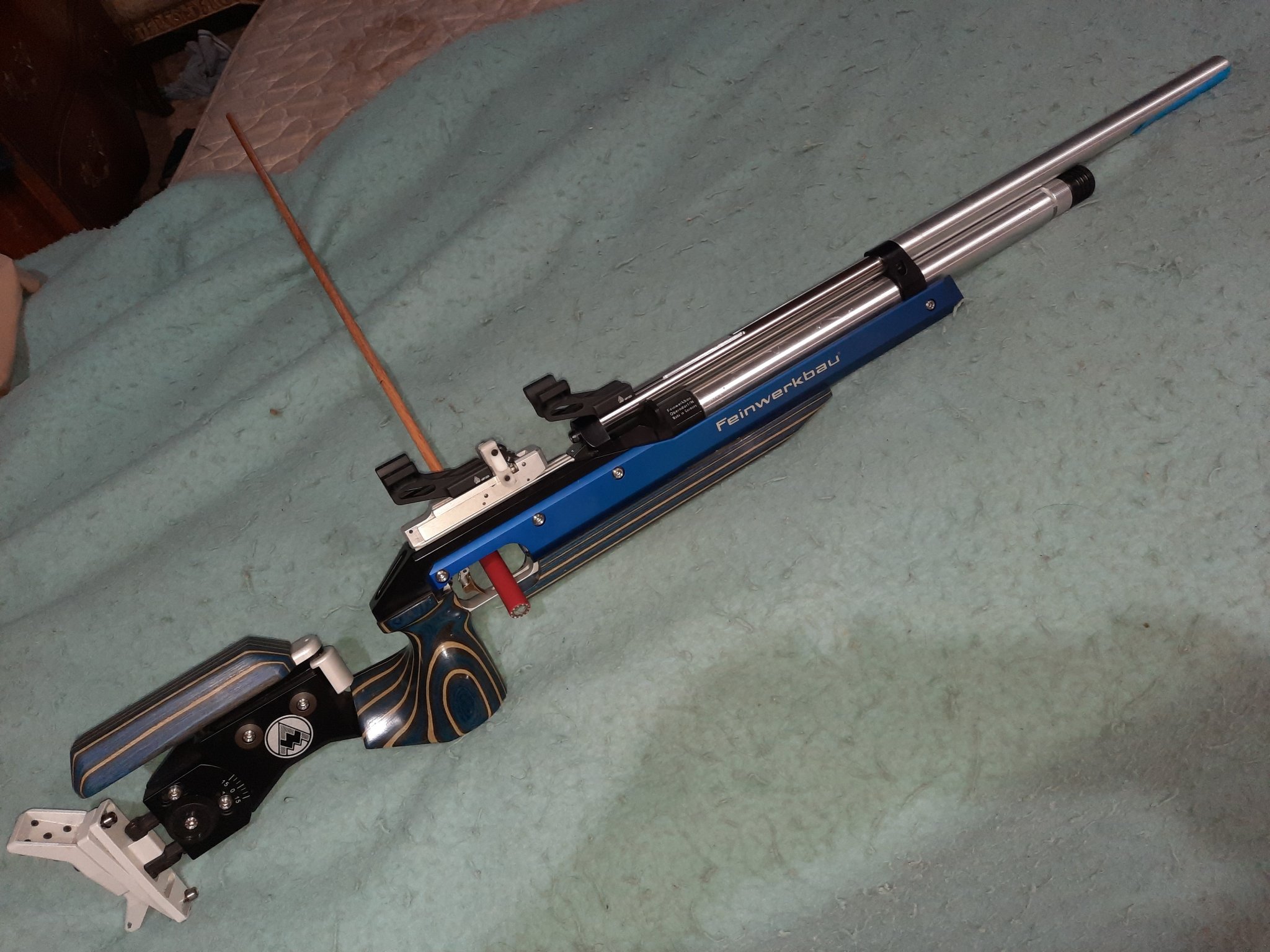

    Which air gun below should I buy?? Anschutz $4400, Daystate $2400, Feinwerkbau $3400? I have the last one... It's a 2007 FWB P70 HP.

    @AirGunShawn The collars are 10MM I.D. Climax split collars from Amazon. I was looking for zero stops for the cheek piece so that I wouldn’t have to fiddle with resetting the height every time I pulled it for whatever reason.

    P.S. I’m no air gun guru but Anschutz FTW? The 9015 in the ONE stock is a good looking rifle.
    Anschütz 9015 ONE - I've seen a couple with trigger issues with changing temperatures. Personally I went with the Steyr LG110 route. In Europe it's "the" Field Target work horse...
