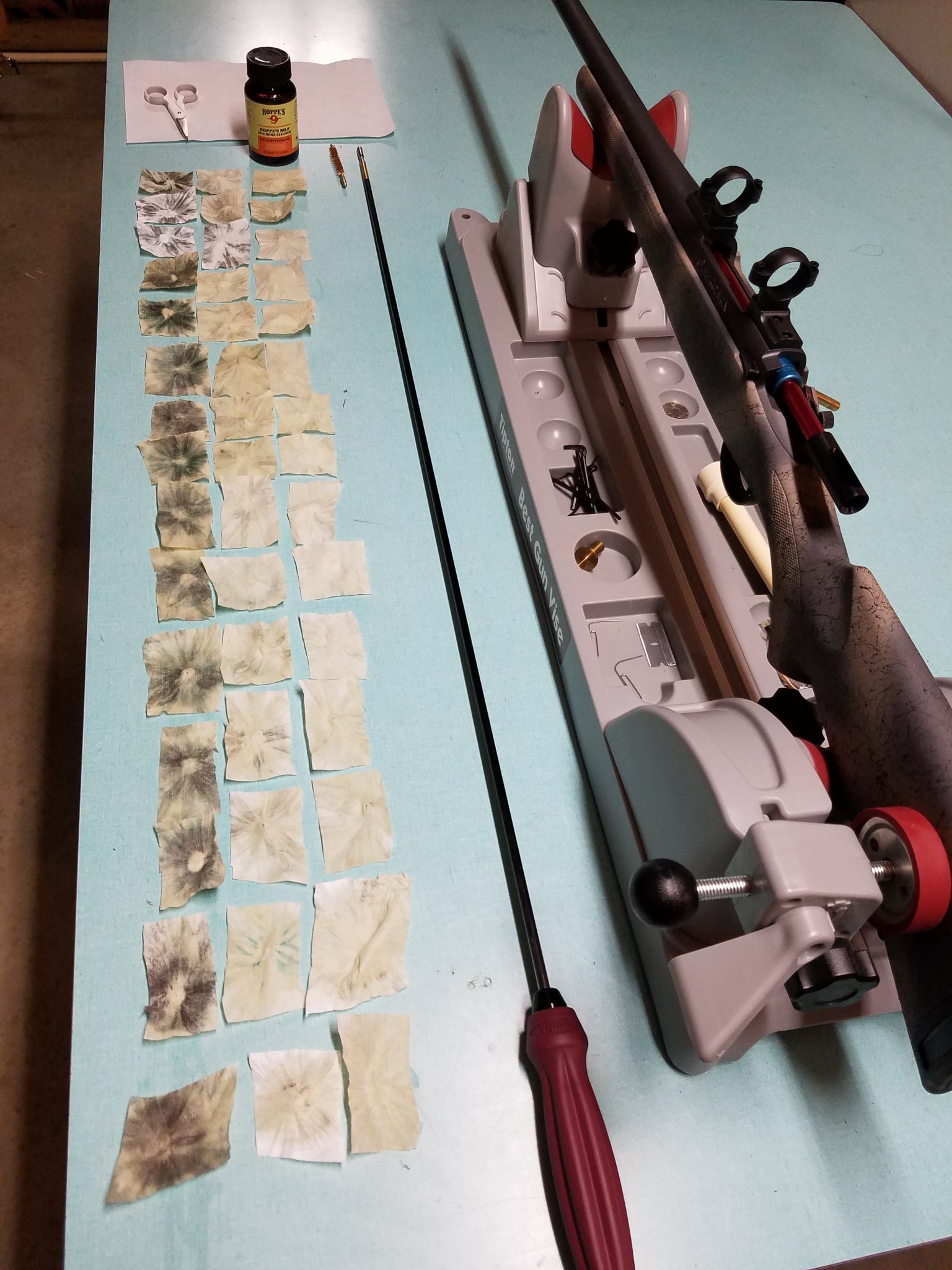

This is a brand new .300 Win Mag which I have not fired and I'm cleaning the bore.
Cleaning supplies:
Tipton one piece carbon fiber cleaning rod
Tipton .30 cal jag (Ultra jag set)
Dewey .30 / .32 cal no harm brass bore brush
Hoppe's #9 solvent
Patches cut from TX612 Texwipe 55% cellulose / 45% polyester clean room wipes
Pro Shot adjustable bore guide
Procedure:
1. Place patch on cleaning jag, advance into bore guide up to solvent slot, soak patch with solvent and run through bore.
2. Remove patch while still at muzzle end and pull cleaning rod back out.
3. Repeat until patch is clean (this has taken three passes each time).
4. Install bore brush on rod, wet brush and make 6 to 8 passes.
5. Start over at step 1.
Results:
Photo shows the patches from the first run to the last starting top to bottom. First patch ran through after bore brush from each run is on the left, second, then third. I don't seem to be making any headway after 15 cycles. Is this normal for a new gun and I just need to continue until first patch after the bore brush is clean? If not then how will I ever know if the bore is clean?

Yes, mostly likely preservatives

It's a good idea to clean a new barrel. Get out preservative oil.
A bronze brush, even run through an absolutely clean barrel, will show black follow up patches. FOREVER. There is a polishing going on with the bronze brush and bore. Just like a metal polish on perfectly clean steel surface. It will forever black.
Maybe you’re dealing with bluing? Unless your barrel is Cerakoted SS or something.
I know that’s not a CZ, but CZ lore around their 527s and rimfires was that they blued the whole barrel, inside and out. Just dipped it in the tank.
So if you were relying on a clean patch on a new gun to tell you that the bore was clean, you’d clean until the cows came home.

New rifle , test fired before it left the shop . Dirty . If not test fired , still dirty . Always a great idea to clean a new rifle/barrel before you fire it, , Proof right here .
Thanks for all the replies. I should clarify what I meant by "Is this normal". I realize there would be crud in the barrel of a new rifle but is it "normal" to still be getting dirty patches after 15 rounds of bore bursh / solvent soaked patches. Some have commented that I will never get a clean patch right after the bore brush. Maybe my expectations were off for this Bergara rifle but I want to do everything I can to get the best accuracy. Regardless of what solvent to try, I'd like to hear more people comment specifically on:
1) Will I ever get a clean patch after the bore brush?
2) If you answer "yes" to the first question, how many more times could I expect it to take?
3) If you answer "no" to the first question, when do I stop?
Thanks!

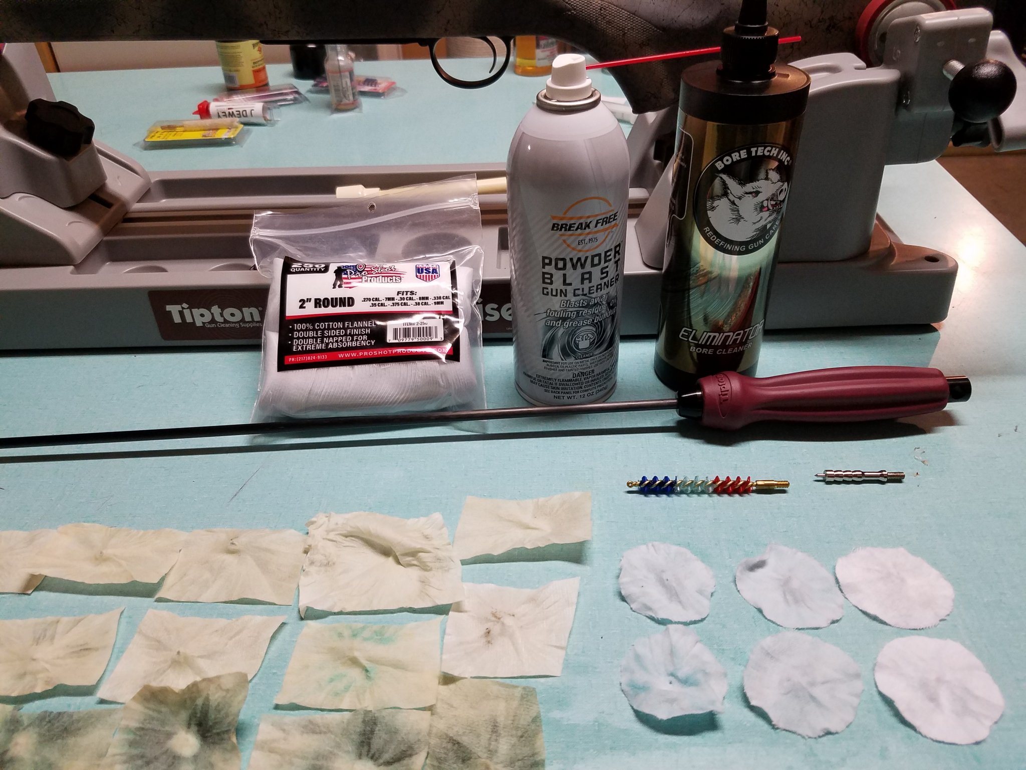

Thanks again everyone. Acquired a nylon bristle brush and used some other products. Trying to post very detailed information because someone always dings you if you don't provide some specific detail. Anyways, here's the summarized version:
1. Sprayed Break Free with muzzle down while rotating the barrel then let dry,
2. Used Bore Tech Eliminator and nylon bore brush per Bore Tech's instructions on the bottle. Got some blue/green on first two patches.
3. Patch out with dry patches until clean (took two patches).
See last three rows of round patches. I'm done! Hopefully the first rounds with the Dewey "No Harm" brass brush I used didn't hurt anything. Next up is to lap the rings and mount the scope.

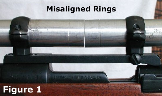

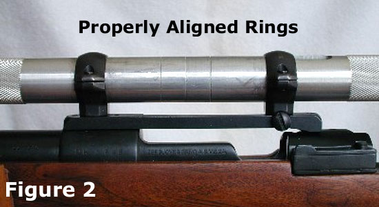

Not even Leupold two piece dual dovetail bases and rings? I used a ring alignment tool and (with my eyesight) got good alignment in the vertical plane but slightly off in the horizontal plane.
What kind of ring alignment tool? The ones with the pointy ends tell you very little.
Think about it. The two pointy ends could be coming perfectly at each other like a V.
Exactly. That's why it's a two step process. Getting the pointy ends as close as possible given the limitations of the machined surfaces (bases to rings & rings to tool) is only the first step. Then you lap the rings, i.e. additional 'machining' go get concentricity of the rings. I appreciate the feedback so please correct me if I'm missing something.
If you’re going to lap rings, this is the type of ring alignment tool you should have.
Kokopelli Scope Alignment Bars
https://www.kokopelliproducts.com/
I believe the owner either died or sold his business. When I talked to him years ago he sounded old as the hills then.
Someone might make a similar set. Search google for lapping ring alignment tool -wheeler
The Wheeler pointed “alignment” bars literally do almost nothing for you from a physics standpoint. Sure, they might show that the rings are wildly unaligned, but don’t show you much else.
Also, according to Kokopelli at least, you should have separate alignment bars and lapping bar. If you use an alignment bar as a lapping bar (or vice versa), you’re grinding a little off your alignment bar each time.
I’ve never done any of this, but just letting you know what I found when I dug into it.
