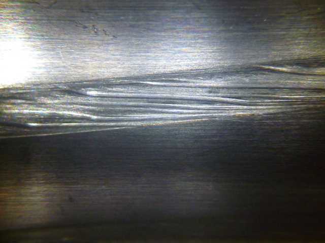

Not flaming at all but be very careful with using an abrasive cleaner!
Absolutely positively don't use a brush with any abrasive cleaner and I don't care if it's in a liquid form. Damage will result. Look at the attached pic.
That was done with a bronze brush and KG2.
I'm o.k. with JB bore compound but not the bore brite. Again no brush. Patch only.

is that picture showing how the abrasive and bore brush created groves in the rifling? Especially etching the inside of the bore.
Yep....the brush magnifies what the abrasive cleaner can do. The gouges to the lands is from the bristles of the brush with the abrasive on it. The brush/bristles are trying to rotate with the rifling twist but there is no way every bristles is going to follow the grooves only. So you can see how the gouges from the bristles are going up and over and down the lands.
The bore of that barrel is so shiny it looks chrome plated.
The shooter physically polished a full .002" out of the bore (tops of the lands) and a .0015" out of the grooves. The grooves don't show or take as much of the abuse vs. the lands. The lands stick up.
That barrel only has 800 rounds on it in that picture. Barrel started having accuracy issues at 100 rounds and that isn't the only one I seen like that.
Another guy using Witch's Brew and a brush wrecked 3 barrels in 6 months. The 6.5 barrel only had 110 rounds on it and the gouges where just starting to show. Another guy had a 308w barrel and at 500 rounds he polished a full .001" out of the bore.
