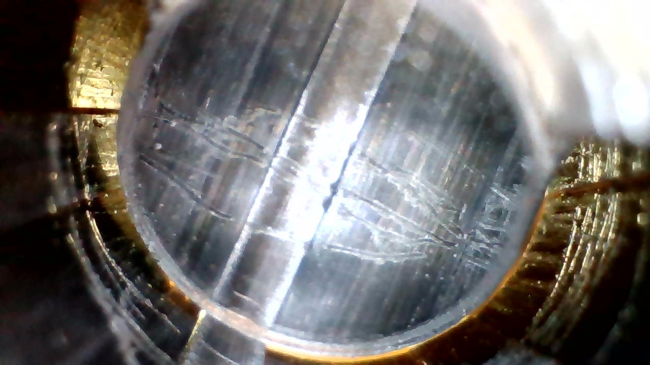

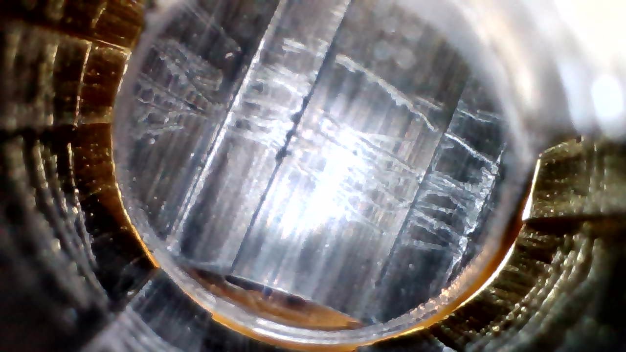

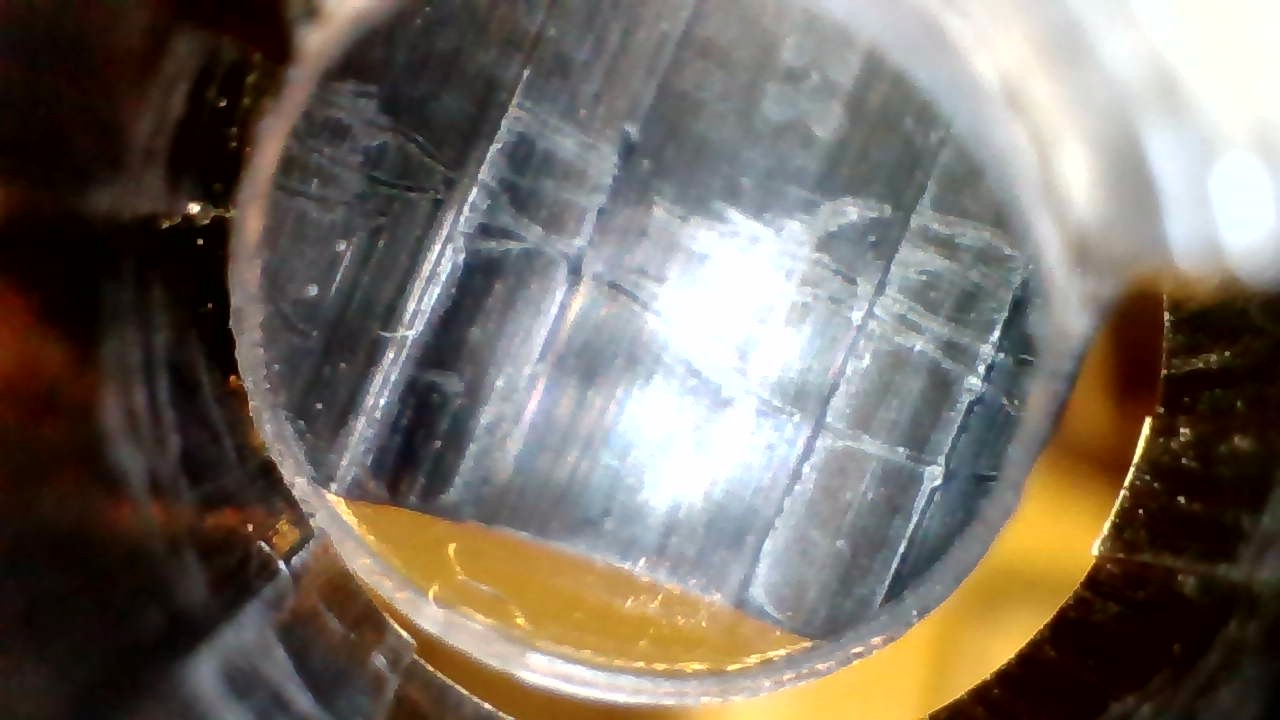

cleaning barrel found this - ideas?

New 6mm, only 30 rounds down the tube. After cleaning, ran a bore scope and found this at the very end of the barrel. Not from cleaning as patches and nylon brush won't make those kind of marks. If I had to guess, they are remnants from the manufacturing process as a tool left the end of the barrel. I used a plastic pick to see if I could feel any grooves, but no "felt" scratch/groove, but you sure as heck can see it. Anyone see those marks before? Curious minds want to know. Thanks in advance for any input.

Seems to be a picture missing. At least I’m not seeing one on my end.
I’m no machines by any means but I’d guess it’s from some kind of indicator during the lathe setup. Clearly looks like the barrel was spun against a tool or similar based on the gouges in the rifling
How’s it shoot 😁

I have seen those marks before , factory barrels mostly . It's what you think it is .
How's it shoot? After dialing in my zero, I was .50 MOA which I thought was plenty good after only 1 box of factory 108 eld. Just surprised to see what appeared to be tooling marks. Makes sense that a factory barrel would not have the attention to detail that a custom barrel would receive. Get what you pay for I guess.
.5 moa isn't bad. See how it does at longer ranges. Definitely some gouges in the rifling that could effect your bullet jacket just before it exits the barrel
It's amazing shitty a barrel can look but still hammer (not a reference to your barrel specifically, more of a general comment)
Did you specify if this is a factory barrel? I know there’s a reason on a custom barrel they recommend cutting an inch off each end.
…. Or, was it indicated then cut to length, then removed and replaced for some reason? Have threads cut on a finished barrel, etc.
Just making shit up here that makes sense in my head.
My theory: Tooling marks made by the button. Most likely caused by metal shavings piled up around the button. Then the bore was subsequently lapped which smoothed the marks down. Gently use a dental pick and I bet you can feel those scratches. Since accuracy is not affected, mostly a non-issue. If the lapping stage is part of the manufacturing process, I bet the manufacturers never even noticed the scratches. They just plug gaged the ends, air gaged the center of the bore, ran a pin down the bore to check for straightness, and then wrapped it up and shipped it out the door.
If I seen that on a part I machined I would say poor material. Is it a forged barrel ?? almost looks like bad forging, too cold to weld itself together.
Too random for me to say tool marks.

Yes, this is a factory barrel. You are right that if I cut an 1" off then end that alleviates any potential issue. I figure to shoot to about 60 rounds then start on some longer distances and see if I can maintain consistent tight groups. Then decide if I need to address the issue further.
From the manufacturer: "A carbide rifling button is drawn through the barrel to produce the rifling grooves at the appropriate twist rate for each caliber. This produces a groove diameter deviation of less than 2/10,000 (or .0002”) of an inch. It’s the same result that many gunsmiths accomplish by hand lapping."
When I see marks like that on the parts I machine, I check my coolant lines and resharpen or replace the tool in question. FYI - 6mm is not a standard "COLD" hammer forged caliber. Lothar-Walther doesn't even offer a hammer forged barrel in that caliber. There's not a whole lot that could cause those marks. Maybe the drill for the bore went bad at the end of it's cut, got replaced and the new drill used to clean up the bore leaving some scratches behind, but that doesn't explain why the scratches are consistent in size between the lands and grooves. Another possibility involves the op got his cleaning rod stuck trying to reverse the stroke and had to hammer the rod out or chucked his cleaning rod in a drill. One last possibility is the bore was hand lapped and the person doing the lapping was careless in his process.
Lol, the purpose of hand lapping is to smooth out tooling marks and improve the surface finish inside the bore. For my original theory that would mean the marks were made within the first couple passes of the button, then cleaned up some in the final passes. So, person making the barrel caught the issue, fixed the tooling issue, and then didn't thoroughly inspect the barrel afterwards, or he did but said fuck it and sent it anyway. I guess we can eliminate any issues with barrel lapping since they don't lap their barrels. Judging by the pics, maybe they should reconsider. A good finish is not what the buttoning process is known for.

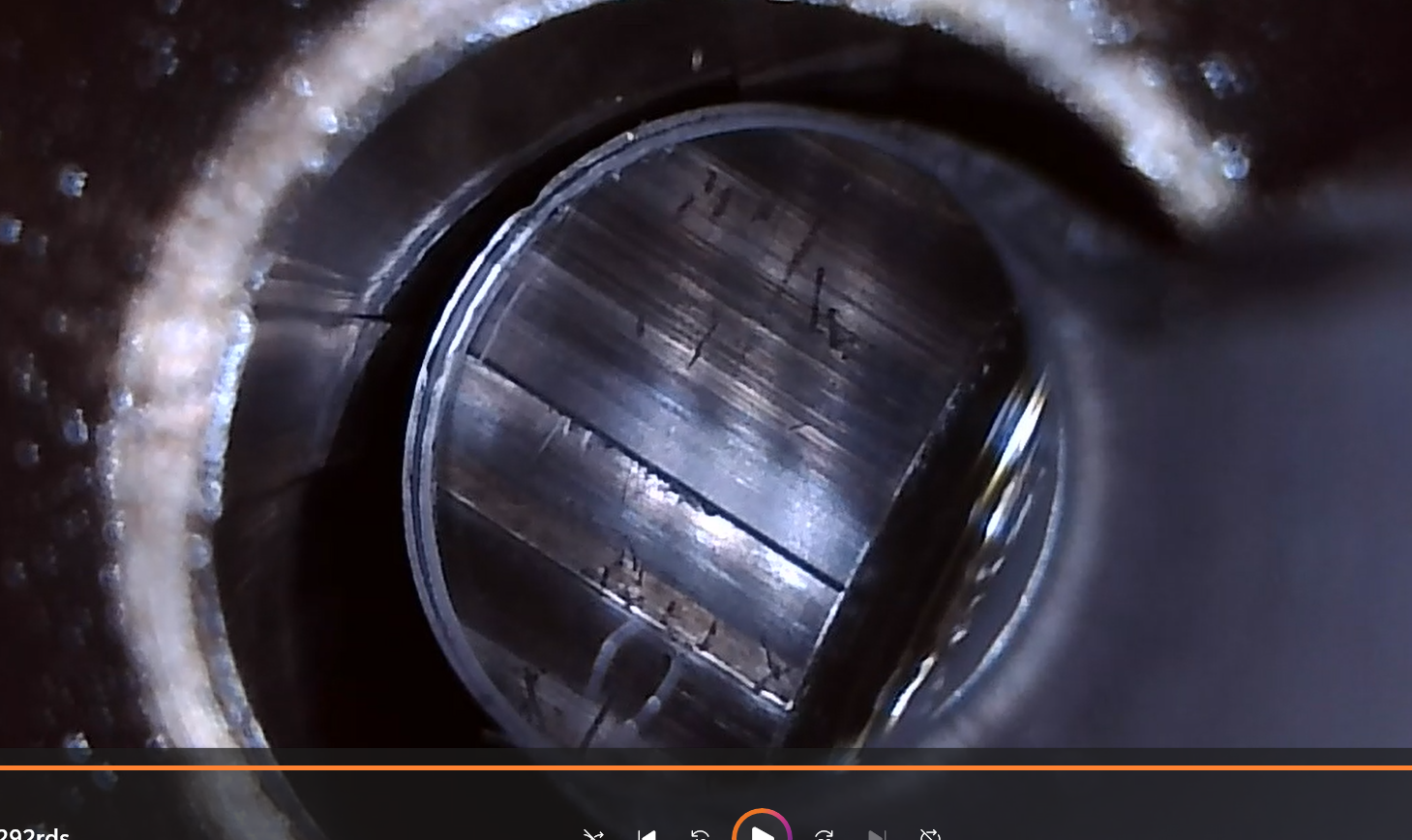

I have similar marks in a Hawk Hill barrel I got in November of last year.
Not as bad as yours. But similar looking, just inside the muzzle.
Are you spinning the borescope after entering through the muzzle?
My barrel is a 223, so there is not much wiggle room with the teslong, and I got it wedged on my first scoping, spinning it around to look all over. (I'm much better with it now, but do assume I caused damage).
Either I scratched my barrel with the borescope, or it was there from the gunsmith.
350rnds in and it is still there, not wearing down much.
The "How's it shoot" thing really doesn't matter.
I'm an amateur getting ~.8MOA with factory ammo, but could/should that barrel be doing .5MOA?
Attached some crappy snippets from a borescope video last week. This damage is right inside the muzzle.
My barrel is a 223, so there is not much wiggle room with the teslong, and I got it wedged on my first scoping, spinning it around to look all over. (I'm much better with it now, but do worry I caused damage).
I'm an amateur getting ~.8MOA, but could/should that barrel be doing .5MOA?

My money would be on long stringy chips got pushed into the bore on the machining op for the muzzle. It’s too inconsistent to be tool marks, and it marked up both the lands and grooves.
A factory rifle, I’d rate it a solid meh. I wouldn’t want to see that in a match barrel you paid good money for, likely waited a long time to get, and paid good money to get it chambered/crowned.
I've seen those exact marks before near the muzzle and I know exactly what caused the ones I saw. I parted off the end of a new barrel blank to thread the muzzle. The parting off left a nasty bur that interfered with my dial test indicator. I stuck a deburring tool in the end and gave it a few twists.
I left nasty scratches on the rifling by accident with the tip of the deburring tool that looked like the scratches in the picture. Not fun.

OP's pictures and the longer I continue to see no new marks in my barrel, the more I believe it was marred from machining.
