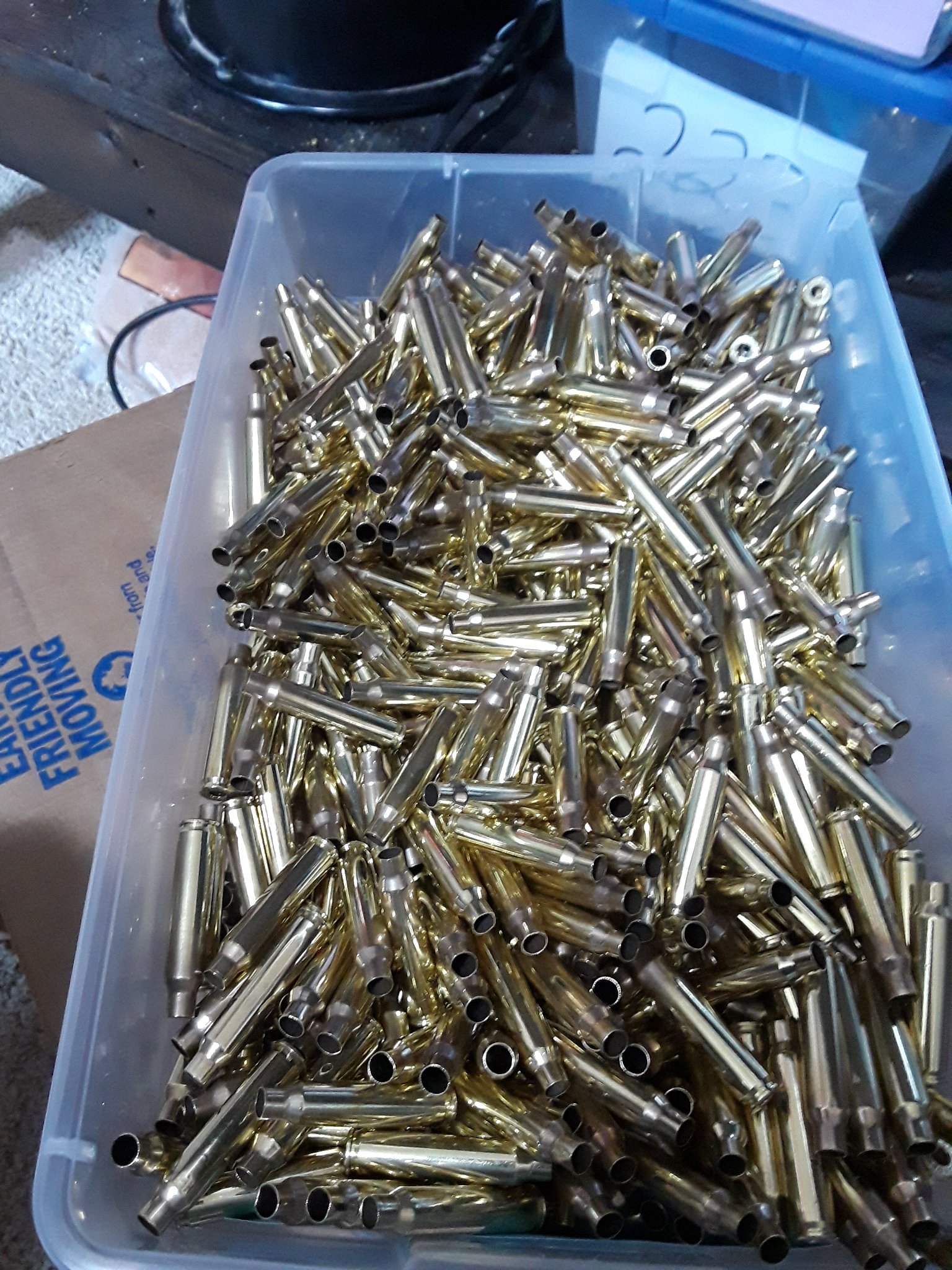

Big fan of universal decap and tumble clean first with nufinish and mineral spirits.
Everything runs slick then , no stuck brass since and opportunity to see defects before sizing.
Several thousand rounds of cleaner than average range brass done that way with no stuck brass in a cheap Lee die set.
