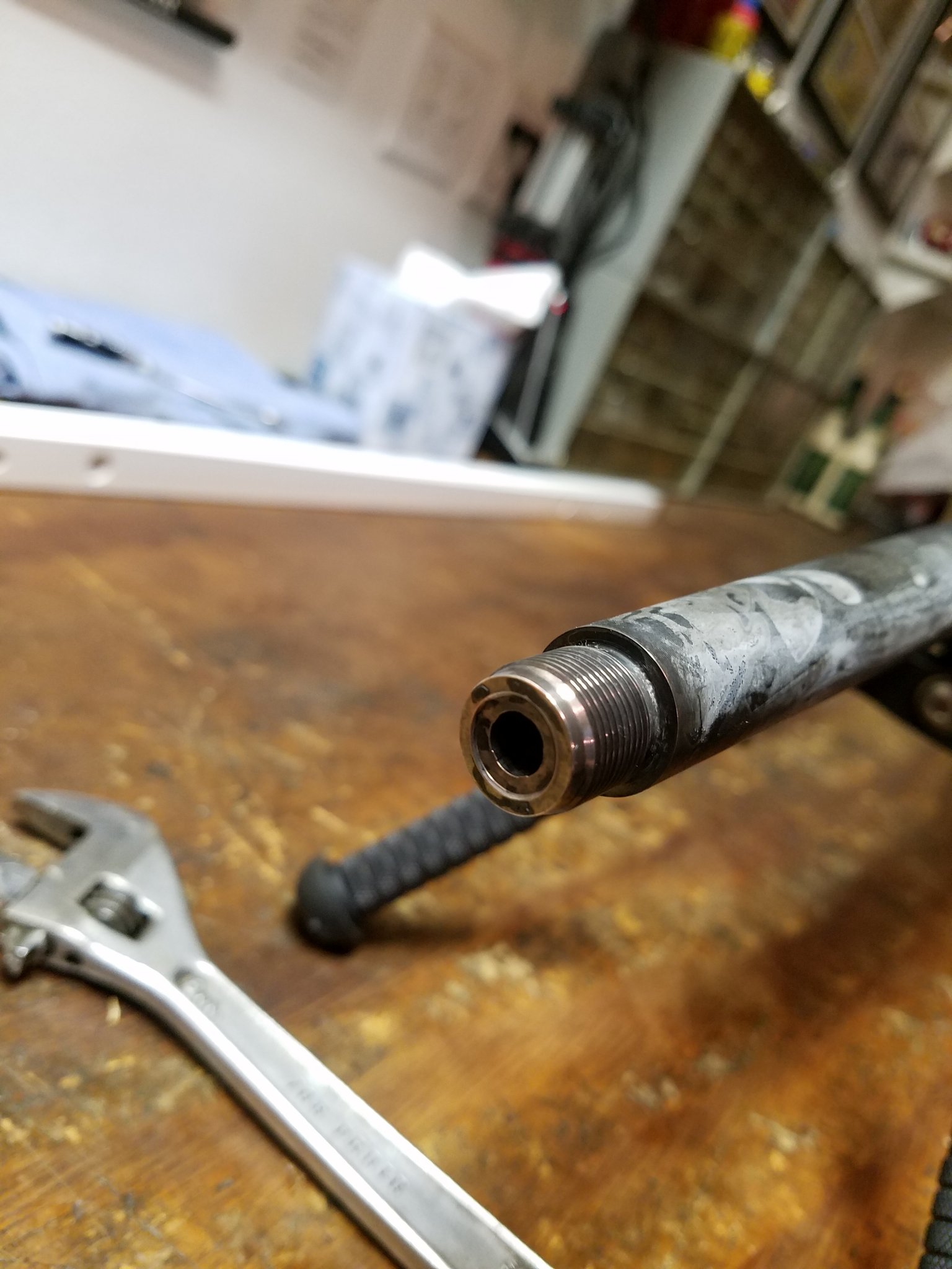

    I believe this is my first post on this forum. Or any for that matter. Professionally I am a blacksmith. When I noticed that you had mentioned the ferric chloride turns the brake a darker color that is because it is an acid. We use it in the fridge to etch damascus knives. If I may I would recommend using windex after the ferric chloride. The ammonia in the windex will neutralize the acid. If it will soal for awhile I would check at least every 30 minutes and pull the brake out and spray or soak in windex wipe off then put back in the acid. That should prevent the color change. Also that color change is only on the surface. It can be removed.
    I might just live with it. It’s not affecting accuracy or anything so far but I suspect that with enough build up that it might. On the other hand my 6 creed will probably need a new barrel by the time there is enough gunk to affect accuracy so it really won’t matter I don’t suppose.

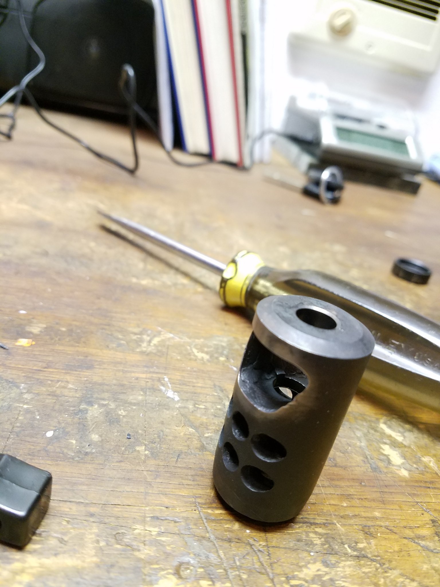

    All mine are nitrided, I spray mine with carb cleaner a few times and let the stuff soak into the caked on carbon.
    Then it goes into ultrasonic cleaner for 5-7min with a hot dilution of simple green extreme aircraft cleaner and water.
    Anything left flakes off quickly with a pass of a nylon brush and/or compressed air, barrel crown and threads get cleaned with nylon brush as well.
    Then a thin bit of anti seize on the muzzle and jam nut threads, and a thin coat of CLP on the brake to soak into the finish.
    I clean brakes only when barrels are cleaned, about every 500ish rounds, and then less than a dozen rounds to foul and re-establish zero.

    Lemishine will also eat through a nitride finish. I soaked my APA LB in a cup of hot water mixed with a tablespoon of Lemishine. It came out clean AF but also in bare metal!!!
