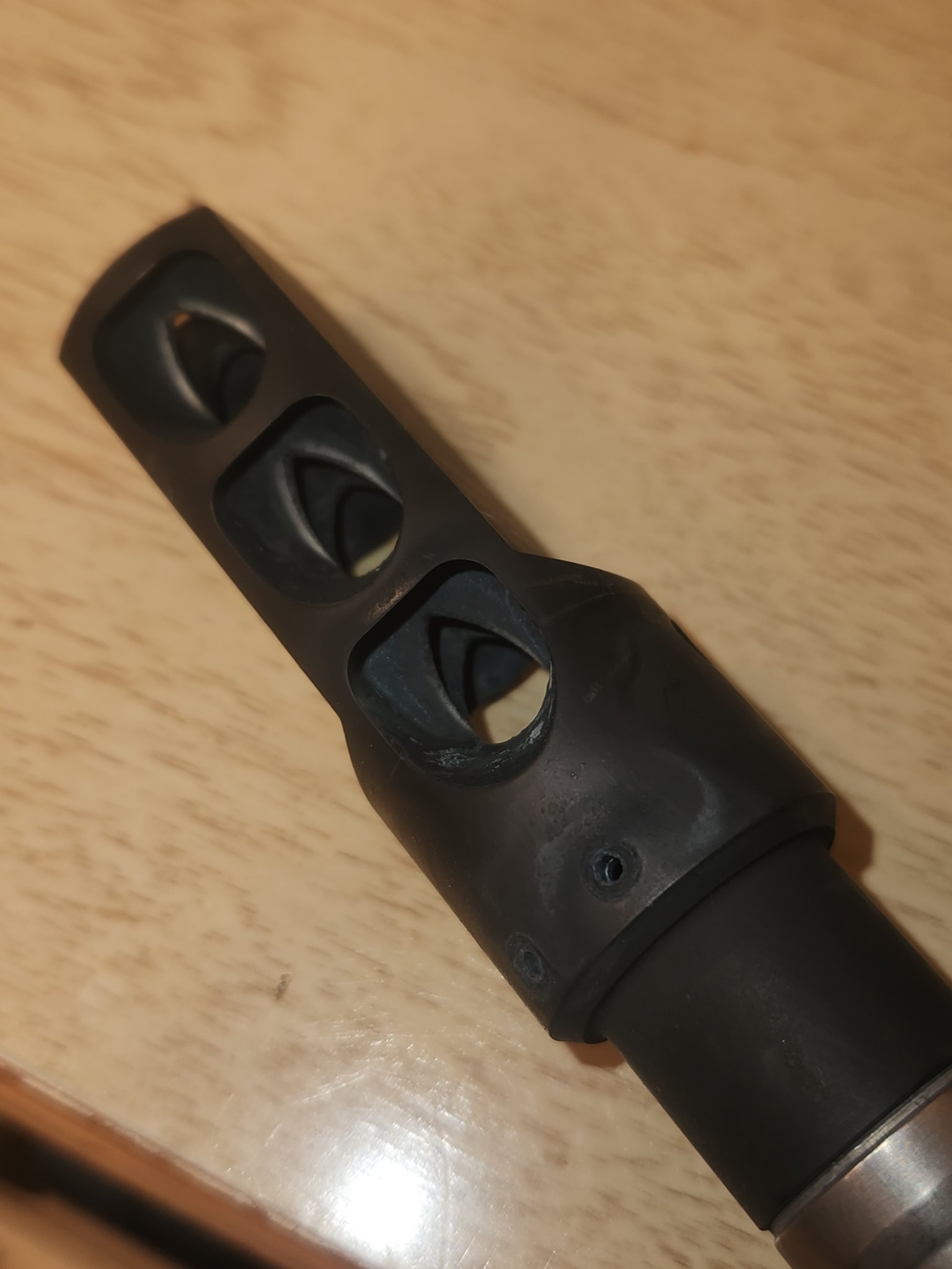

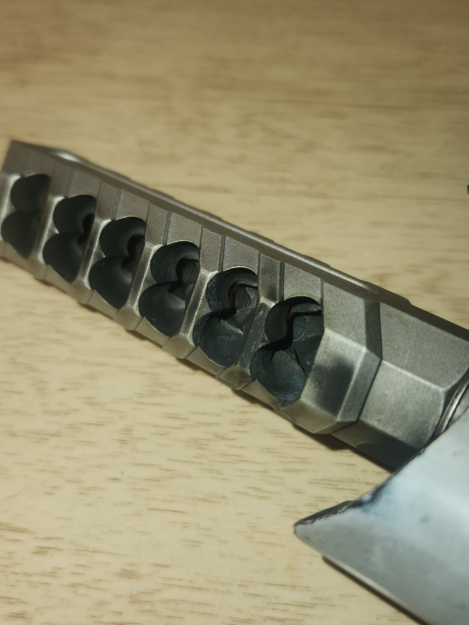

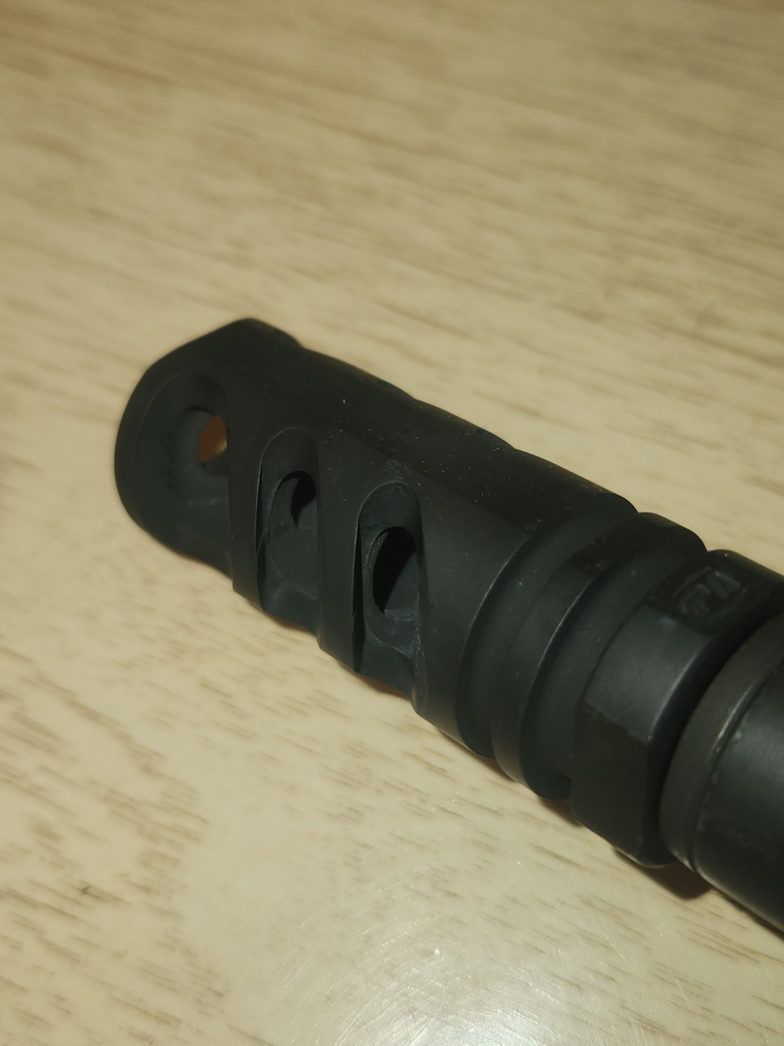

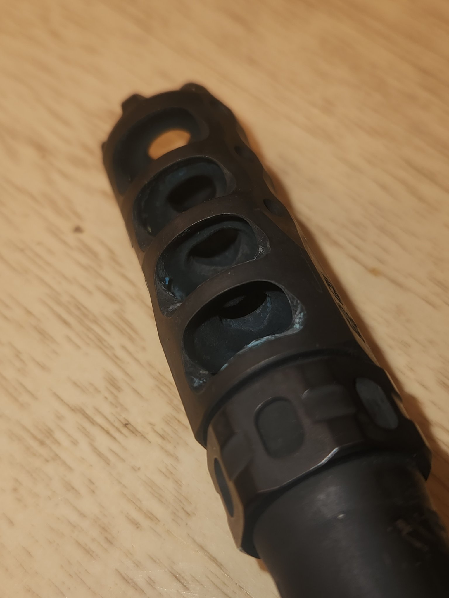

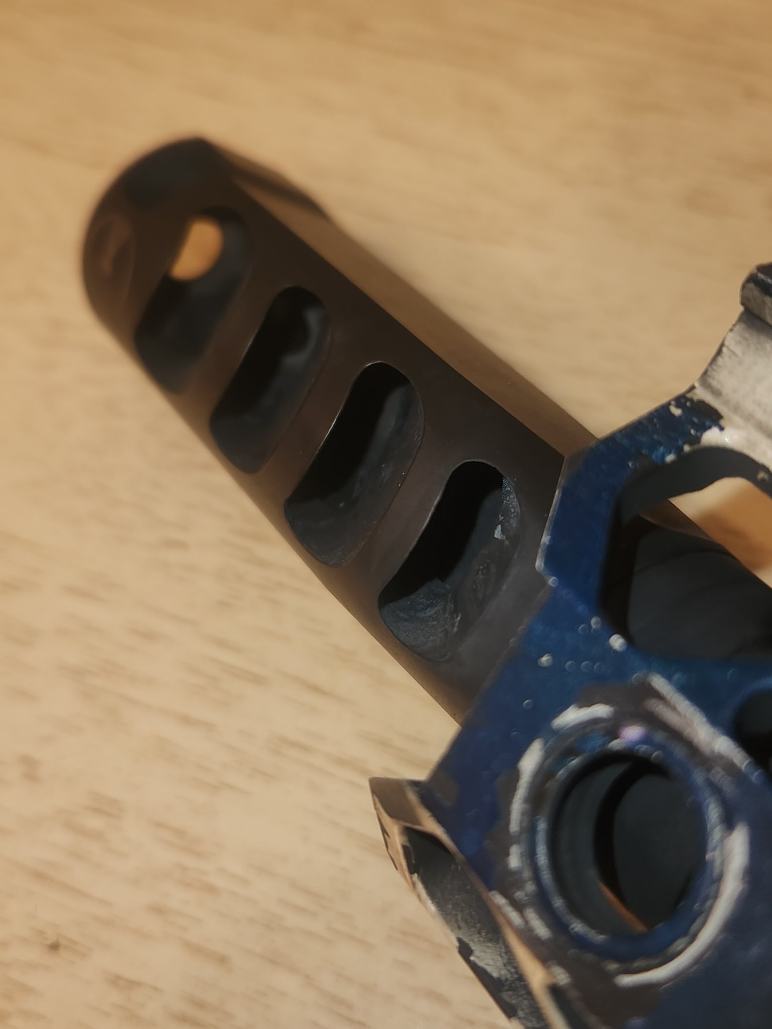

Small caveat to my first post. I have cleaned the comp on my 9mm PCC. But never on a centerfire rifle firing a rifle round.
Just to make a point, I'll include pictures in my post. Here are the first 5 brakes in my stack of rifles with brakes. You guys must just be using different powder or something. The first one has over 20k on it with no cleaning. If you think you see buildup look again, it's erosion. The next 4 have 3-10k on them with no cleaning. So when I say I've never cleaned a brake, it's because there is almost nothing to clean. If my rifles had buildup the way my PCC does I would clean it.
I'm sure a certain someone will deny the possibility of this, but whatever.

The experience I mentioned with muzzle break cleaning was specific to centerfire bolt guns. These all look like gas guns. If that is the case, it may account for the different experience.
It may, but I can't really see why the action at the other end of the barrel would effect buildup at the opposite end. That said, I have a couple bolt guns with brakes that aren't pictured, they look the same. I use the same powders in both bolt and gas guns, mostly 8208, TAC, CFE223, Leverevolution and AA2200. I'm guessing that's the difference we're seeing in this thread between people that have to clean or else it effects POI and the people that have nothing to clean.
Yes, I'd imagine powder and cartridge make a difference. A gas gun redirecting a good amount of gas/carbon back into the action via the gas port (vs 100% out the muzzle on a bolt gun) would also make a difference. I get significantly less carbon build up from a 223 gas gun than a 6mm bolt gun.
I thought about the carbon redirection too, but I don't really get much in the action either. I do have a 6mm Grendel gas gun that carbons up the upper receiver way worse than the 5.56's, but the brake is still clean. All my bolt guns with brakes are in 5.56, so maybe it's just a pressure/velocity thing that blasts the baffle surface better?
You've vastly overestimated the amount of gas that comes into the action through the gas port. It doesn't make any significant difference as far as a muzzle brake is concerned.
What DOES make a difference is people not knowing how to mount brakes straight, so the baffle clearance is marginal and any little bit of fouling being enough to cause an issue. If that happens, you've probably either got a very poorly aligned brake (like mounted with a crush washer or something) or something else going wrong.
Fouling in all of my centerfire rifle brakes looks pretty much just like the pics Tony posted above, which as I said before ends up being the same whether there are 10 rounds through it or 10K, IF it's not suppressed. Can you get that fouling out of a brake? Yes, but so what, it'll be right back after firing the first few rounds again. It's like polishing your oil pan every time you drive your car.
Yeah IDK. I am guessing port geometry probably matters too, but fluid dynamics is really outside my area of expertise. I guess I'd just rather spend 2 minutes to clean it than found out how long it takes to have an issue.
