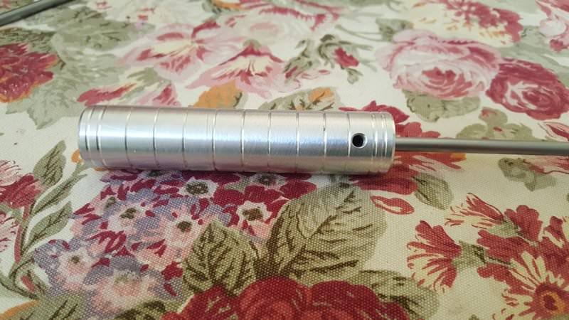

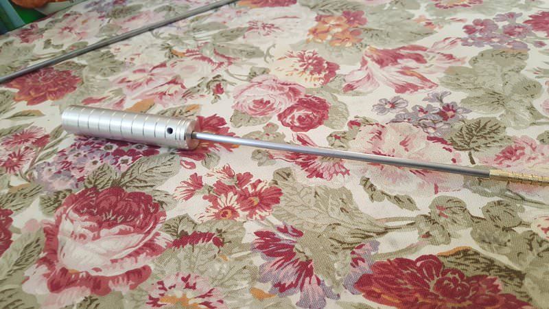

i make my own cleaning rods.
turned aluminum handle with replaceable shafts made from stainless steel and theyre threaded for standard 8-32 jags.....and i can swap the rods out for rifle or pistol length........got tired of breaking cheaper rods.
Do those bad boys rotate to follow the rifling?
No they dont.......mainly because ive never found "rotating rods" to really be all that useful......and thats partially because i am not that anal about cleaning......in fact i very rarely actually clean a significant amount of copper out of my barrels.
but i use them mainly for muzzleloaders and shotguns, which i clean after every outting.
bur it wouldnt be tgat hard to make them rotate....just need to drill out the handle to accomodate a few bearings
