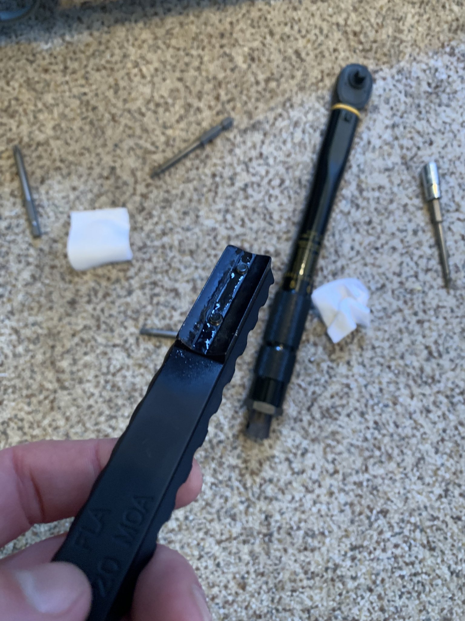

My groups are walking around. Trying to eliminate the variables. Also found that my usual 18 inch/lbs of torque for the bases is low. Should be 32 in/lbs per the rifle manufacturer. Could see either of those causing problems with a higher-recoil gun.
So, when I took the things apart, there was tons of wipe-out under the base. Guess it migrated up through the screw holes. Will putting loctite on the threads avoid this?

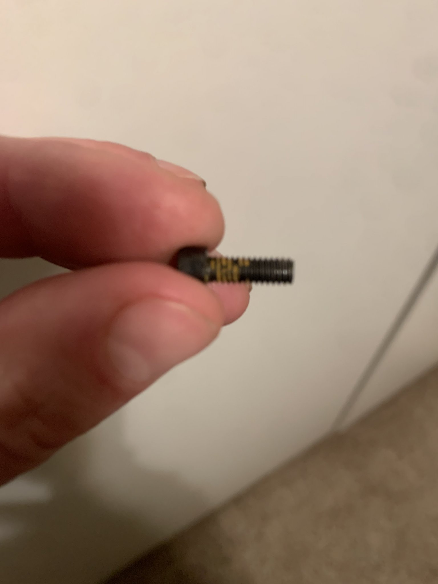

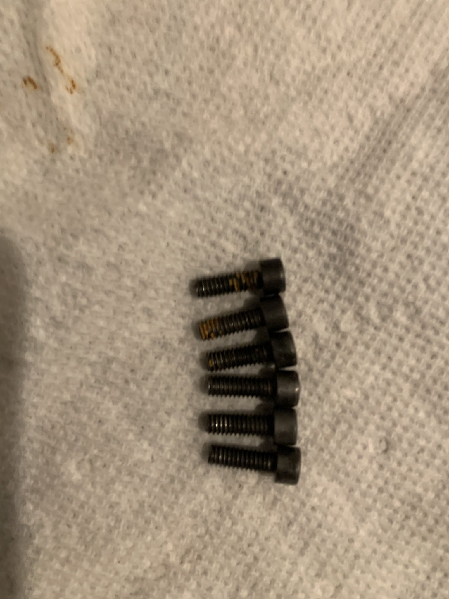

Gave this a try. I did get a little rust on the screws. Guessing that won’t hurt their function, though.
Gave this a try. I did get a little rust on the screws. Guessing that won’t hurt their function, though. View attachment 8346272View attachment 8346273
Ugh. Now you need to clean that rust off. Try some WD40 or CLP with a brass bristle brush. Afterwards, label the brush so you don’t use it on anything steel, as you might get rust on that.
Then for other cleaning, seriously, acetone. For example, fill a little glass bowl, throw screws in there, grab screwhead with small pliers and rub screws with q-tips or use paper towels. A little acetone isn’t going to kill you, otherwise women would be all dead from removing nail polish. Which is acetone.

So, when I took the things apart, there was tons of wipe-out under the base. Guess it migrated up through the screw holes. Will putting loctite on the threads avoid this?View attachment 8346114

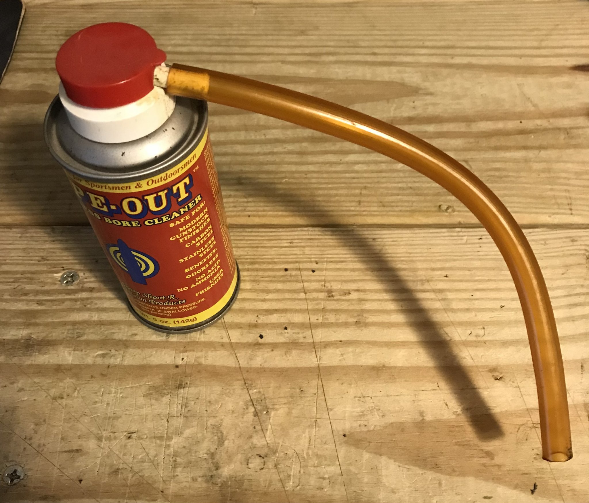

How in the hell are you getting Wipe Out up in the scope base????? You really have to try to do that. You are doing something wrong in your cleaning regime. Are you using a small tube to put into the chamber and spray the Wipe Out down the bore? I am guessing not and you need to. You can find a small piece at most places like Lowes or Home Depot. Push it in the chamber and hold it in there while spraying and watching the foam come out the muzzle and then wait another few seconds so it doesn't expand back into the action from the chamber. Rifle should be on a slight downward angle so everything runs out the bore when cleaning.
As to your question, just take some 91% alcohol and wipe down the inside mating surface of the rings to take out that little bit of oil and you are done. No need to give them a bath or some crazy cleaning. Do the same to clean the oils off your ring screws also. Simple process.
Noted. I do use a hose, but I’ve been intentionally letting it foam into the chamber a bit to get the chamber clean as well. With the magazine out there’s a good 4 inch gap the foam would need to cross before there’s a risk of getting stuff in your trigger.
Sounds like I’ll stop letting it foam into the chamber. Regardless, I don’t like the idea that things can migrate up through those holes. One can disassemble and clean most parts of a rifle, and should if you hunt in the rain a fair bit. I wasn’t planning to take my scope off and clean under it every season though. Would rather make it so stuff can’t get under there. Hopefully loctite will seal them up. I’m not hearing any other suggestions.
