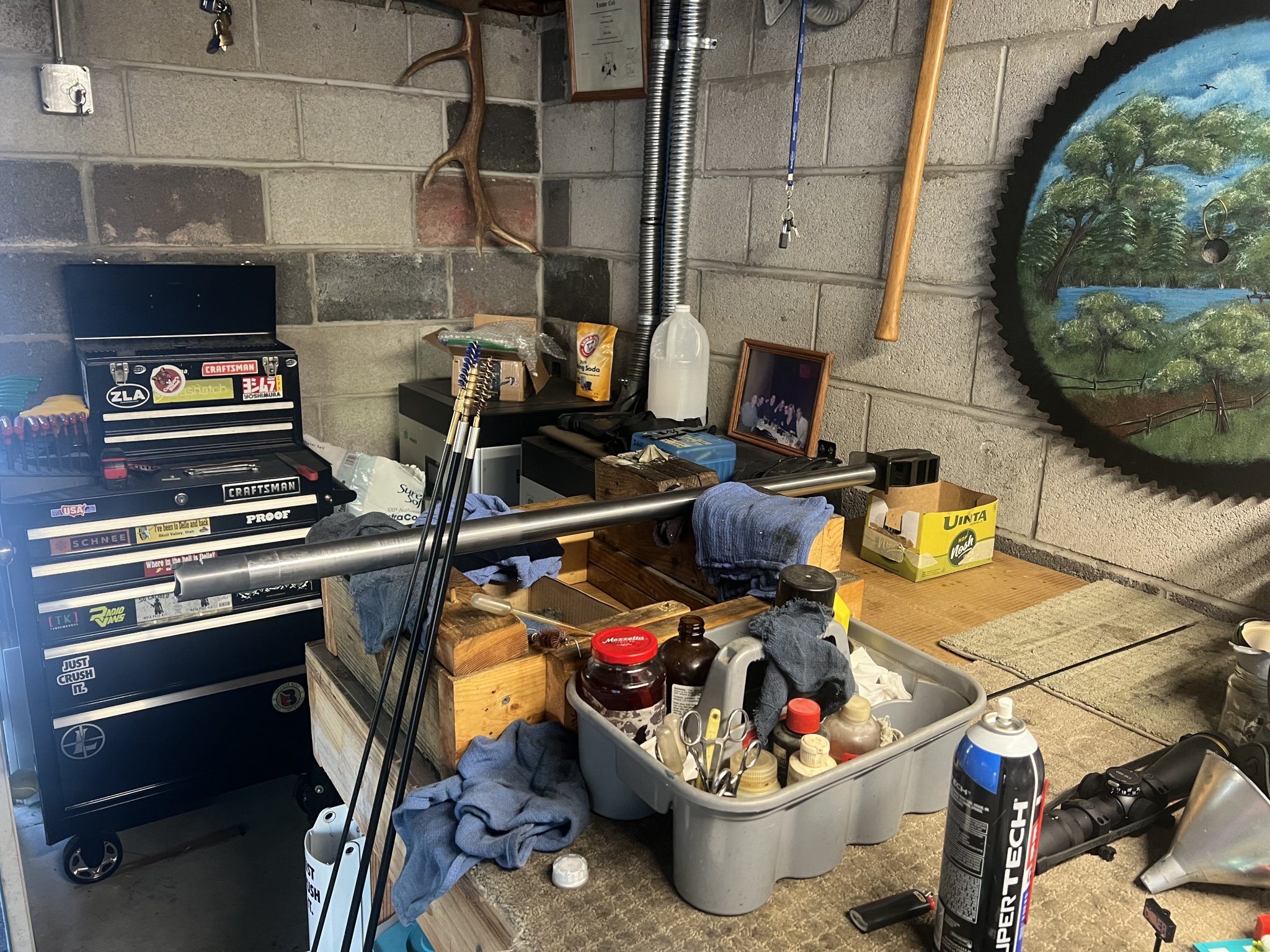

    I use Montana extreme copper killer. High ammonia content. Eats copper and brass fast. I don't use a jag, I simply buy those stainless steel 50 cal brushes, and I wrap a 3" shotgun cleaning patch around the brush. My cleaning rod is simply a 3/8 stainless steel rod, I drill and tap a 8-32 hole in each end, a couple of 3/8 shaft lock collars and about a 5" long piece of derlin drilled through for a handle on the cleaning rod.... Now when I make them, I put a 8-32 thread in each end. That way if you break a brush thread off, the other end will work too, a backup plan. A stainless rod and brush give no false indication of bore fowling, they don't color the patch like a brass or copper brush or jag will. They're also great for bashing cases loose when needed. Good old printing press 28% ammonium hydroxide can be bought by the gallon, that's a sure way to clean bores and sinuses too.

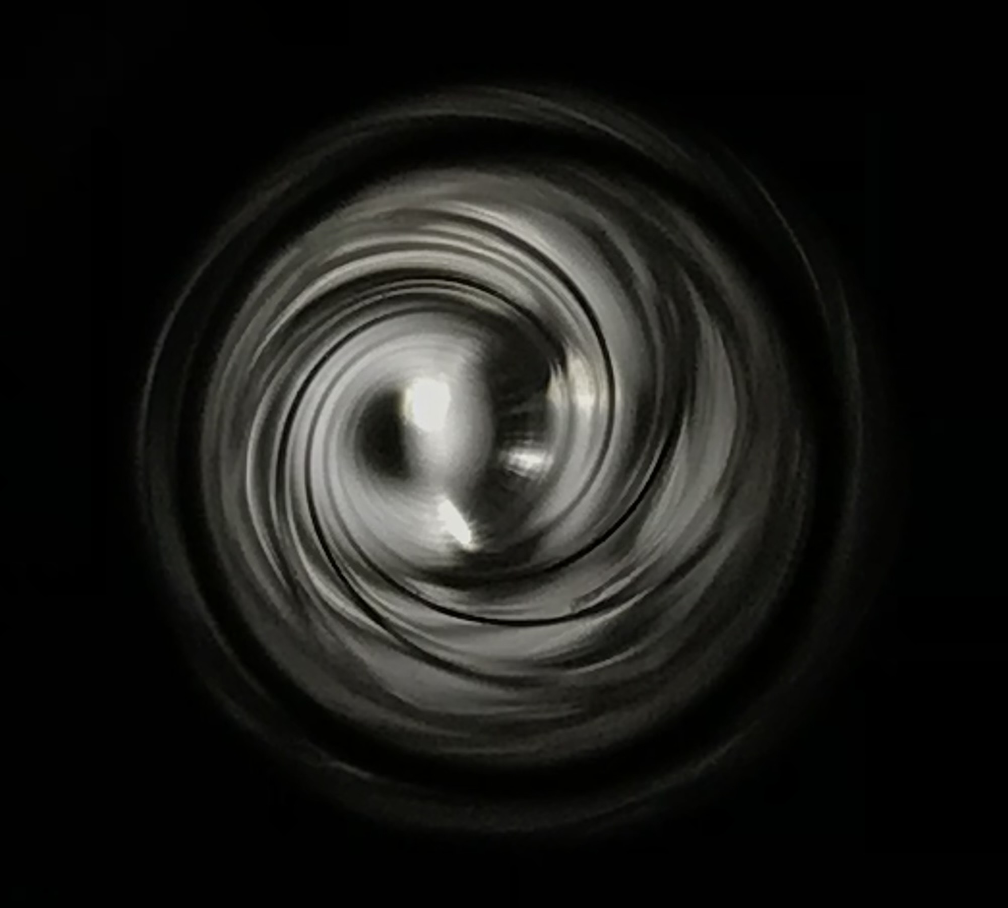

    For patches, get the 2-1/4" (+/- 1/4") Butch's Triple Twill, there is no substitute.
    For Bronze brush passes, I use Ed's Red that I make in 1-gallon batches every couple of years. I then patch it out.
    Then for Butch's Bore Shine or Sweet's 7.62 passes or anything with Cu solvent in it, I use a nylon brush, then patch it out.
    I then alternate Ed's red, patch out, BBS, patch out until the patches come out clean. With my Lilja barrel, I don't often if ever have to use strong Cu solvents or JB paste or anything like that.
    I hate changing rod tips, which is Why I have 3 different rods (jag, nylon, bronze). Makes cleaning less annoying.
    I know there's a contingent of 50-cal shooters who use SS brushes, but 50 steel barrels are same as smaller caliber, and nobody is using SS brushes on their 6.5 so I stay away from that.
    Here's what it looks like clean:
