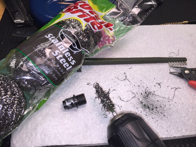

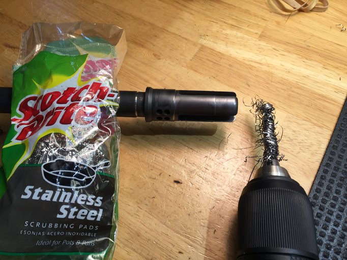

I use Choy Boys, particularly the stainless type. Get an old brass bore brush to wind some choy boy onto it for a few layers; use a portable hand drill to slowly wind some scrubbing pad material on to the brass brush, use wire cutters to liberate the strands. It works great for muzzle devices and suppressor adapters (inside and out). It will have them clean in 60 seconds. The brass brush will hold the strands securely whereas a nylon bore brush will not. Also when cleaning the bore of a muzzle device (not a suppressor) use a proper size tool, usually an open wrench, to hold the device to keep it from spinning and it also gets surprisingly hot quickly !
