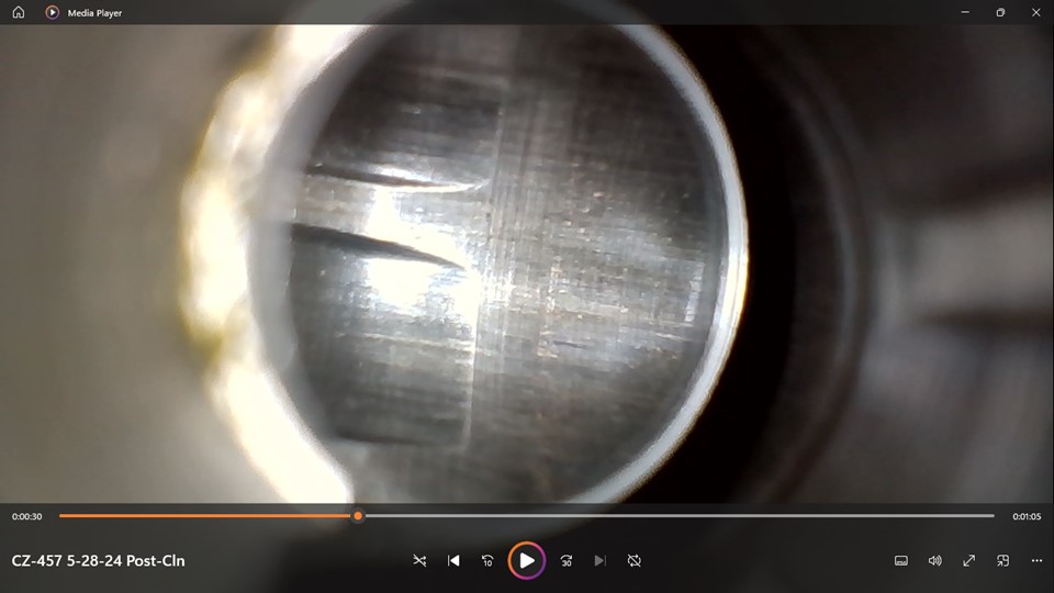

How does the rest of the bore look ? Is it staying clean, too? I find your pic is 'pretty Bright', hard to make out details. Maybe the lights can go down a bit ? Here's my VMTR with about 2K rounds last Sept.

Yeah, the picture leaves a lot to be desired…
The rest of the bore looks real good. Only have about 100rnds on it.

hangunnr - Yes, one can get carried away with 'concerns' of stuff found with the borescope. However, you can develop a baseline for cleaning. ie, I need to at least soak a patch with C4 into the chamber after 100-150 rounds to remove the beginnings of a Carbon Ring. Otherwise groups will open up beyond 0.75" with my VMTR. Less Fussy rifles can go longer if the chambers are less 'precise'. And I always thoroughly clean chamber and bore after each range trip, so I start 'new' each trip. I try for MOA accuracy and at 50 yds often get it. At 100 I'm only in the 'sub-1.5" range'. Consistency is a goal.
