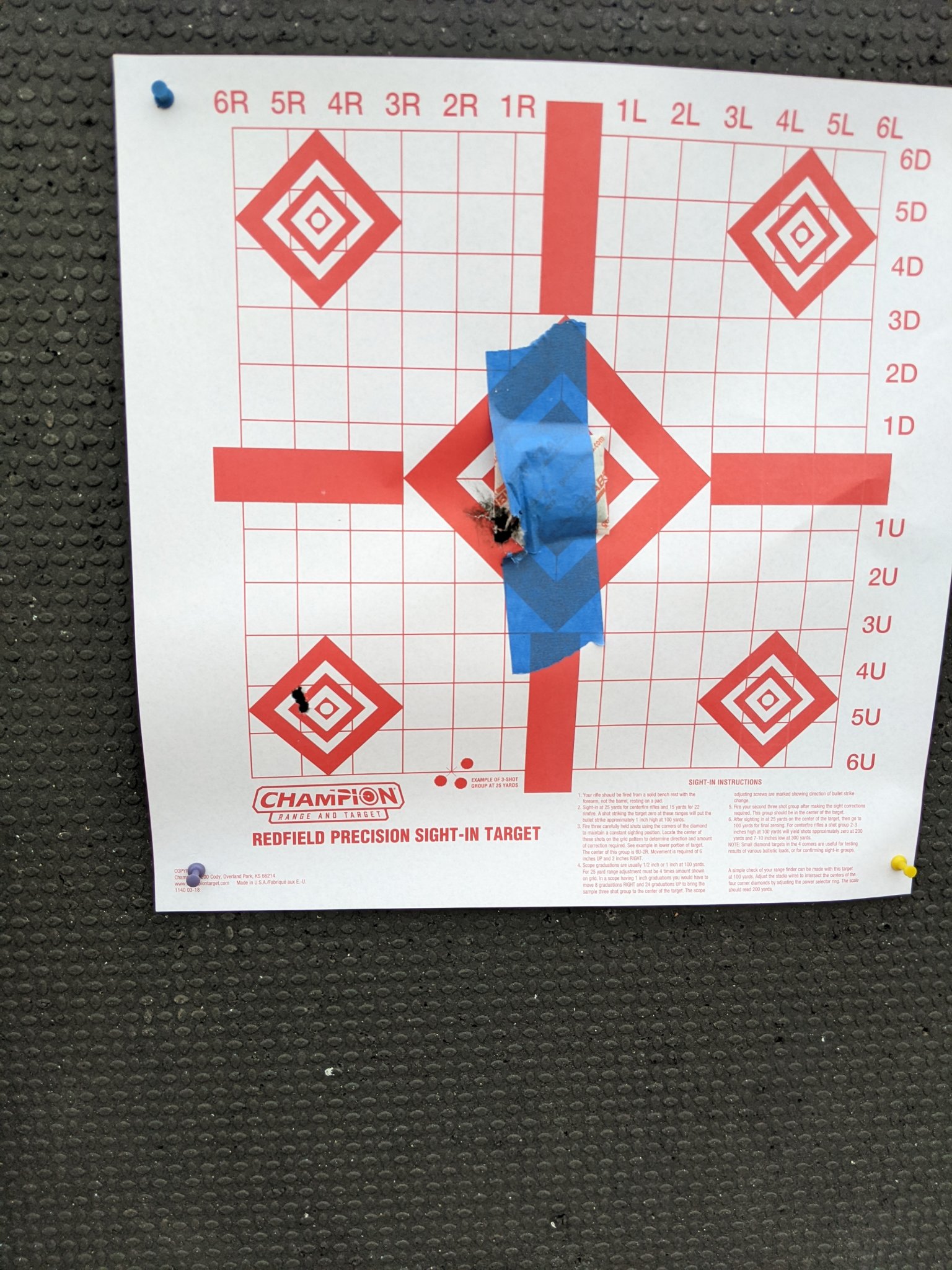

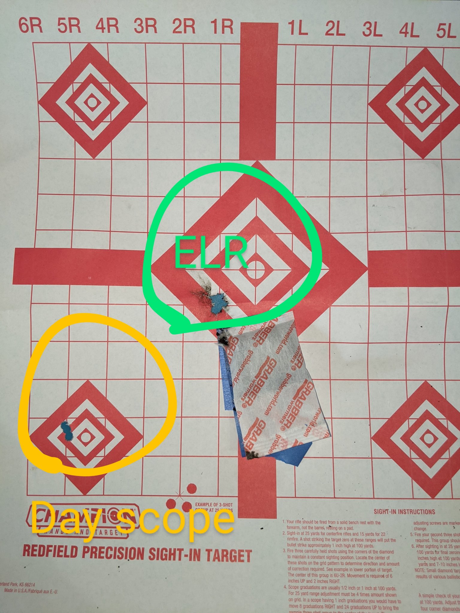

    When I lock my rifle down and introduce the thermal, it raises the crosshairs about an inch on the target, which is roughly equal to to amount of the offset between the front and rear lenses. My grouping with the thermal on is about an inch low, which would reflect that. My theory is that it is a PARALLEL offset from the line of sight and remains 1" from 100yds to infinity, based on the limited shooting I've done. I also believe that if you were to re-zero your rifle with the thermal on, you would then need to adjust the bore-height in your ballistic calculator to match up with the thermals front lens. Just my wild ass theory.
    For what it's worth, I can leave the thermals clamp loose and wobble it to the extremes of travel and the image doesn't move appreciably under the crosshairs.
    Regardless, I can deal with any minor boresight errors as long as they are consistent.

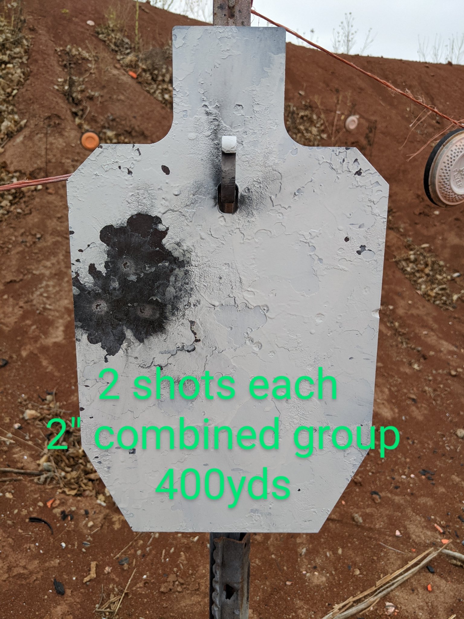

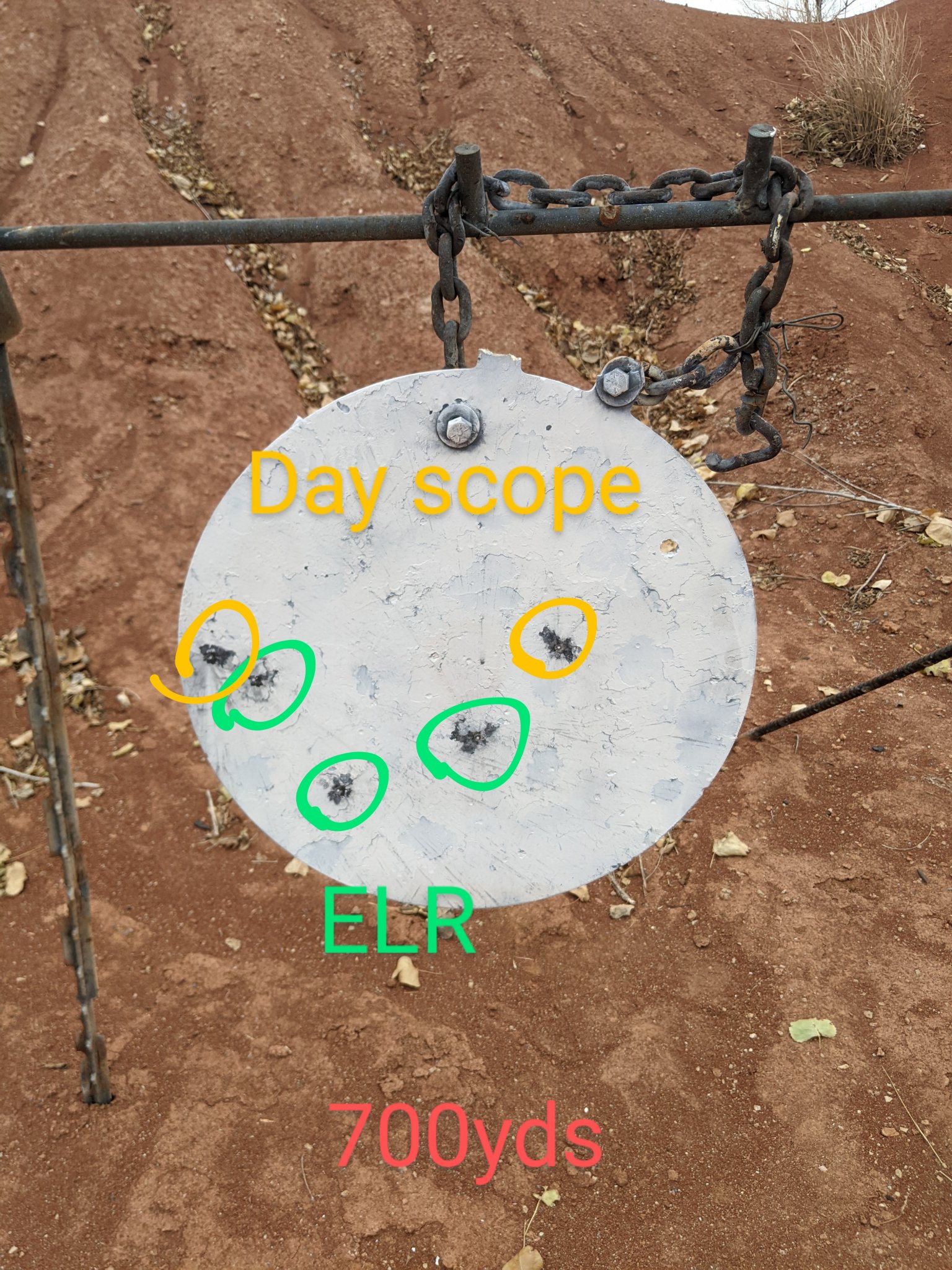

    Was able to spend some more time at the range this morning. First thing I did was check my 100yd zero and chronograph. I adjusted my Kestrel by 30fps. That fixed my previous dope issue at 700yds.
    Then I shot back to back groups at 100, 400, and 700 yds each.
    I still need to tweak my 400yd dope, but I'm pretty happy with the minimal shift I'm seeing with the thermal.
    My 100yd group clipped the lower left corner of the hothands. So almost exactly 1" low from my zero. Nearly identical to the previous time.
    The shots at 400yds landed so close it was impossible for my spotter to tell which ones were which.
    These are 64gn TGK's running 3720fps from a 22creed. Not really ideal for a 700yd shot, but most of these impacts would have resulted in a dead coyote.
