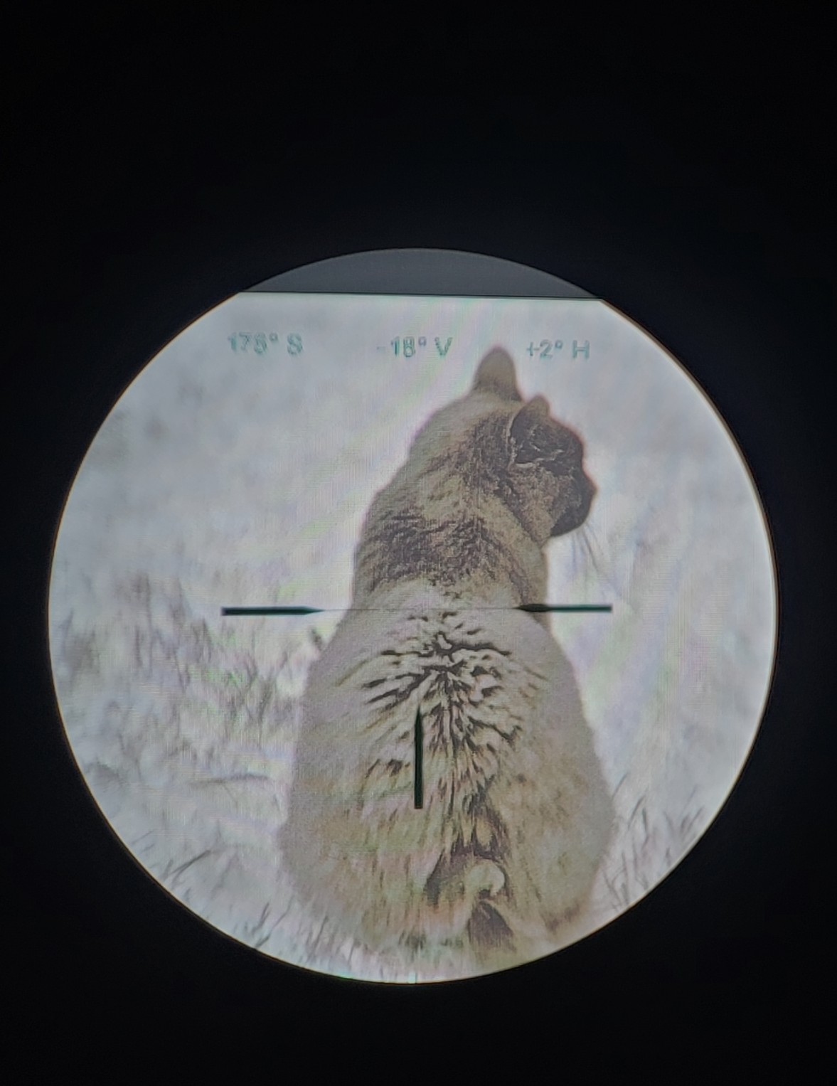

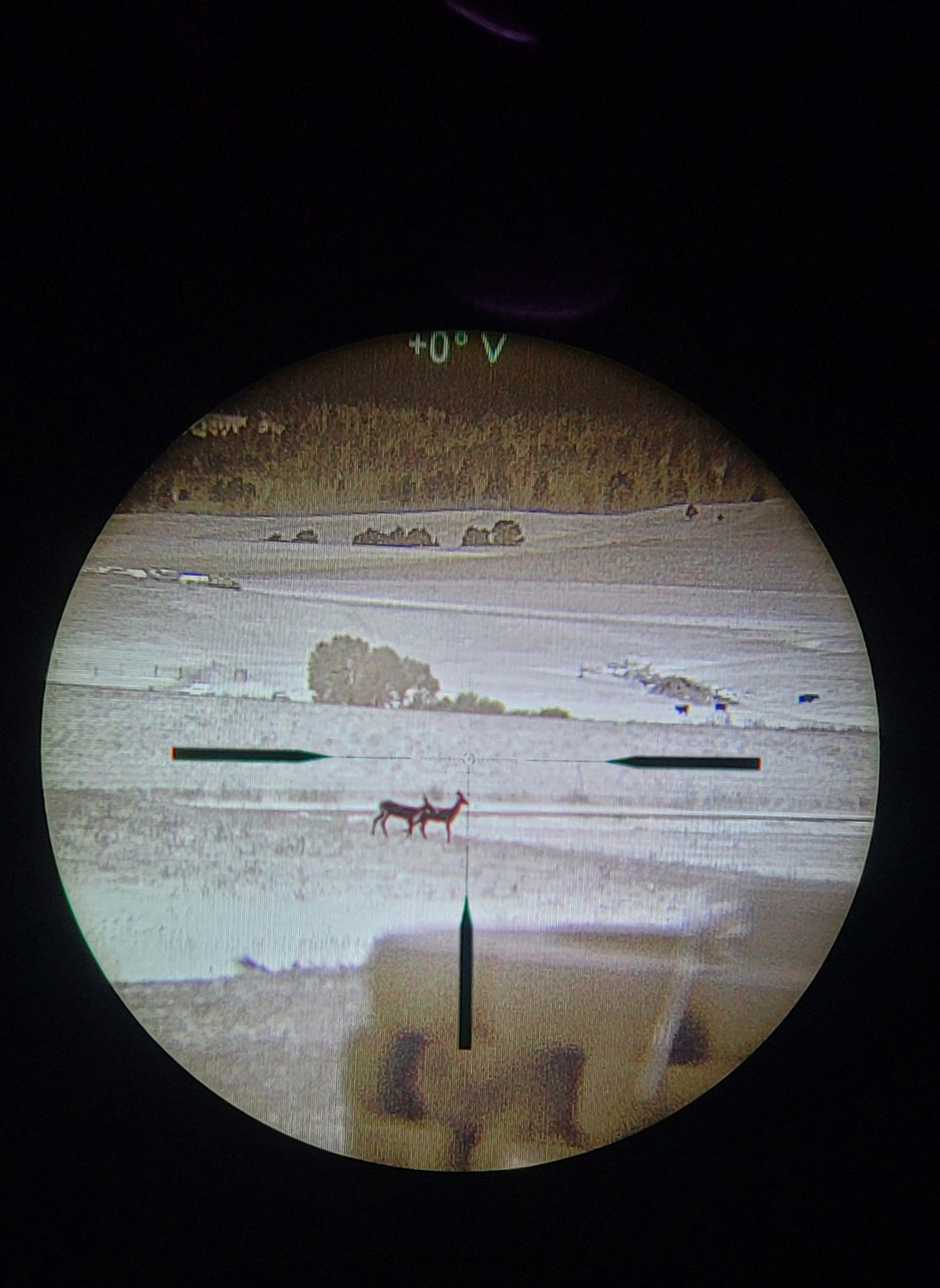

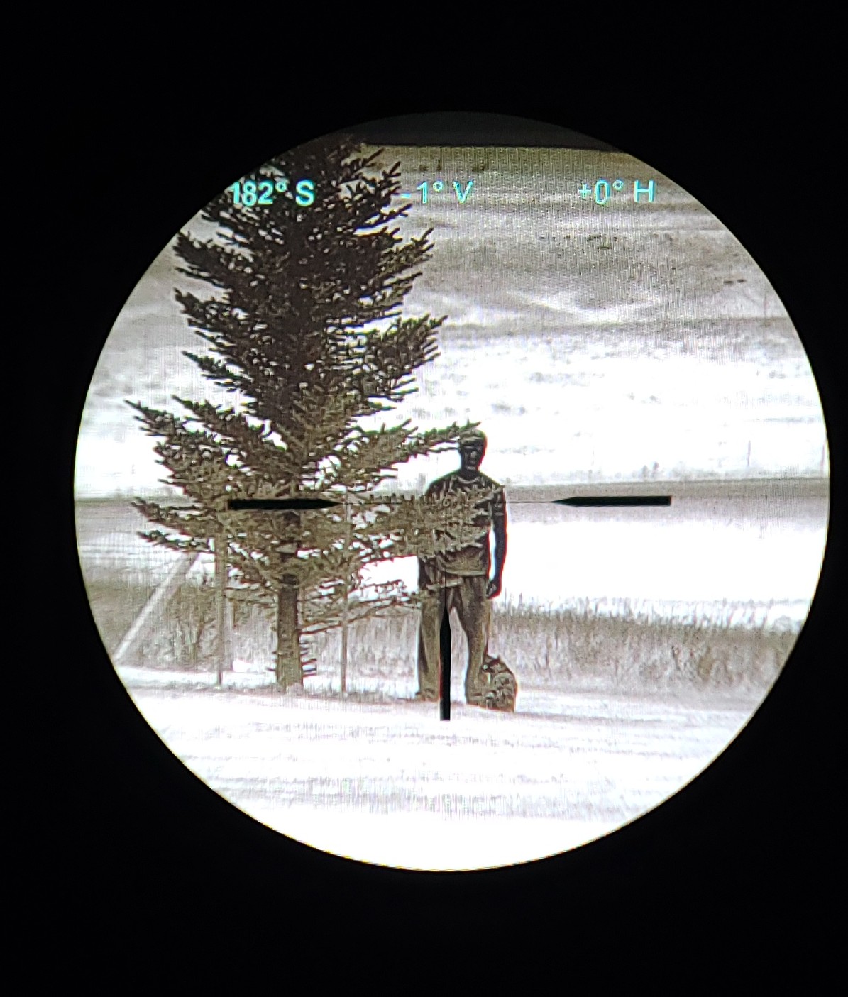

    Im a huge proponent of clip ons personally (currently have the TigIR and the Super yoter C). Where clip ons have the most utility is if you take at distance shots and want to use your day time optic reticle stadia for hold overs/adjustments.
    Now switching inbetween the Super yoter in clip on mode and scanning mode is not the quickest solution, as the eye peice needs to be changed for you to use the optic in a handheld capacity (the handheld mode eye piece is magnified because there is optical demagnification in the back of the optic, which allows for the supporting of day optic magnification) slowing down your dwell time between use cases.
    You also have to consider what day optic you are using. The type and quality of the glass on your day optic has HUGE implications on the image you will perceive to your eye. Lots of guys that are unhappy with clip on thermals start with too high of a base magnification, causing early pixelation. Unless you have a VERY high tiered, long range military thermal clip on, it is best to stay with LPVOs like the Vortex Razor for use, or fixed lower powered day optics like prism scopes with the majority of civi clip ons.
    From what you posted, a stand alone optic is the better option. However, if you decide on going the clip on route, then get the Yoter C over the Hogster C, as the 640 core of the Super Yoter C will provide better PID at distance, gather in more detail from the environment, and provider a better image in poor weather conditions compared to a 384 cored unit.
    Here's some examples of the Super yoter performance
