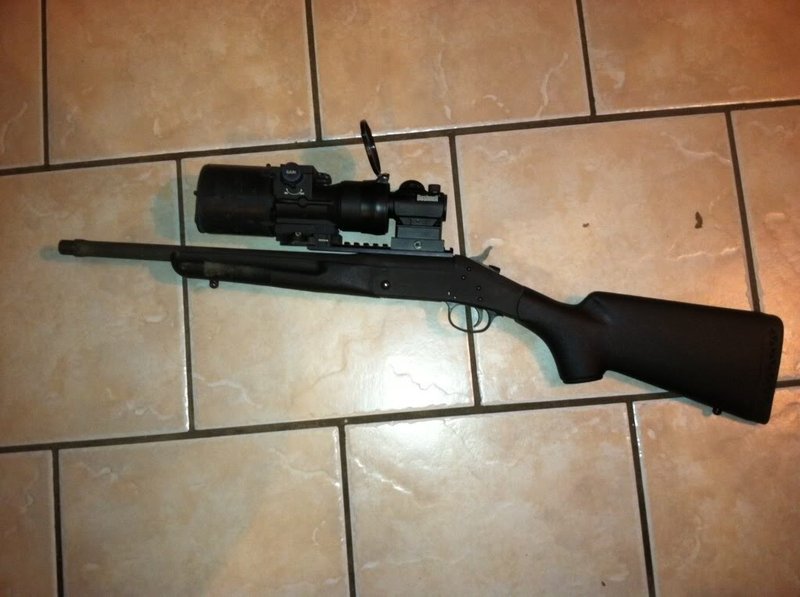

I bounce this clip on from this 308, to my 556 rifles and even my 300wm. Its the Armasite CO MR

A PVS-9 SIMRAD clip on would do the job.
Youd have to convert to Badger rings in each and every gun you want to run it on.
I've got mine on a 6-24x scope and I can use it to 12x and 200 yards with great clarity. Haven't got a chance to stretch it further yet but I've been impressed so far.
Can be found between 1800-2400 and with mounts fairly regularly.

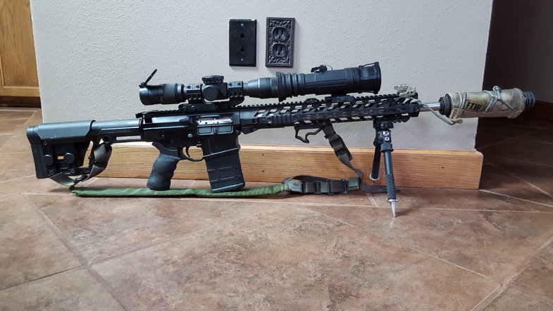

Just got my new chassis from mcree for my savage fvsr. This thing is fricken fun as hell. Suppose the clip on is much lol
Sent from my iPhone using Tapatalk
Nah that's not too much clip on pal. This though.... this just might be.

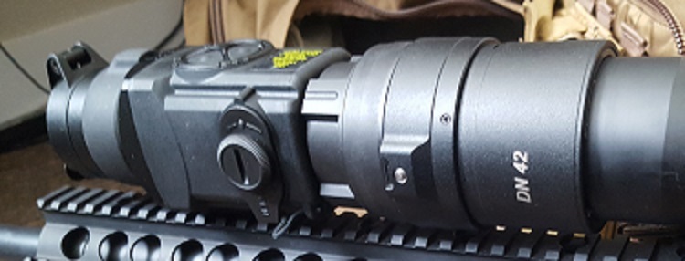

Pulsar has a new thermal clip-on that I was actually quite impressed with ( only thermal clip ons I have liked in the past have been t75's or utc's). It has a front attach method that is one of the more secure that I've seen. Was within 2 moa right off the bat on my 6.5 gasser and stayed there with several removal and remounts.The display is a green led which takes a bit of getting used to but is easy on the eye at night. Here are a couple of pics. The day scope was a steiner 3-15. Pic is through cell phone so it is much better in person....75yds at 4x looking at some of our thermal targets. A great feature is that it also ships with a 2x eye-piece to use it as a hand-held monocular. Got it as a T&E but ended up keeping it for demos.
