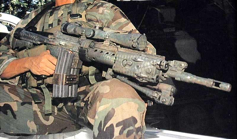

I recently became aware that there are 2 Allen engineering MK12 collar lengths, a long, and a short (to resolve the issue of running into the gas block/fsb on some guns). To the best of my knowledge both lengths would work with a MK12 mod1, but I don't know if one is "clone correct" for a mod 1 and the other is not. ADCO list the long as for Mod 0s and shorts for Mod1s, but I know the shorts were used on later Mod 0s so im taking that with a grain of salt. I know its a pretty nit picky thing, but if I'm going though the trouble of hunting down a Colt BCG and keyhole upper I might as well make it 100% clone correct.
I could be wrong but it appears on AE website the collar lengths are for different suppressors. It seems the short collar is for an SPR barrel with an AEM5. The long collar is for the AEM2,3, and 4.
If you look at this picture, you can see the differences in collar length for the AEM5. Besides the extra length, it works the same as the short collar. You can see there is not a space between the collar and FSB on the picture of the early MOD 0. You may be thinking about the SPR to M4 Adapter which would mount the same way and looks very similar, but is for use with the suppressors you mentioned.
View attachment 7118799View attachment 7118805
