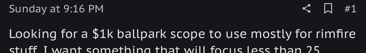

Looking for a $1k ballpark scope to use mostly for rimfire stuff. I want something that will focus less than 25 yards. I’ve discovered there is no easy way to search for scopes with this criteria, so I’ve been spending a shit load of time clicking on various MFGs sites and then checking the specs for each scope.
Part of my problem is that I haven’t shopped for something in this price range for a long time, so I don’t even know what’s what.
Any help and recommendations are appreciated.
