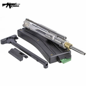

CMMG 22LR conversion kit for AR15
I have a CMMG .22 LR conversion kit and it is reliable. Firing .22 LR ammunition through a .223 barrel with a 1:9 twist rate, you cannot expect great accuracy. The bore is a little large and the twist rate quite fast for .22 LR ammunition.
They can take a little fiddling with depending on the ammo you use, but once you get it dialed in they are great.
IMO they do tend to need oil on the rails to run well.
A few add on items to look at:
Those two I consider mandatory. The only step up is a dedicated .22 solid charging handle.
The rest of their add ons are decent but not mandatory unless running hyper velocity ammo.
And the correct adapter for the mags. It feels cheap and is kinda fiddly to use, but loading the mags by hand gets old fast.
Also the CMMG 10 round mags just have a pin that can be removed to make them into a 25, assuming are legal in your area.

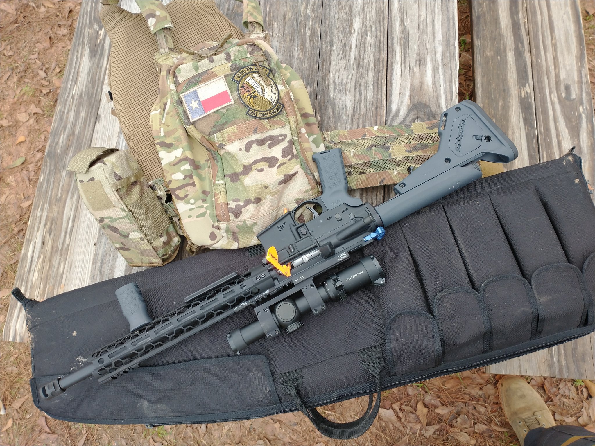

CMMG dedicated bolt group is in this rifle, blackdog mags fit better in the plate carrier mag pouches.
