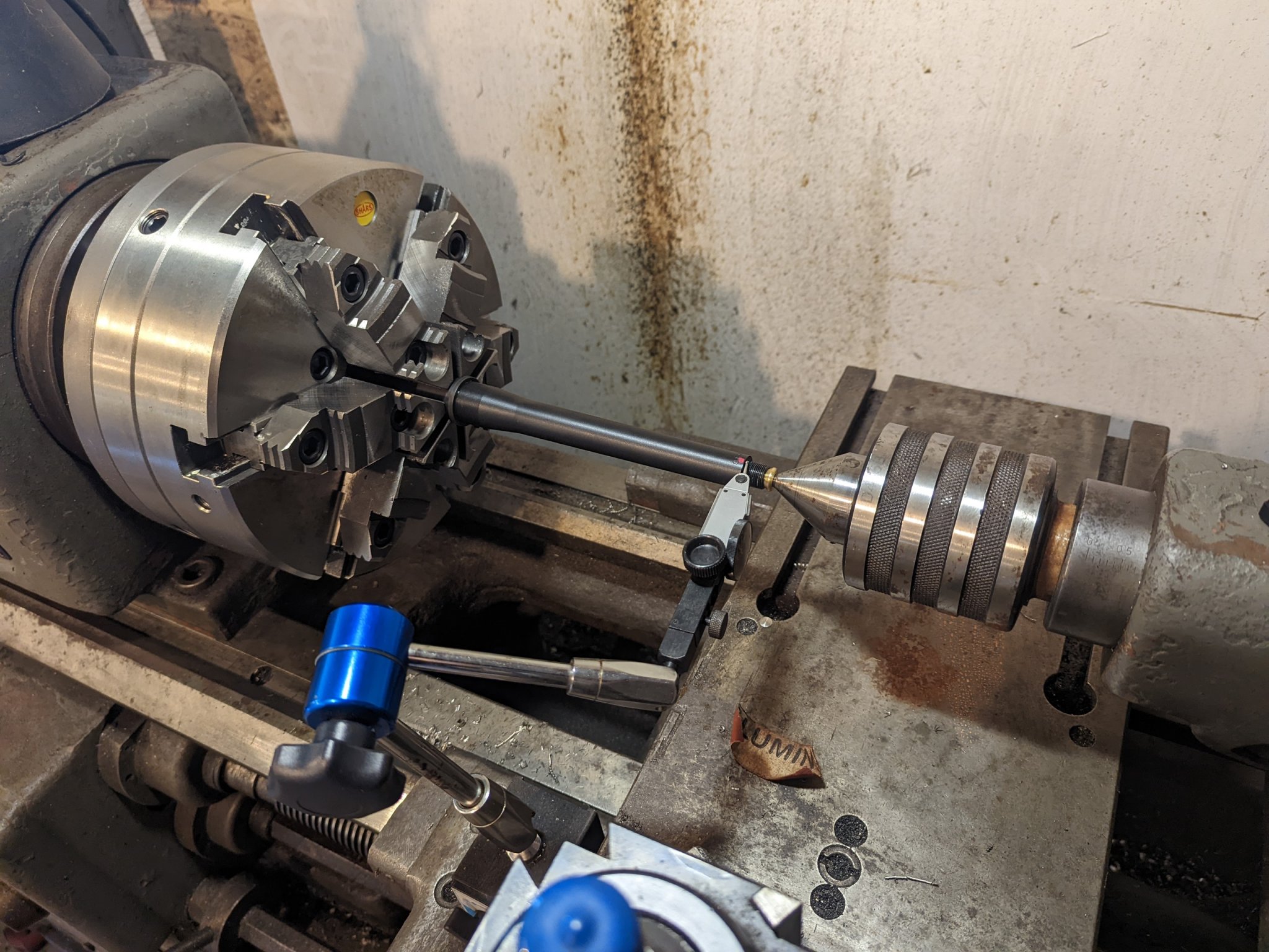

It did show up with about 0.003" of axial runout on the barrel shoulder, which doesn't sound like much but eats up every bit of clearance and then some by the end cap of a Obsidian 9. I spun the assignment rod 360°, I swapped mounts, I tried two other cans, and then I pulled the barrel, chucked it in the lathe, and confirmed the barrel was the problem. At that point, it took about 30 seconds to fix the problem.
Very nice! I wish I had the space for a lathe in my house/garage. Definitely saved you have to ship it back to CMMG or pay someone else to fix it.
Yeah, it's nice to have but I'm not sure that it has paid for itself yet 😉 More than anything, I was impatient to try out my new Obsidian 9, and it really didn't take much time to troubleshoot - less than an hour from "huh this alignment rod doesn't look good" to "9mm bullet hose quietly goes pop-pop-pop". Seemed like a better use of time than any of my posts in the Bear Pit.
