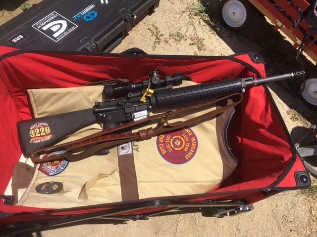

Budget build: WOA barrel, BCM blem upper, Brownells BCG, used RRA float tube, Vortex PST MOA 1-4.5X
PRI low cantilevered mount places the scope center at 1.3" which is the same height as the rear sight aperture on an A2 upper.
