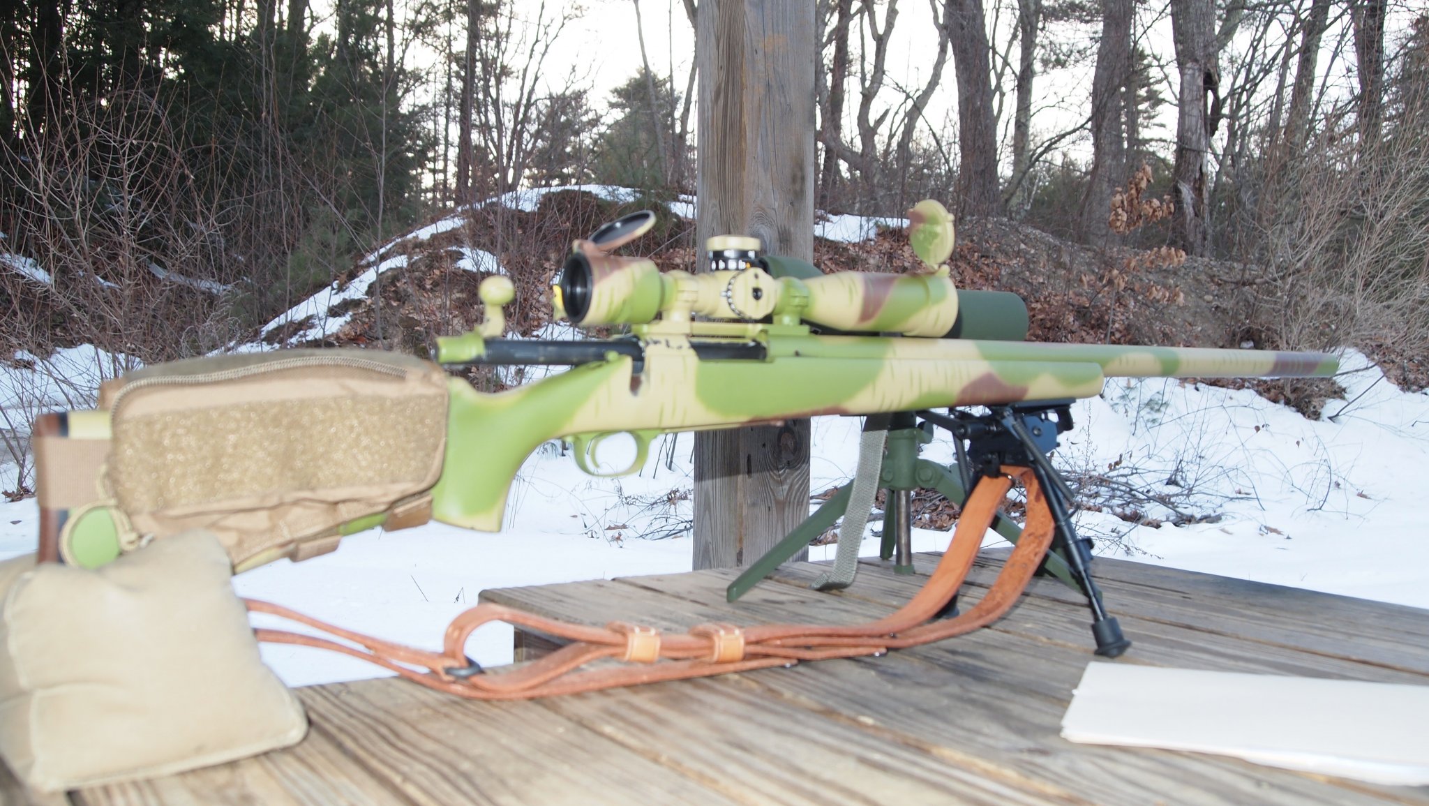

Had my USO version of it out yesterday.......

Mine is zeroed at 300 yards (on the 3 setting) using the allen wrenches.
When using FGMM 175s the 1-10 coarse elevation settings are pretty close to being as marked....1 = 100 yards, 2 = 200 yards, etc.
There is always some messing with the fine elevation to do if you are shooting paper but for what the scope was intended to do and the size of the intended target it can be plug and play pretty much.
There are people out there that have "converted" .50 cal scopes back to M118LR scopes.
