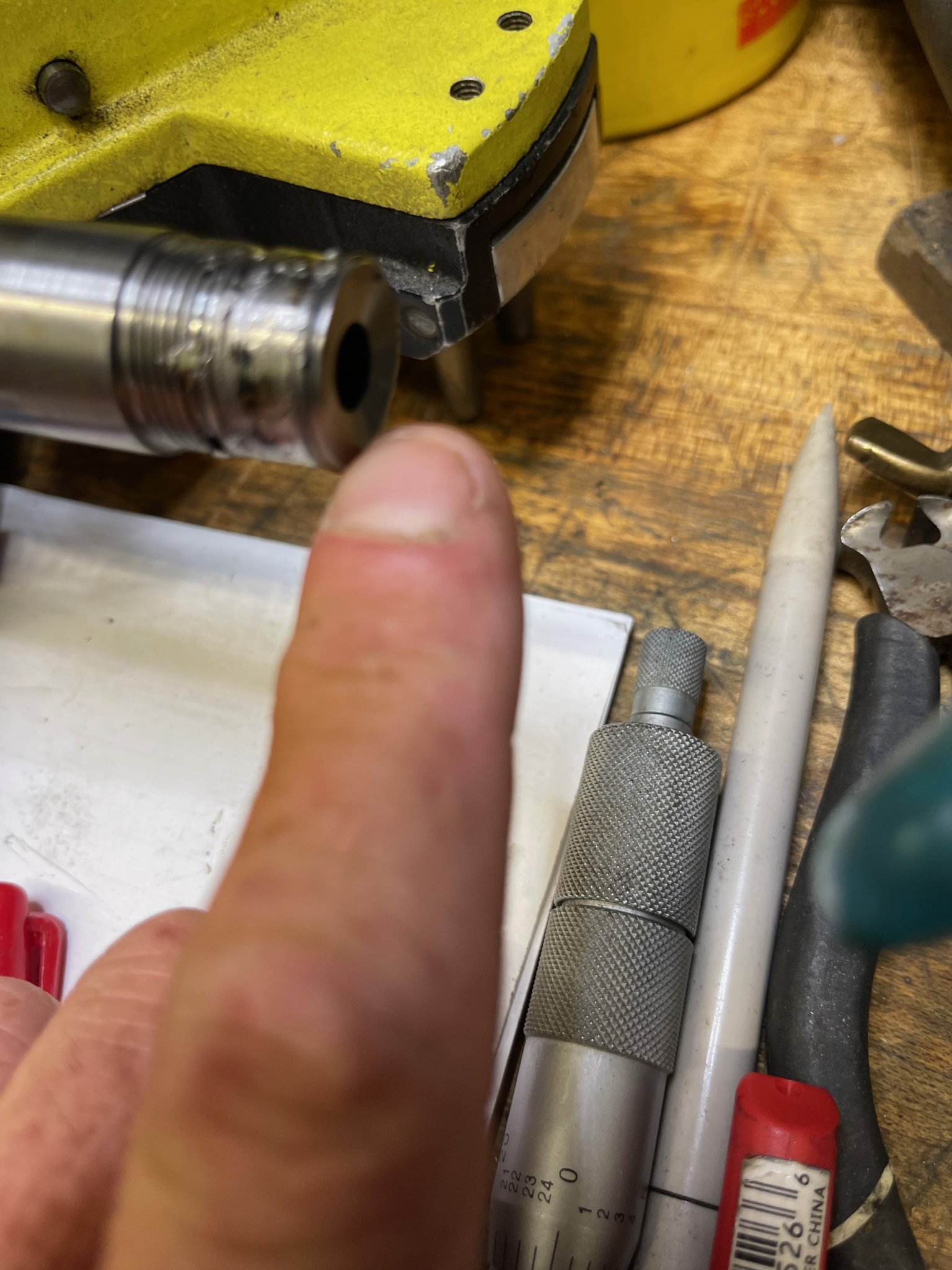

Well, the CNC lathe decided to take a bow yesterday and ram the entire tool turret into my new 300prc barrel as i was on the last pass of threading for the tuner. so very depressing, but impressive, pretty sure it bent the last 3 inches of the barrel as that's all that was sticking out. Optical encoder decided to take a shit.
life goes on.... post pics once i get it out of the machine...

OUCH,,, ok i feel a little better. what sucks is we did two setup peices no problem, then on the final tweak it in for a smooth fit on the threads,,, ..
Well that sucks, maybe enough left to sell someone a nice hunting length barrel? Tactical length?
yeah, i'lll measure it tomorrow, but looks like it will be too short for long range fun, thinking it's chopping a good 3 inches off the barrel for sure. maybe I can sell it to someone just looking to plink and look cool
