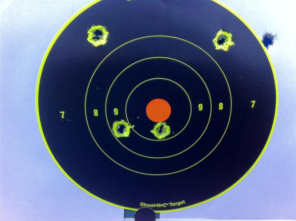

Here is my last budget build Savage. Started out as a Model 11 Hog Hunter. The cheapest Savage in the lineup at $460 online. I like it for a base because it has the 20" threaded barrel so I did not have to change it. B&C stock, Harris, Atlas mono, JP compensator, DNZ rings, Primary Arms 4-14 FFP scope. Total cost about $1200 and I've taken it to a grand easy. . I did the Cerakote so no cost there. I run Geisselle triggers in my AR and have found no need to replace the Accu-trigger with an aftermarket. I have it set at about 3lbs and really like it.
3 at 100 with 155g SMK over Power Pro 200MR
5 at 500
