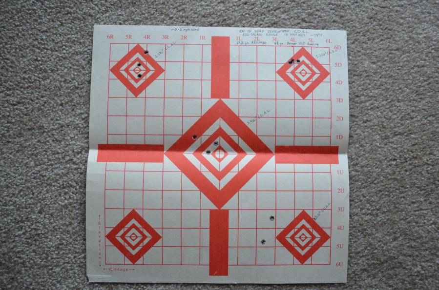

COAL and POI changes
I just got through some of my load development for my 7mm rem mag. I am shooting 168 gn. Berger VLD's and followed the procedure found in Berger's reloading manual to find optimal cartridge overall length (C.O.A.L.). The procedure was as follows:
1. I found the COAL where the bullet touches the lands (which happened to be 3.440" for my rifle).
2. I loaded six rounds .010" off of the lands, six .050" off, six .090" off, and six .130" off (see all of my load data in the image below).
3. I shot two three shot groups of each COAL at 100 yds.
4. I evaluated the data to determine the most precise COAL (in my case the COAL with .090" jump happens to be the most precise. The group shown is about a 3/4 minute group.)
Notice that the 3.310" and 3.390" groups have a horizontal variation of about 2 moa!
