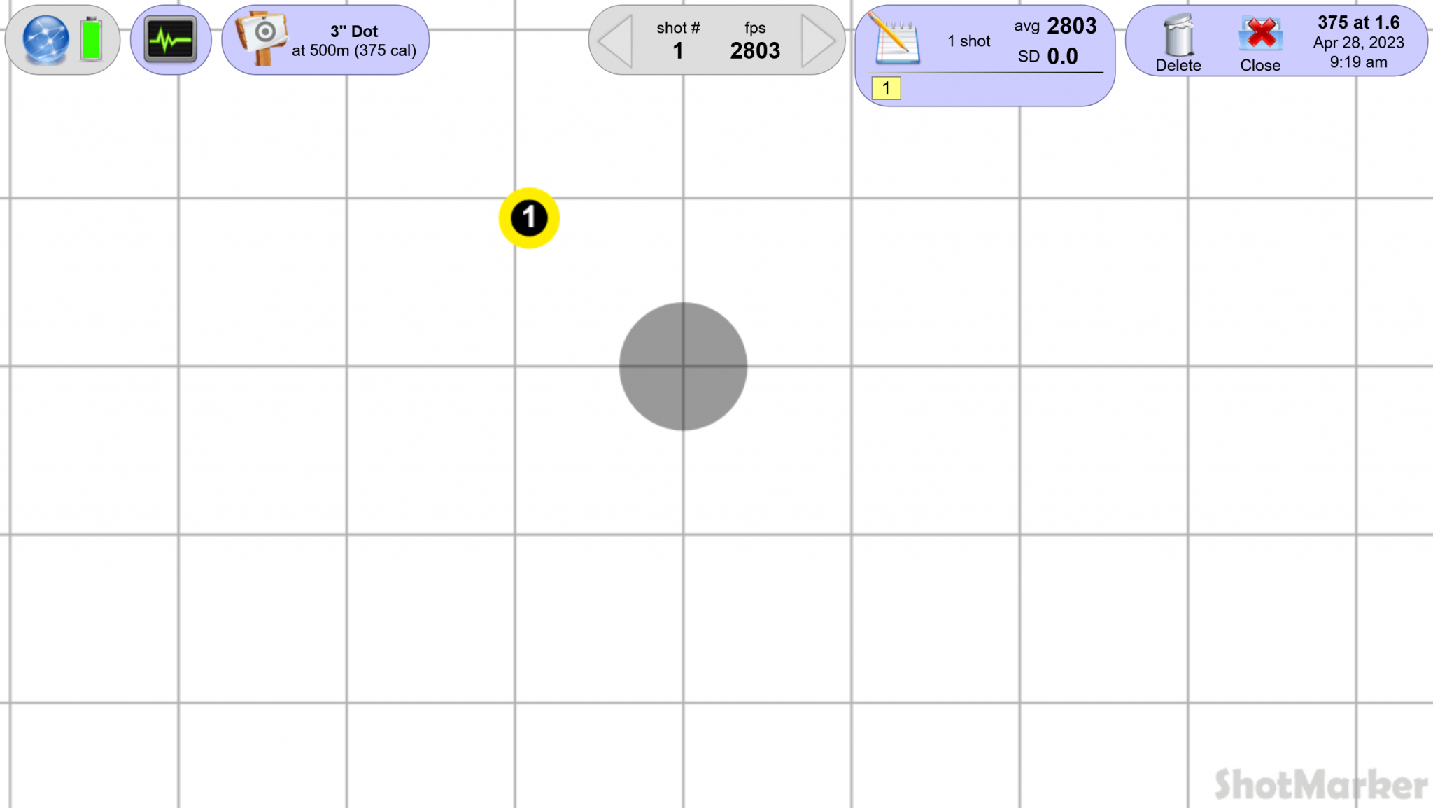

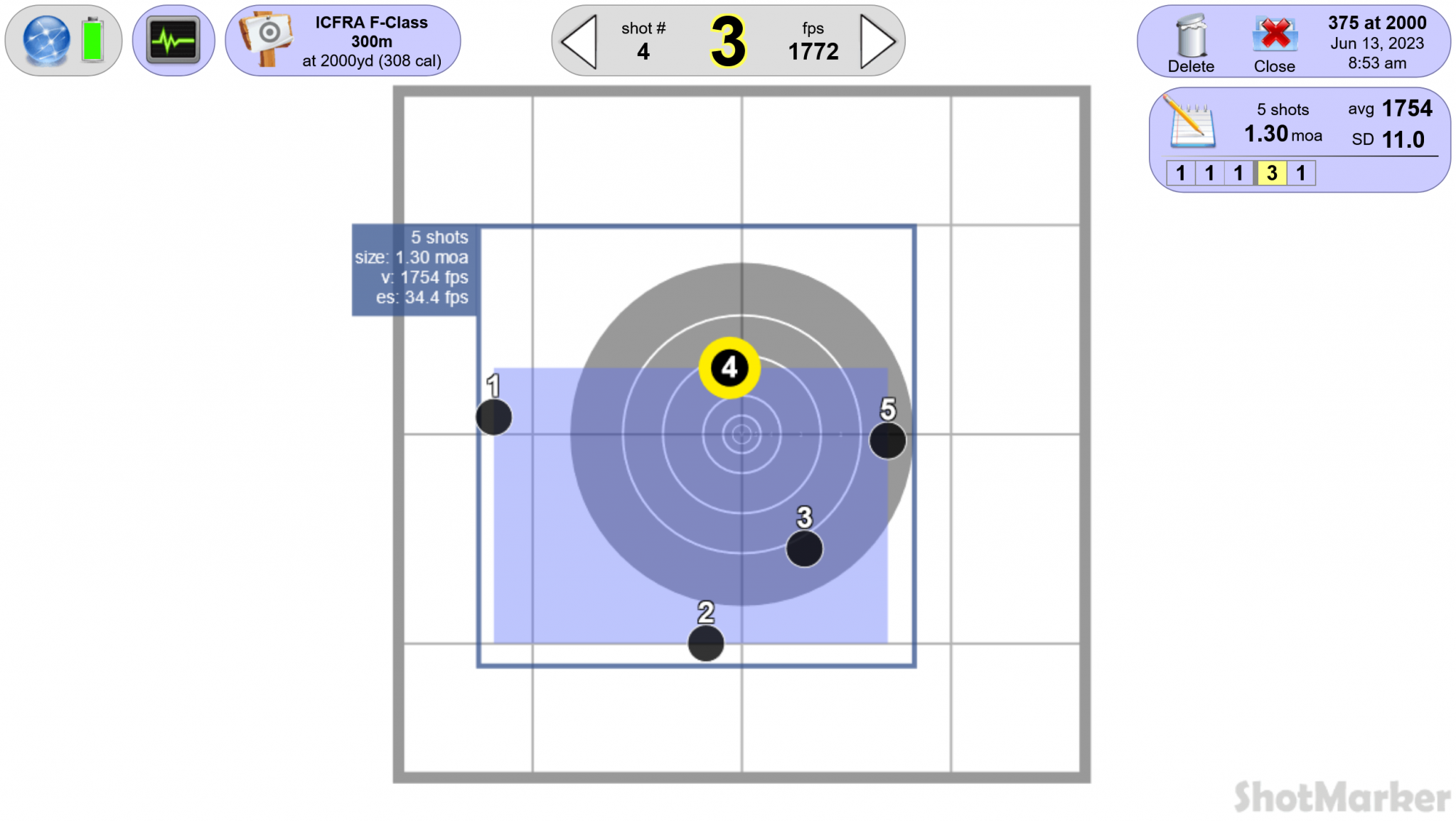

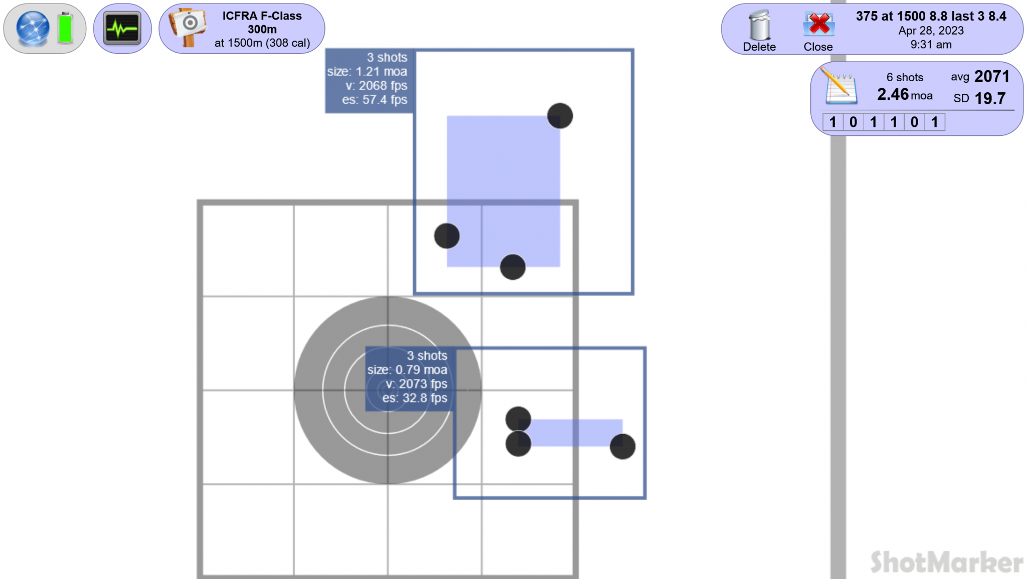

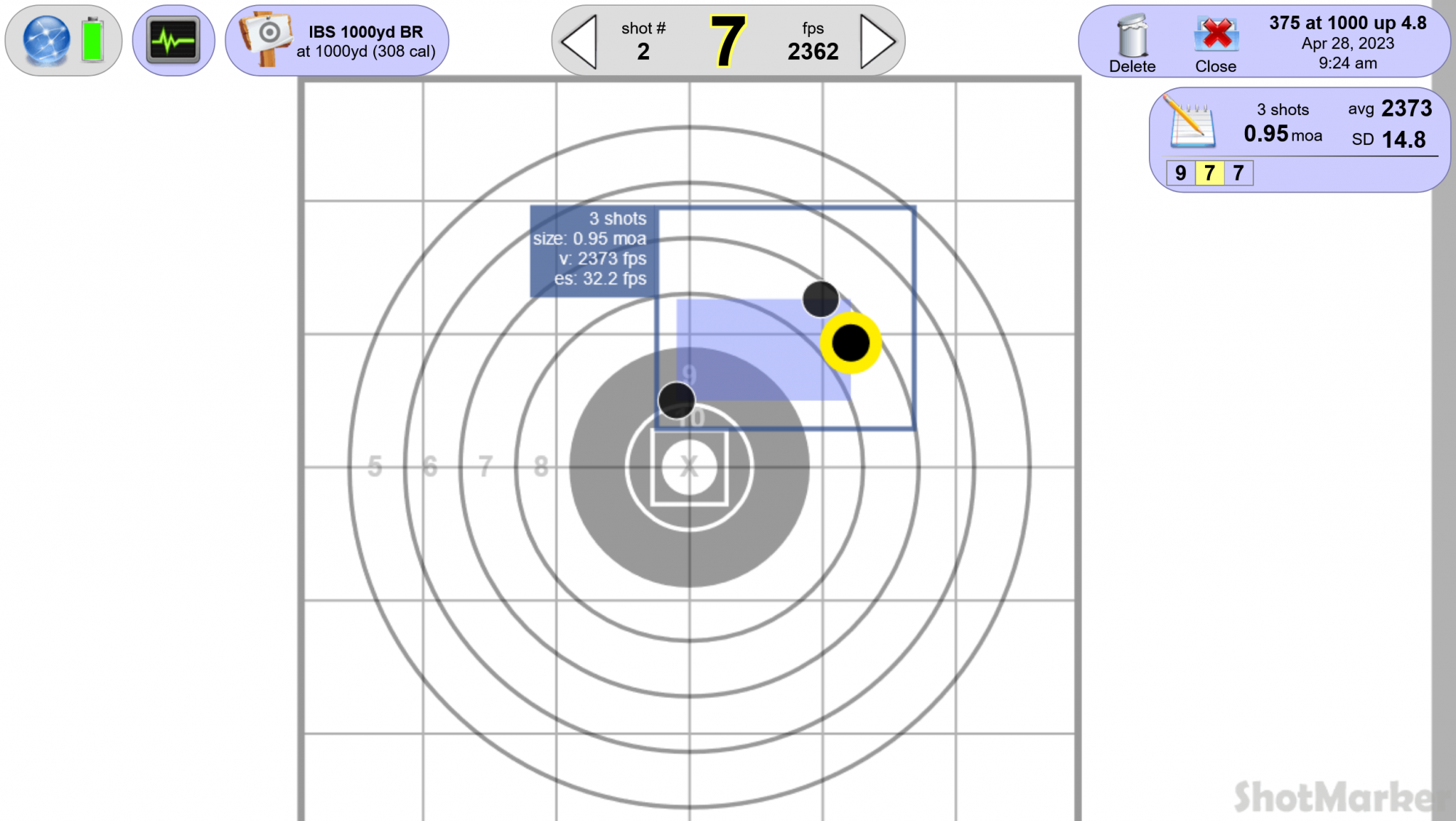

    New barrel and can on the Ashbury .375 CT means a recalibration of the computer. Final test on the 2K range this AM looks like we are pretty much on the cam. Can't tell you all how much simpler the use of the Labradar, Shotmarker targets and the Wind Zero meters makes the whole process, next best thing to having a Doppler unit. 6 rounds to zero at 100, getting MV off the Labradar. 1 shot at 500 to test initial come up value and get downrange velocity check. 3 rounds at 1000, making a slight BC edit as we are .2 high (grid is .2 mil). Then, two 3 shot groups at 1500, still a bit high for the first 3, small change puts group on the waterline. This AM was a final test, cold bore 5 round group at 2000.
    View attachment 8161766View attachment 8161767View attachment 8161769View attachment 8161770
    That's awesome. What software/hardware do you use to get that level of detail/analysis?
    The ballistic software is Field Firing Solutions. The Labradar provides muzzle velocity using a Piet recoil trigger. The Shot Marker targets from Adam McDonald provide precision shot grouping and downrange velocity information. When coupled with actual wind data from the Wind Zero meters, a very precise BC and DK value can be computed easily. Using Vector 21 BLRF backed up with GPS gets the calibration target ranges +/- 2 yards. First shot at 2K was about 15" left of center, so I nudged it into the wind (R-L at < 2 mph) to the edge of the plastic used as the aiming point on the ShotMarker (24" wide) and shot the rest of the group.
