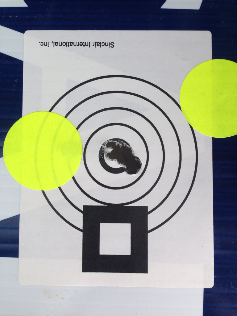

5 shots cold bore after removing chassis and reinstalling torqued to 10Nm per AINA:
Will continue to test but I think this fixed the issue.
