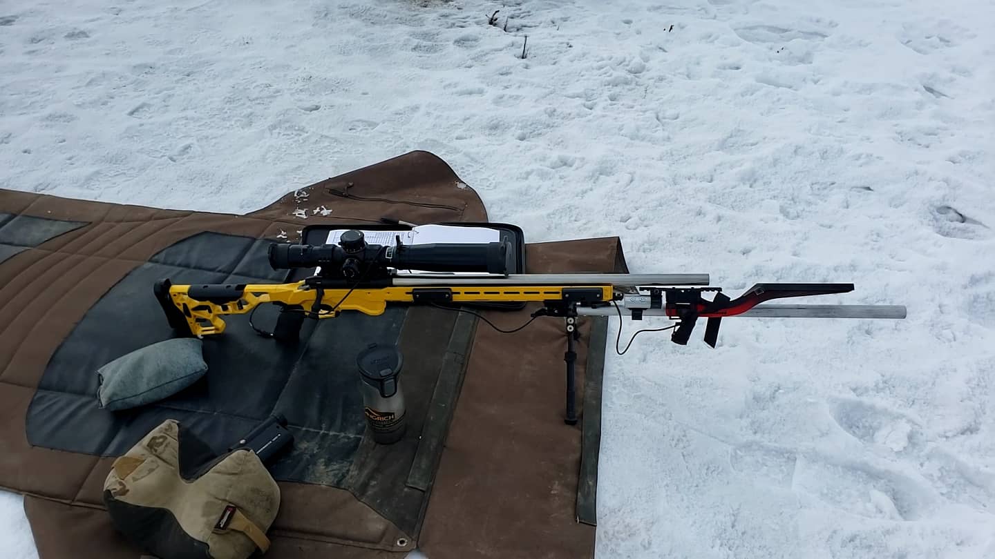

We often hear that cold weather and 22lr ammo dont mix. Ive been testing a variety of ammo this winter. I'm using a RimX with a IbI barrel at 26" 1-16 twist.
I used SK Long Range, Rifle Match (3 lots), Pistol Match, Center X, Eley Force, Contact (2 lots), Match, Tenex Biathlon, Federal Target, CCI sv. And several others.
Testing is 50 yards 10 shot groups 210 yards 20 shot groups. At 200 I only measure the vertical. Most ammo I have multiple groups
The first 1000 rounds I could track improvement in accuracy. I'm now at 26-2700
We typical have 950 hpa to 978 hpa. I got this rifle over Christmas 2020 so I have no warm weather data yet.
I can see no difference in average accuracy from 0⁰c/2⁰f to -10⁰c/14⁰ f at -15⁰c / 5⁰f I see some degraded accuracy across all ammo. The Tenex Biathlon in my rifle was alway one of the worst regardless of temp.
The SD of velocity is progressively worse with colder temps but doesnt show on target at long range.
Lapua/ SK ammo is the most temp sensitive in my tests. But seems to maintain accuracy the coldest. Also the SD stay very consistent.
Eley is surprisingly temp stable and hold accuracy very well to -10⁰c/14⁰f at the colder temps the groups were slightly less consistent. Eley Force and contact are my best two ammo for accuracy.
Federal below -8⁰c/19⁰f starts to loose stability by -15⁰c/5⁰f its key holes at 50 and wont stay on a 8x11 paper. I shot some Target high velocity (same bullet) and it improved slightly to 3-4" groups plus odd fliers.
CCI sv is very temp stable under most conditions. The accuracy remained the same till -10⁰c/14⁰f but at -15⁰c/5⁰f the groups grew considerably and I have very slight key holing on the occasional round.
My limited testing shows accuracy holding up better then I expected with cold weather and if you are accurately tracking velocity change I see no reason to keep ammo warm until shooting your stage. 22lr ammo cools very fast so if you start with warm ammo your velocities will change well shooting the stage.

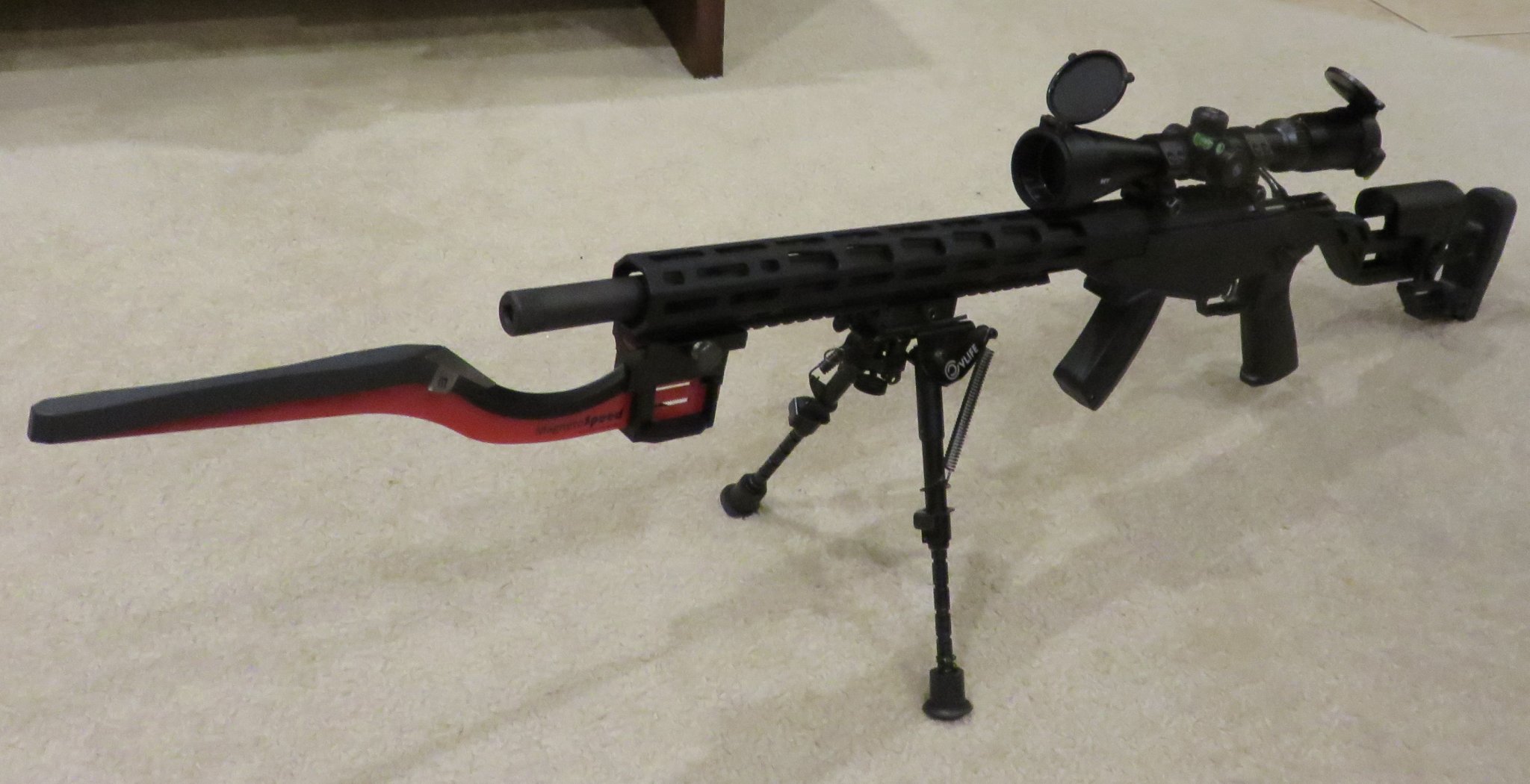

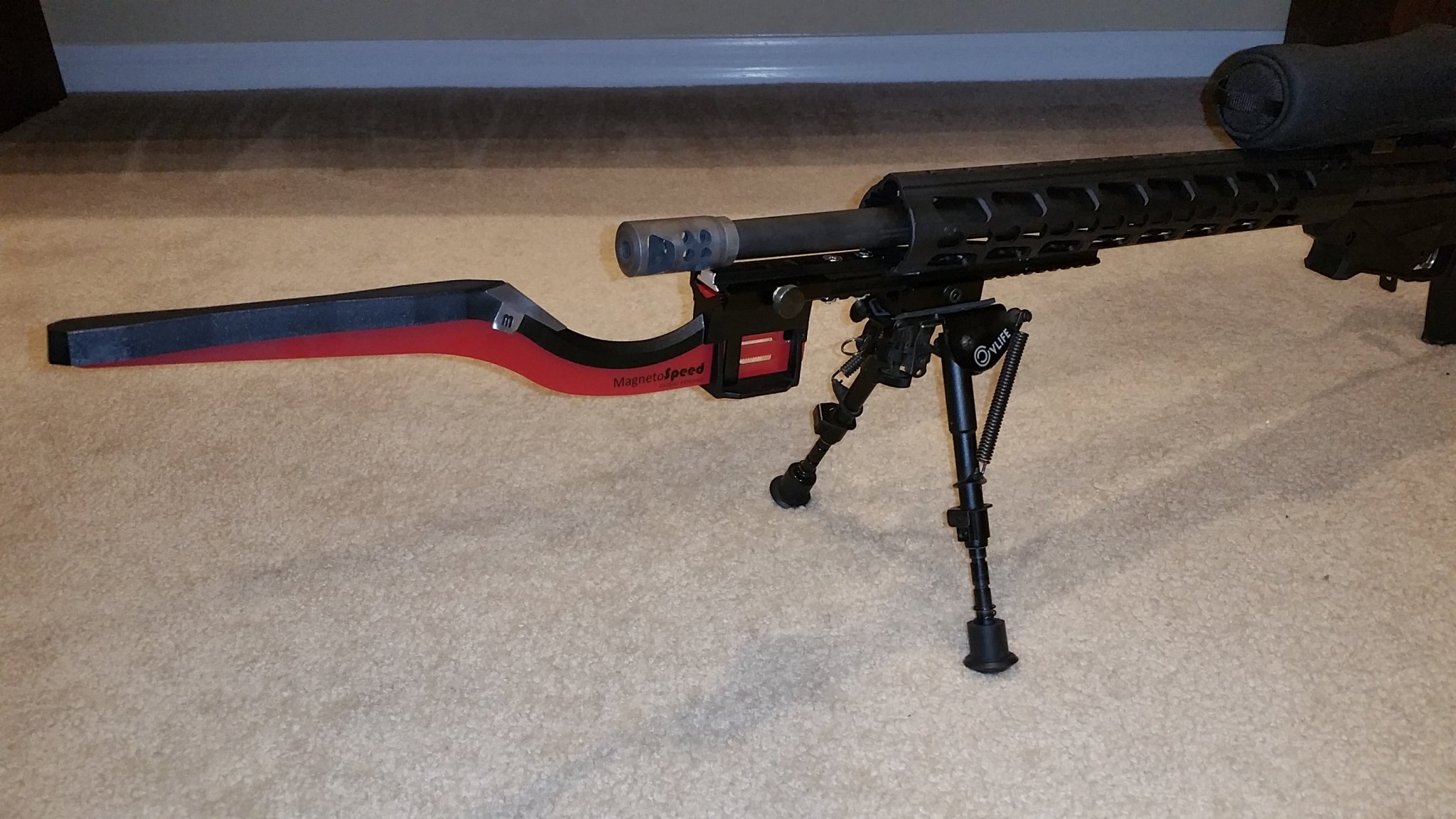

After hearing the results of the NRL22 match in Marshall last weekend I had to figure out what happened. There were several very good shooters who performed uncharacteristically bad. Last night a tried my own temperature test and here's what I found.
Lapua Center X
Bergara B14R
Magnetospeed
Rifle and ammo were the same temperature for all tests.
Temp (F) MV Avg (fps)
72 1082
31 1052
-5 1032
I also looked up the speed of sound based on temperature and found the following:
Temp (F) Speed of Sound (fps)
+20 1073
+10 1062
0 1050
-5 1045
-10 1040
-20 1027
As you can see, at -5 degrees my average was borderline supersonic, probably in the transonic zone. The highest velocity for the -5 shot string was 1047 which appears as though it would have left the muzzle supersonic, and immediately started the turbulent transition. As the temp drops and the speed of sound drops, there is a good chance many of the shooters were seeing the effects of transitioning from supersonic to subsonic which could explain at least a portion of the issues. Keep in mind, the wind chill during the match was approximately -25.

After hearing the results of the NRL22X match in Marshall last weekend I had to figure out what happened. There were several very good shooters who performed uncharacteristically bad. Last night a tried my own temperature test and here's what I found.
Lapua Center X
Bergara B14R
Magnetospeed
72 1082
31 1052
-5 1032
+20 1073
+10 1062
0 1050
-5 1045
-10 1040
-20 1027
As you can see, at -5 degrees I was borderline supersonic, probably in the transonic zone. As the temp drops and the speed of sound drops, there is a good chance many of the shooters were seeing the effects of transitioning from supersonic to subsonic which could explain at least a portion of the issues. Keep in mind, the wind chill during the match was approximately -25.

Magneto
30 minimum I record the 10 at 50 and the 20 at 200. If I really want to check out a ammo I'll do 3 groups at 200 so then I have 60.
I also will/ have done multiple days of same temp to see if I get repeatable results. I do.
All of my temp tests are done rifle and ammo same temp.
my opinion.... 30 rounds I see as a minimum for average speed. SD 50 rounds will have it. ES all of them... lol 50 gives a good idea. Typically batch to batch of 30-50 ES is simular. I dont look at ES much unless I get a a extra large ES in a group at distance.
I've done several hundred of one to see what minimum shows close to average without wasting ammo. Bulk ammo takes more.
More then you asked for I realize. I like details i guess.

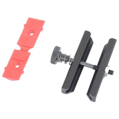

The Magneto chronographs are reputed to give relatively accurate data. Is this a model that attaches to the barrel? If it is, like anything else attached to the barrel, it can affect barrel harmonics. Have you compared how accuracy is affected when you shoot with it on the barrel and when you shoot the rifle without it?
Reactions: dash4cash
Details can be very important and more is often better than too little.
I agree that 30 rounds is a minimum for getting data that begins to be reliable. All too often people chronograph ten shots and draw untenable conclusions.
I dont attach to the barrel
I did some testing with centerfire on or off with heavy barrels I didnt find a universal conclusion.
