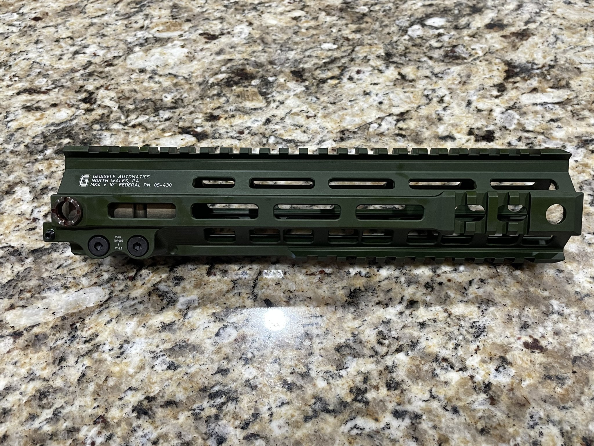

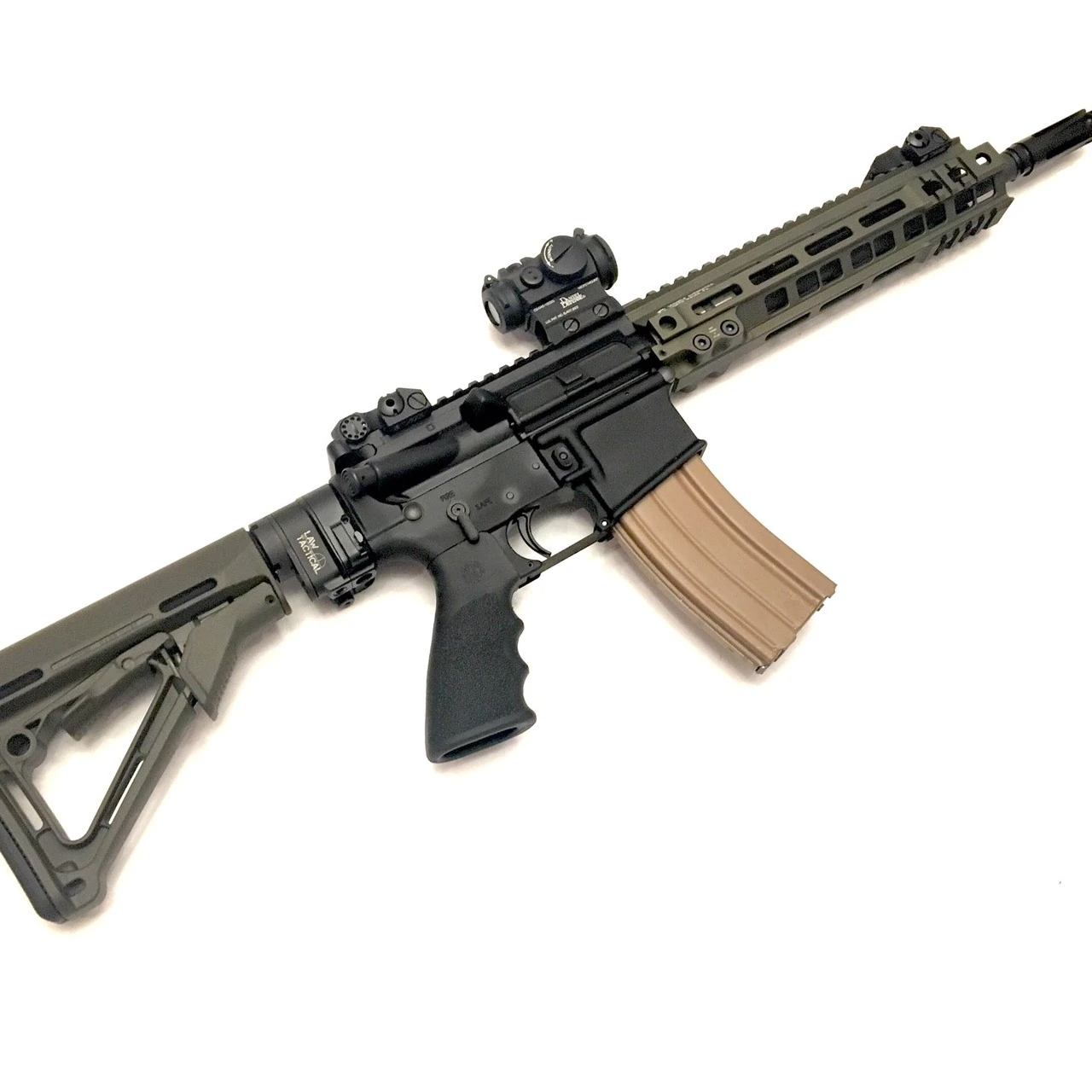

Looking to do as close of a clone to the FBI HRT M4 build.
Im lucky enough to have a Colt lower that can be used on a Pistol as it was not issued as a "rifle".
Along with that I have a Colt 11.5" HRT heavy barrel, I have the Geissele Federal rail issued for the FBI, Colt standard m4 upper receiver and bcg. I still need to take off the current triangle gas block and choose a low profile gas block....any suggestions on what to use???
Also, Im looking to do an aimpoint red dot as I believe that is what they used on there general build....any info on that is appreciated as well

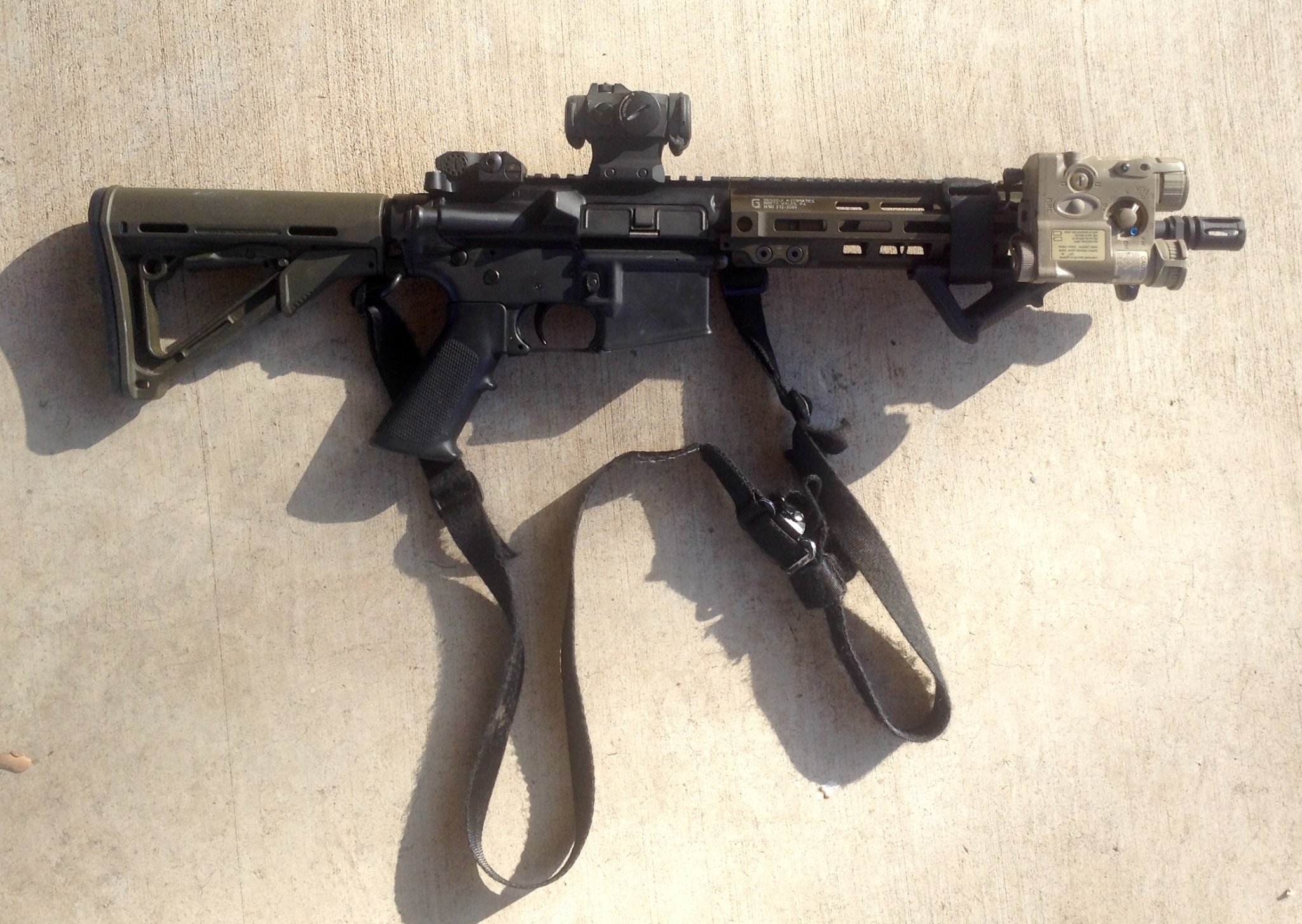

Agreed with lord of war619, the Geiselle block is the one you want. I have a sort of clone of the older HRT/SWAT with the 9" Troy Alpha rail... It just happened to turn out like the older HRT rig by accident. My barrel isn't Colt it's an Expo Arms chrome lined 11.5", 1:7, 5.56 chamber.
Mine has a shaved down A2 fsb pinned. I like to have a pinned GB if it's gonna get beat on and tossed around. I really like the Geiselle GB it's easy to pin also, compared to an A2 fsb anyways...
FBI Tactical Section is using Geissele gas blocks on all the AR's. There are four different FBI hand guards:
FBI SWAT: Green
HRT: Brown/Tan
Tactical SOG: Grey
Regular Agent guns: Black
