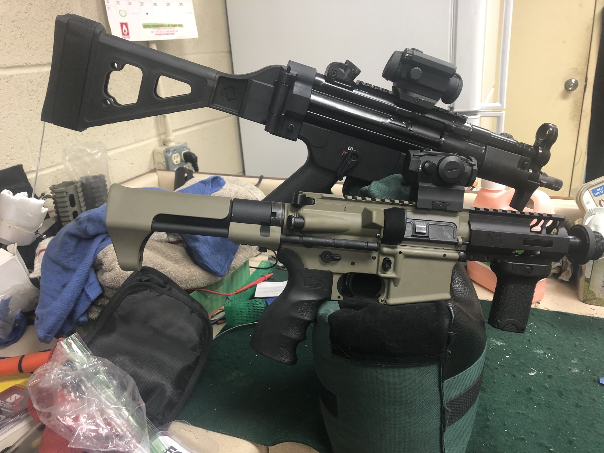

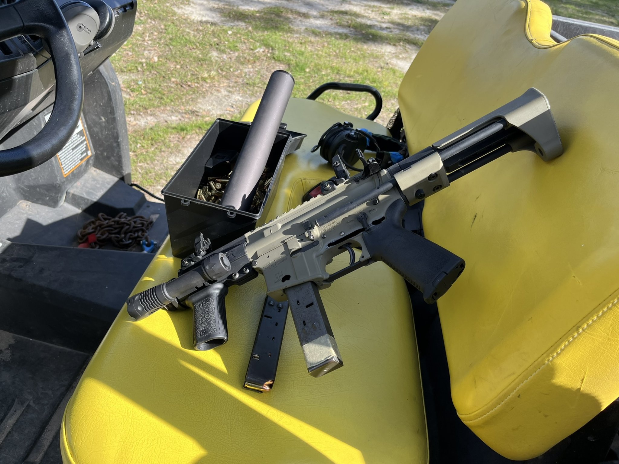

    I built a CMMG gun 12 ish years ago when glock mag lowers were almost non existent. Back then Quarter Circle Ten was the cats meow I think.
    That being said, my CMMG lower has been flawless on feeding and ejecting. I put my upper together from a CMMG 9mm upper, old surplus colt barrel, and a bcg from a company called Tactical Ambush. I don’t believe the BCG company is in bidness anymore though. The only issues I have ever had with my build is the firing pin spring breaking. I keep a couple on had anyway, so it wasn’t a show stopper.
    The bottom gun is the one, and has shot thousands and thousands of rounds. I liked it better than my MP5 clone or Tavor.
    It has changed some and now the suppressor mount sits flush with the handguards, and I lost the red dot in favor of flip up sights. It is a registered SBR, stamped it in 13 or so.
    Reactions: stanley_white
