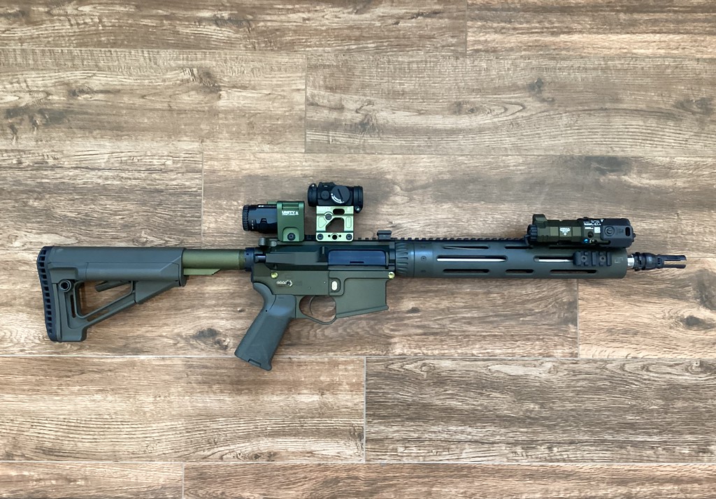

    And I also recently upgraded my night vision game with a MAWL C1+ on my primary pig gun, so I’m a little reluctant to just completely jump off that band wagon:
    Also considered a COTI but I’m actually trying to decrease total weight on my helm, not go heavier.

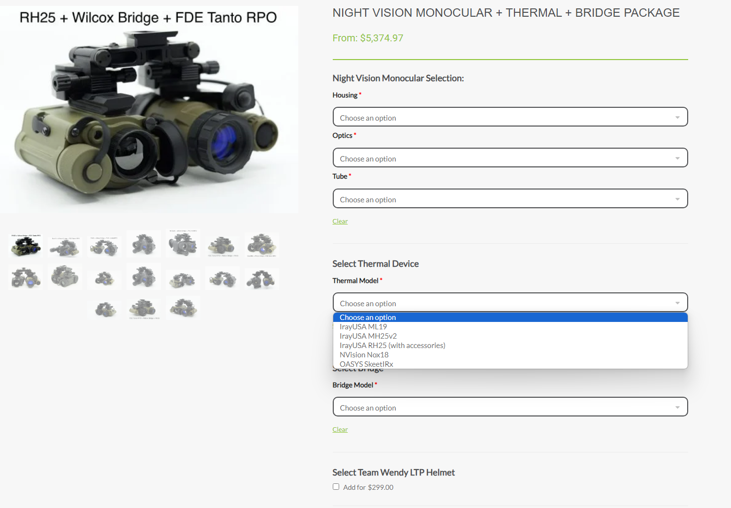

    A new wrinkle, and the thing that inspired this thread is that one of the vendors here is offering a system where you can combine IR and thermal on the same bridge; this deal: https://www.customnightvision.com/product/night-vision-monocular-thermal-bridge-package/
    …which is similar to one of the setups @wigwamitus recommended in post number 15 on my other thread; which really got the hears turning.
    For close to that potentially unreasonable $20K limit I can get the latest L3 night vision tube on one eye, probably my dominant eye to use with the MAWL, and have a SkeetIR for scanning..or I could pop it off and use it as a hand-held scanner or rifle-mounted system.
    Very tempting…. Pic is lifted from their website, so if this is verboten, I’ll delete the image:
    Would appreciate any input from folks who have tried a similar setup…

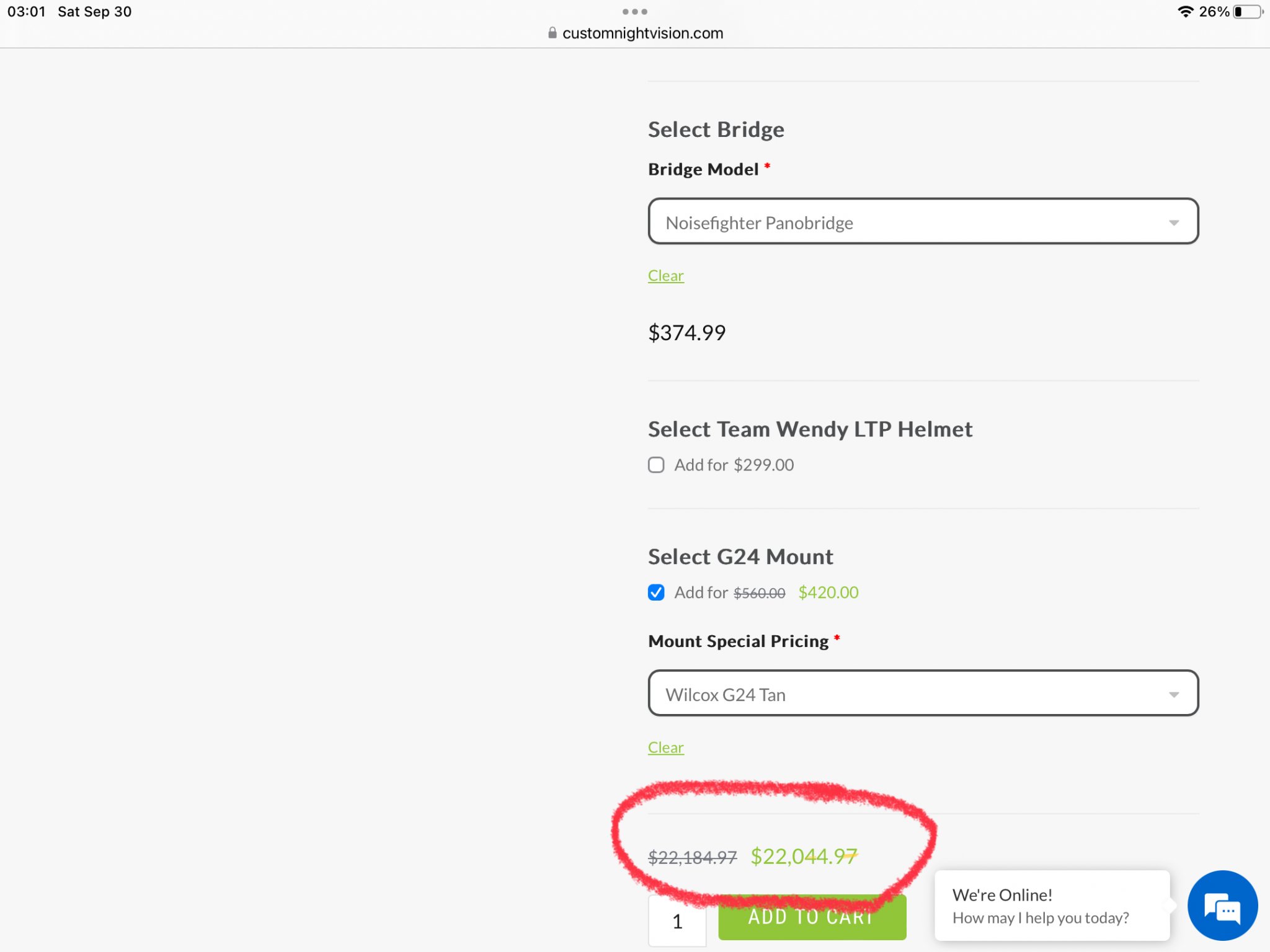

    Edit: Here’s the combo I’m considering; of course, I want the most ex$pensive options! LoL
    ... don’t think the civvie legal fusion stuff is quite where I want it to be ...

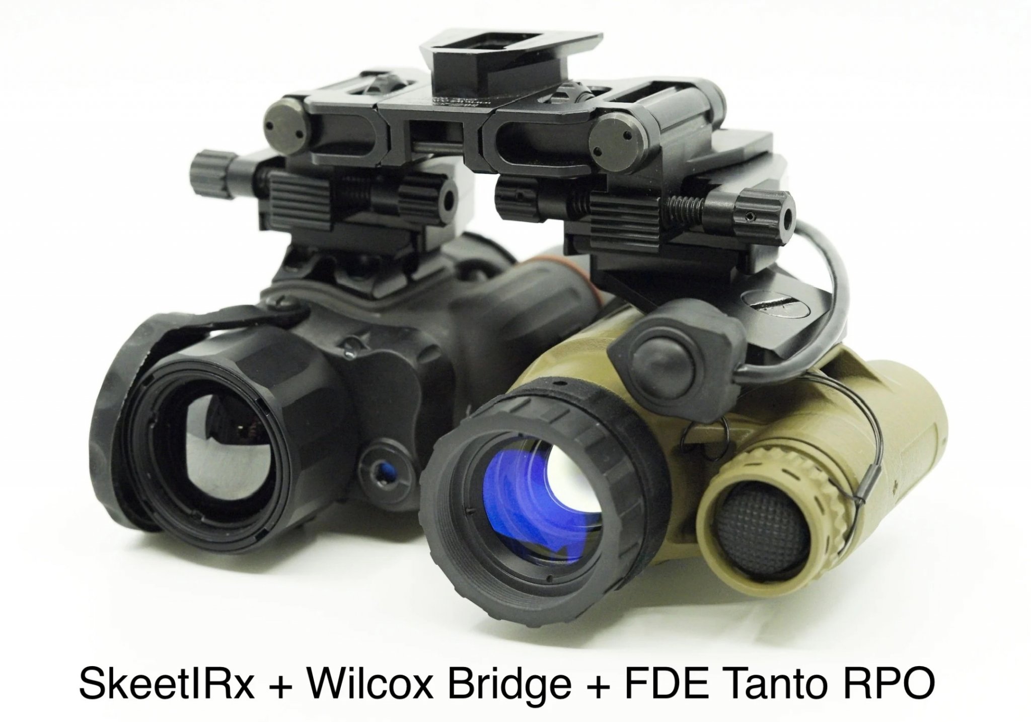

    Also here's another screen shot - as we can see - they have multiple thermal monocular choices - so the poors can substitute chinese thermals for the skeet if desired.
    They don't mention that they collimate the 2 optics together to try to help "merge" the images. In my experience running dual band setup like this is not about having the images merged. Its about having both nv and thermal hands free on my head so I can use them both hands free while moving. If your expectation was that the 2 units would magically 100% overlay each other, you might be disappointed.
    Somehow my brain can either "merge" or switch between the 2 just by willing it to happen. I am not sure that happens for everyone. If I think there is a safety issue (like when rolling fast on 4 wheeler) I can use the on off switches built into my mkI EB (my eye lids) to shut one or the other off instantly without waiting for brain swap software to engage - and I have used this feature a number of times.
    When I "merge" the images, I can definitely see both, but there is an offset. Essentially I see double. But hecque I've seen double all my life - I'm used to it - it doesn't bother me !! :D
    But I do believe a knowledgeable person might be able to spin the rear ends of these critters ( removing / adjusting / reattaching ) to improve the collimation. The images between the 14 and thermal probably aren't the same size (I've used q-14, gen1 ATN ODIN, skeet, patrol, breach and n18 up there that I can recall and none matched on size exactly) nor are they the same shape - the thermals are retangular, the 14 is a circle. So even if collimated only the center of the dual image might not be seeing double. The outer edges probably will still see double (primarily due to the 2 optics not matching on actual magnification).
    The cotis, whether 640 or 320 do line up exactly due to how they work. So we call that "fusion" while we call the 14 + thermal monocular on bridge "dual band" as some means of differentiating.
    Some will arge that even coti+ 14 is not "True Fusion" but we leave those nuances for the higher philosophers. The images do line up and that is worth something even for me, because I want to be able to use the laser and hit what I am aiming at and there are a surprising number of cases - involving vegetation - where the thermal can see the target but the 14 can't but the 14 can see the laser and the thermal can't and I still have a shot and get critters I couldn't otherwise get. And again that is worth something even to me. Hence I sometimes go out with BOTH.
    Left to right
    L - China ecoti 640 + 14
    M - 2x14s and 320 coti
    R - 1 x 14, coti 320 and thermal monocular
    Plus of L is lightest least bulky but enables shooting with laser and has improve thermal PID over the 320 cotis.
    M - offers depth of field for driving conveyances with "glass" on front, but still allows shooting with laser at targets hidden behind vegetation
    R - Offers shooting with laser with fused image AND offers long distance PID with thermal
    I use them all depending on what I am doing that night.

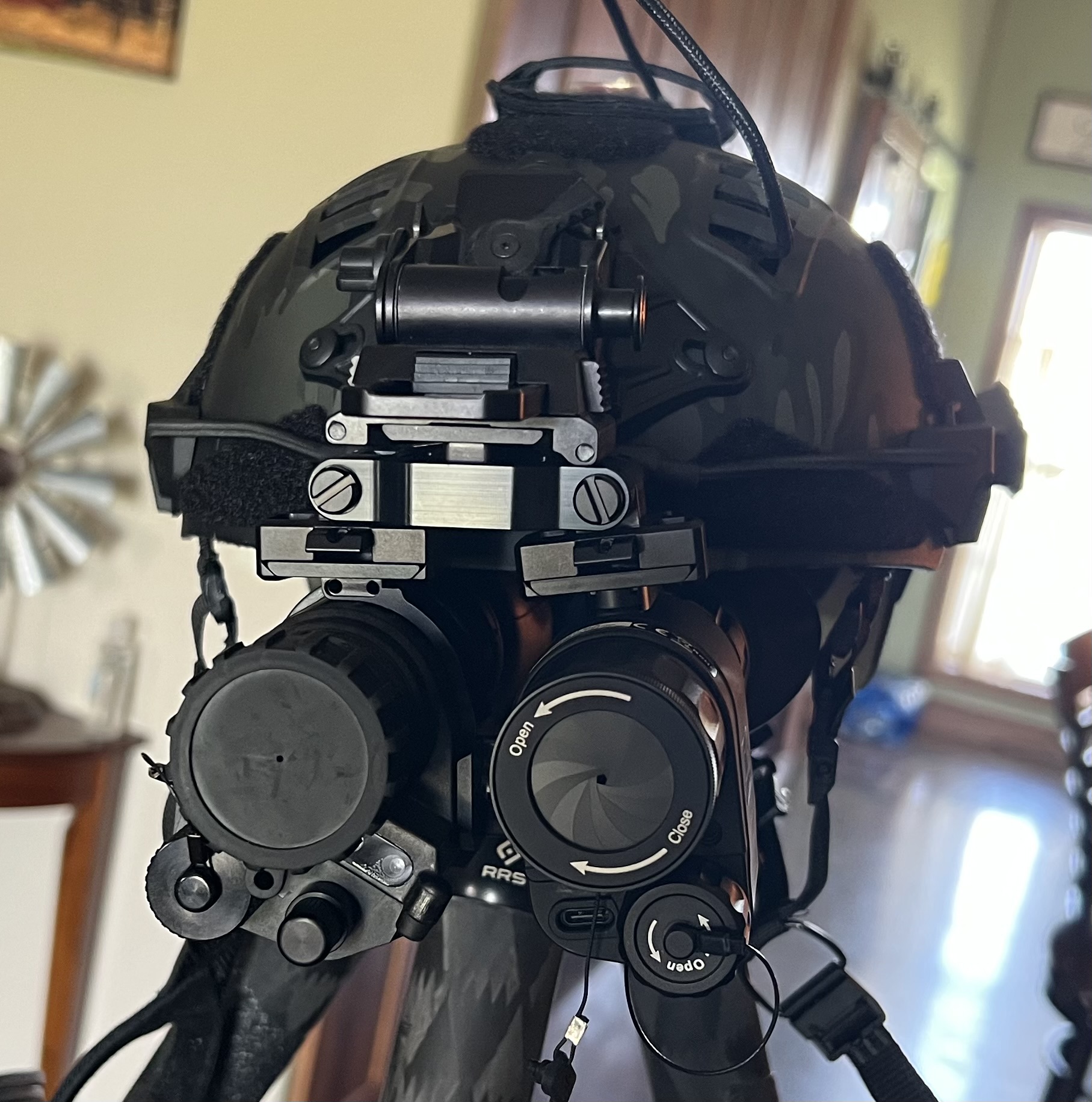

    I'm running a 14 on the right side and a IRay MH25 on the left. Then have dedicated thermal on rifle.
