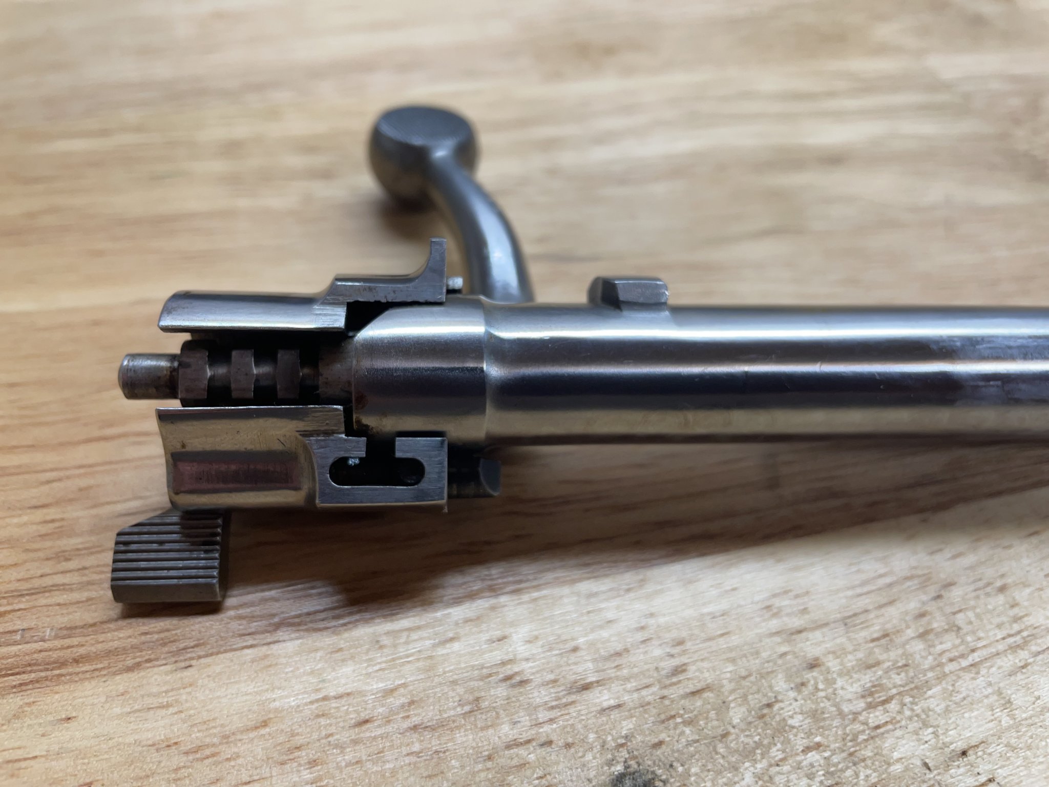

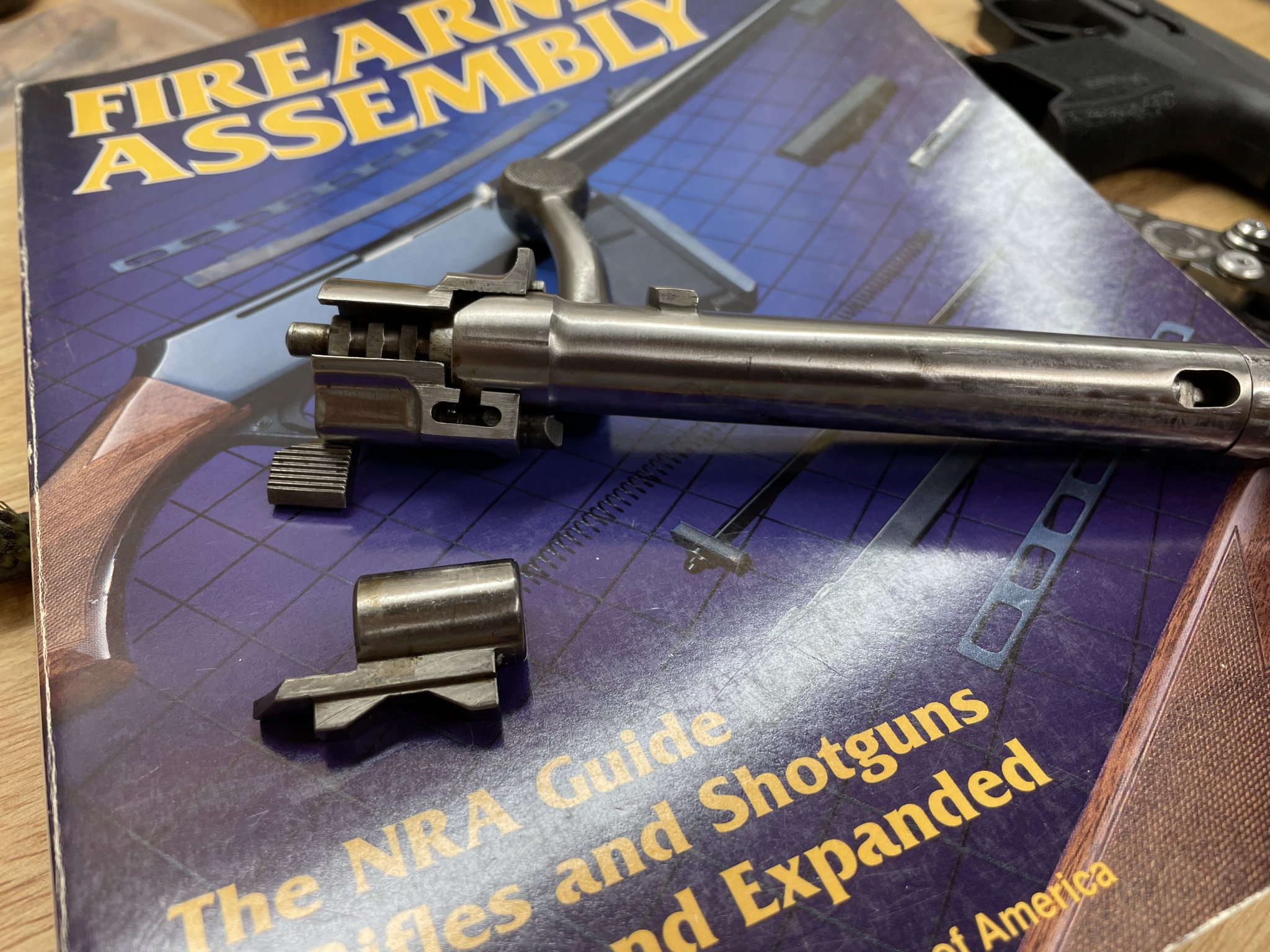

So, I made a mistake I can't seem to rectify. I don't know how to disassemble a commercial Mauser bolt. Since the safety has only two positions, I was attempting to cock the bolt on my bench and in the process, the cocking piece came off. The confounding part is that the firing pin is 90 degrees off so the cocking piece won't go back in.
Can someone please explain my mistake, and can someone please explain the correct way to disassemble this? I can find shockingly little at Google University.

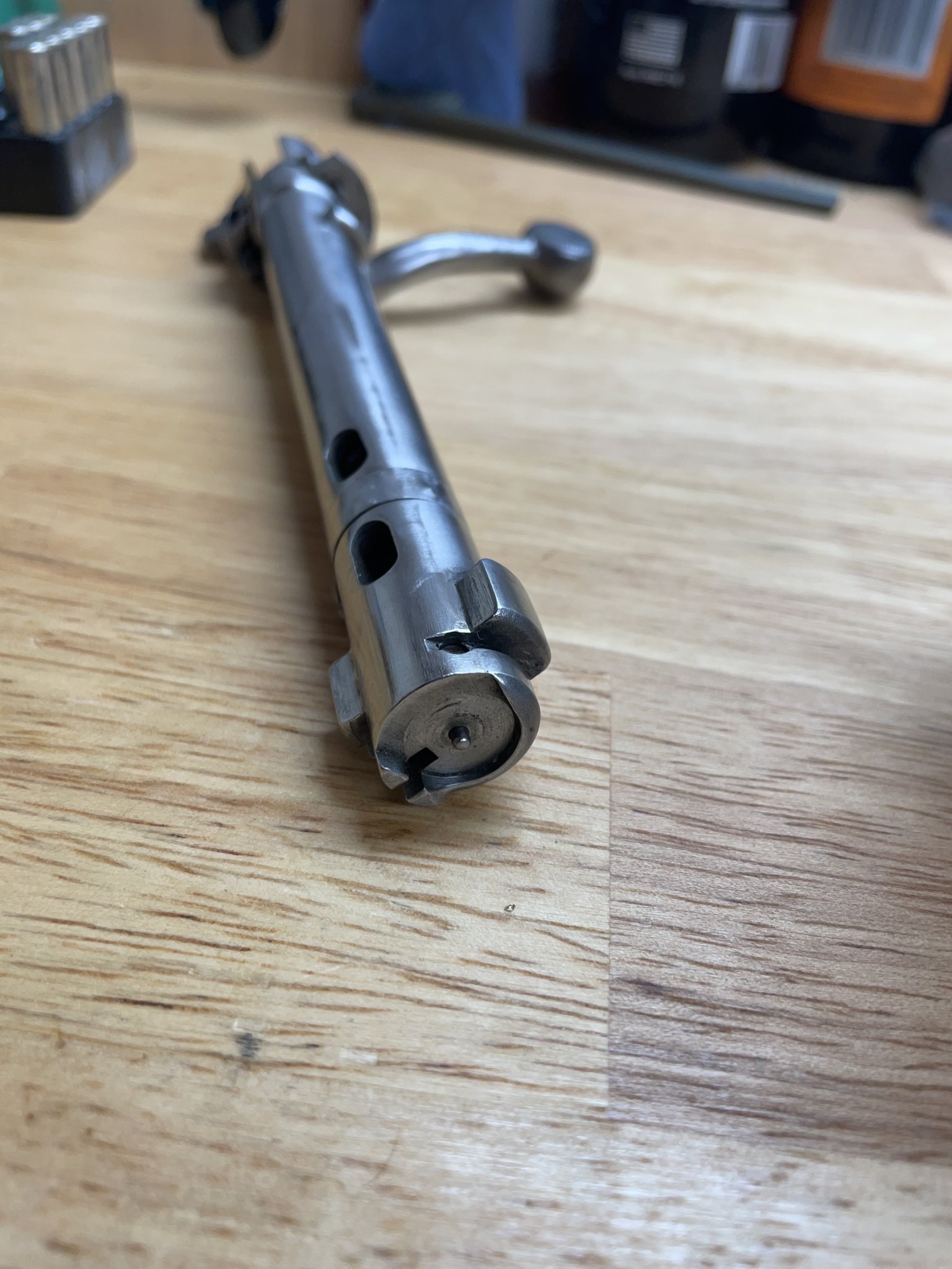

So, should I be able to unscrew the shroud in its current condition? Perhaps that is my problem, because it does want to move right now. Or in other words, does the firing pin have to be cocked?
Thank you for the help gentlemen.
You might have to press it in a bit further. I am not there so it is hard to tell. But it does need to be quite deliberate and must be fully depressed to clear the small notch that plunger engages in side of the bolt body. Keep in mind your shroud is under spring tension still so it might be a bit stiff to rotate. If you have a vise, use that to hold the bolt body and free up your hands to work.
Reactions: M_R_Woodard
That plunger keeps your bolt shroud from rotating unless it is fully depressed by being pressed against the receiver. That is one option. The firing pin has 2 wings on the front that might have corresponding recesses in the bolt but I don't know. If there is then that would lock up your bolt and I have no fucking clue how you would fix that. But I don't think that is the case.
However, I have never seen someone get the cocking piece off before disassembling the bolt, which shows a tendency to get frustrated and just say, fuck it, I'll try harder. Extra effort won't help you, then or now. Thinking everything through first will.

In your video you showed the inability to rotate the shroud and FP. No rotation is two fold. 1. shroud lock engaged to the back of the bolt.
2 without a cocking piece on the pin there's nothing pulling the FP back on rotation of the partial assembly and it's just hung up in the front of
of the FP boss and the block/pass shoulder design in the bolt.

This is very good advice. Once it was apart, I could see what the problem was. Many thanks to @MK20 for helping me resolve this. The washer would certainly have solved this.
It is curious that FN did not make an accommodation for this. Like @MK20 mentioned on the phone, a sacrifice for a two-position safety. But still...
