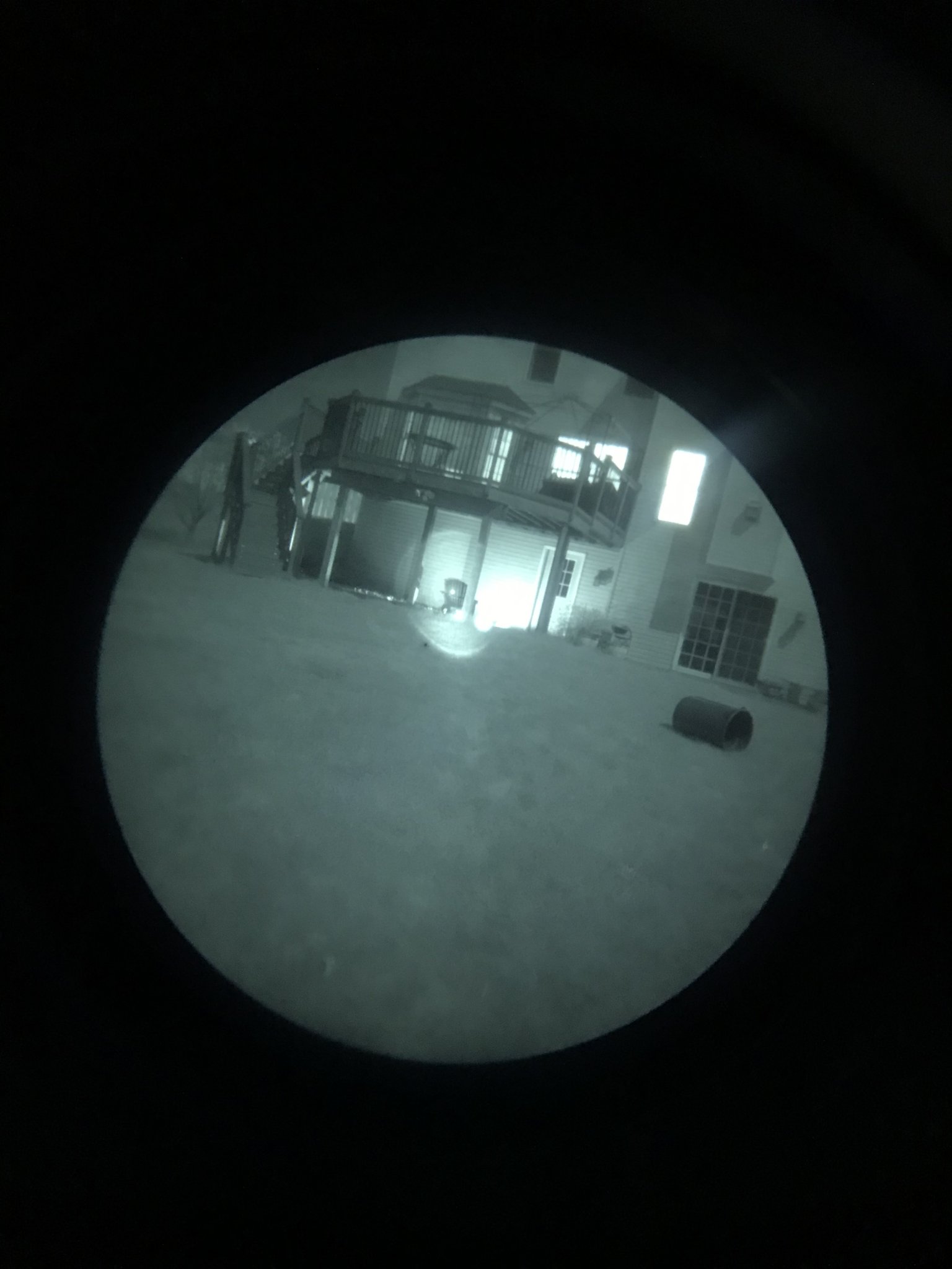

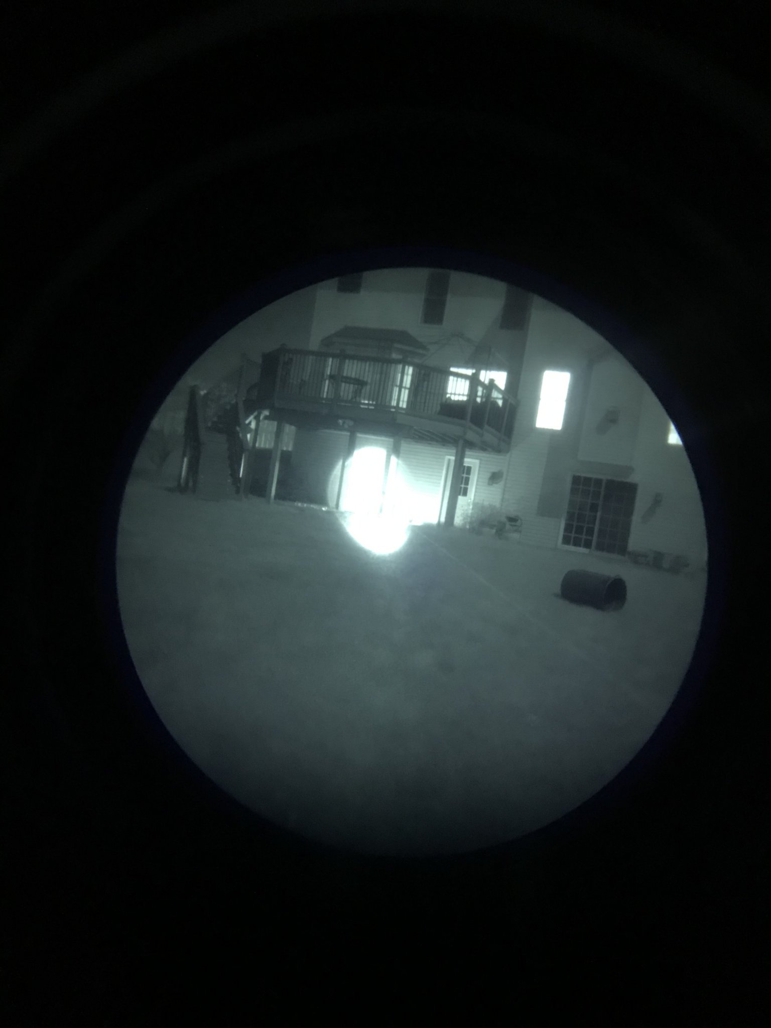

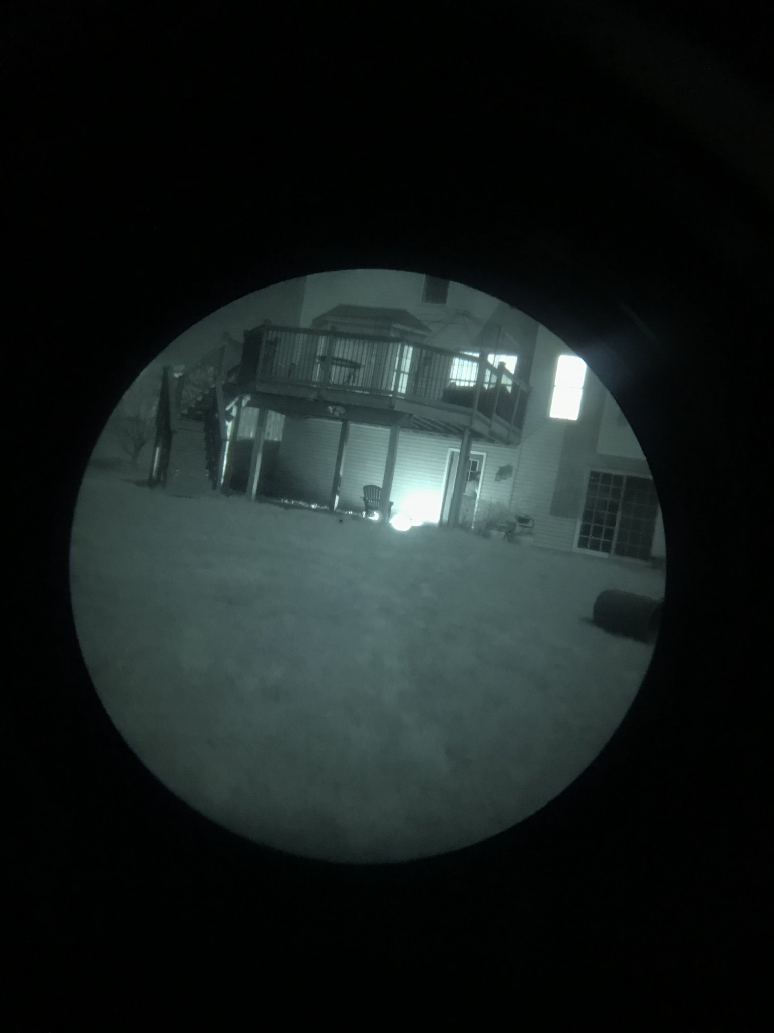

ETA: I'll post pics tonight if i can to demonstrate what i mean
So this isn’t a perfect example but it should demonstrate a bit what I mean. The target is the lawn chair at about 25 yards and there is a 500 lumen white light next to it on the ground. The chair is still easily visible due to the contrast with the house behind it but with a darker background, it would be more difficult due to shadows created by the flashlight.
The first pic is just the chair and the light.
The second is a peq15 on low power (3.5 MW) laser illuminator/pointer. The peq punches through the illumination from the flashlight and allows for more contrast between the chair and house, allowing you to see the target a little better.
The third pic is the peq on high power (40MW) laser illuminator/pointer. In the camera, it completely washes out the target and everything in the circle of the illuminator but it shows the power of the illuminator. In person, it washes out the flashlight completely and makes the target very clearly visible and identifiable.
Civ power laser based illuminators have a max output of <1 MW. The peq on low power is over 3x higher than that. The result in this a scenario, with high ambient light and a backlit target, would be that a civ power laser would not really provide much if any illumination on target. It would not be able to overpower the effects of ambient light and backlighting. In scenarios where there is minimal ambient light, a civ power laser would probably be ok out to 50-100 yards. But that’s about the extent of it.
