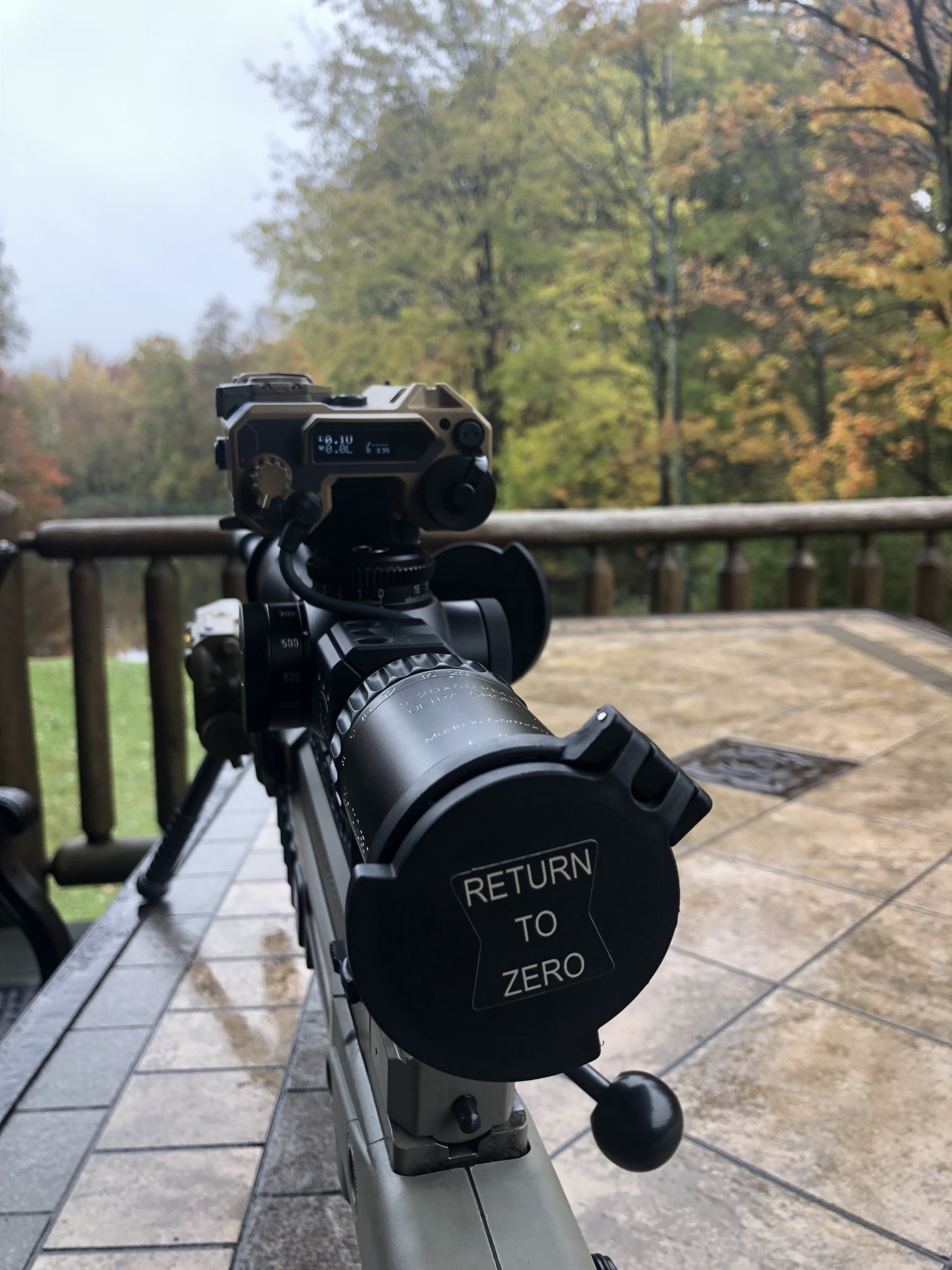

Here is exactly what you are asking for, weapon mountable
