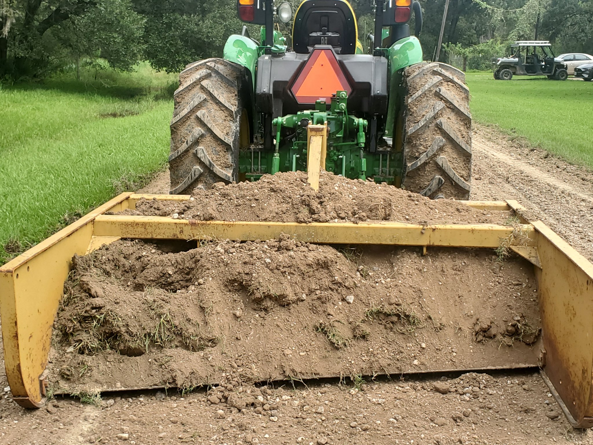

    I went in with my dad and brother on a deere 5075e and we maintain around 40 acres. I haven't complained about having too much machine one time. I'd urge you to go with a little more tractor than you think you need. If you're able to.
