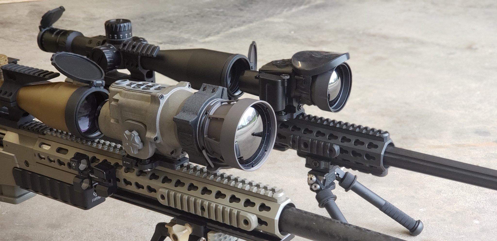

I feel that since these two optics are currently the pinnacle for LR DOD grade uncooled LWIR devices, that there should be a discussion on the strengths and limitations of each unit. Both are expensive units that are hard to get your hands on so I believe that getting out as much info on each is important.
LWTS-LR
The Good

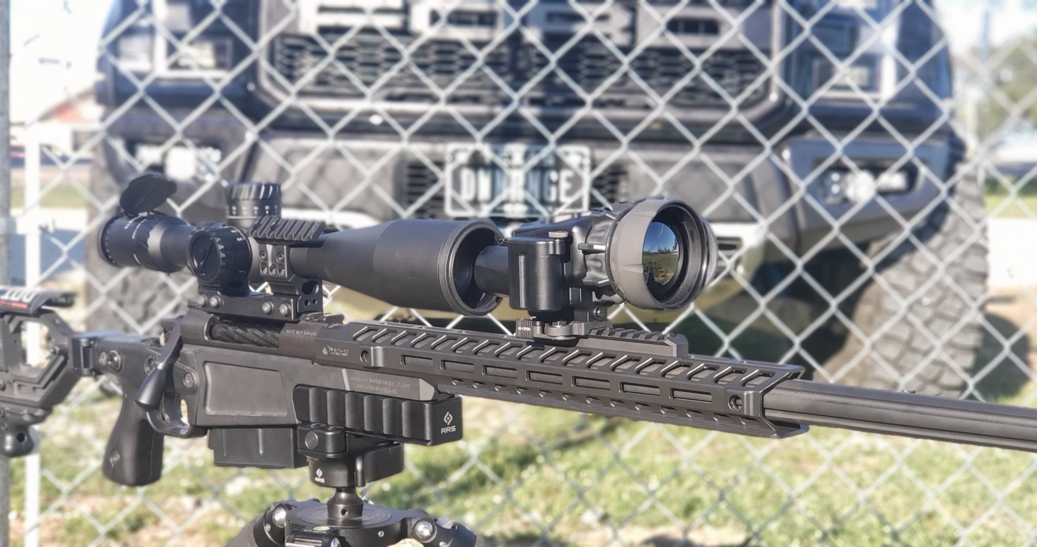

The best feature that the LR brings to the table is it's versatility. It is a true multi-use unit.
The LR is an outstanding stand alone unit with multiple reticles driven by mil-contracts. M24, M4 (simple crosshair dot), M107 MK19 etc that all range with magnification. Each reticle retains its zero profile so you can assign different rifles to particular reticles. Stadia lines for a man size target(easily converts to 4 legged creatures) are available on each screen. The scope features a unique approach to screen size/visibility ....when in stand alone mode the optic is @ a 2x "near FOV " When changed to clip on mode the unit reduces the video display by .5x while keeping the original full fov of the sensor. The net result is a 1x unity image on a reduced display ( more on this mode later). For stand alone weapon mount mode the available zoom levels are 2x NFOV, 4x WFOV and a 6x 3fov all of which stay incredibly clear under zoom( SEE VIDEO BELOW OF 2x 4x 6x). There is no other stand alone optic on the market I would pick up and use for a LR engagement before the LWTS-LR.
The buttons for most of the commonly used functions ( brightness gain polarity zoom) are external and have indexing features that allow you to access the correct one without looking. The menu is very straight forward and easy to navigate.
Non Uniform Calibration is either totally automatic or can be disabled / triggered manually. I really like the auto nuc feature when using a unit on a clip on with a larger day optic. Unless you have go go gadget monkey arms you’d have to come off of the rifle for a manual cover the lens NUC.

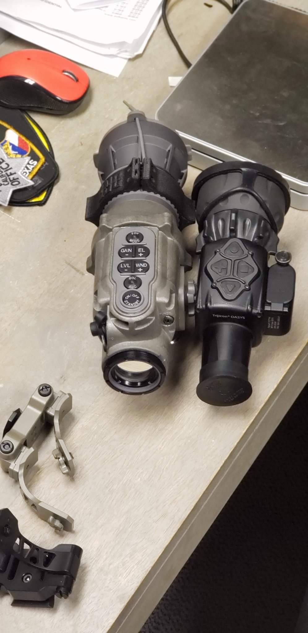

Eyepiece centerline height on the LR is 1.55 inches which is right in line with NV industry standard so most of you other clip ons 24,30 etc will be spot on as far as matching your day optic. (again some of the other optics are less sensitive to centerline height discrepancies but taking variables out of the equation is always a good thing)
The unit that I have been running for 6 months has been spot on as far as POI shift when running the optic in clip on mode. Most customers have reported the same.
50 cal rated unit that has an impressive run time. I’ve run the unit on 338 lapua and norma and never had it flinch.
The Ehhh
There are a few things that I’m kind of lukewarm about.

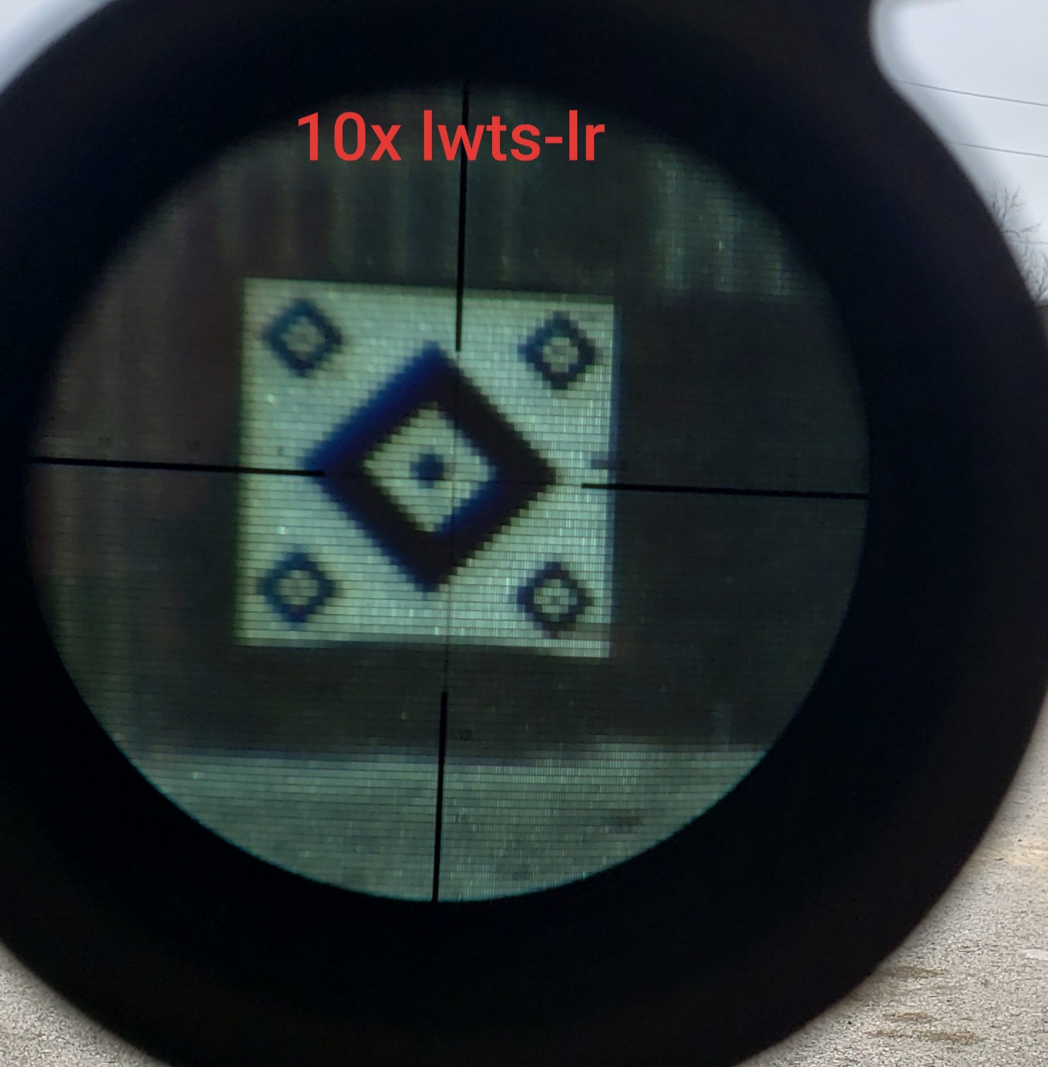

The focus control is extremely stiff on the LWTS-LR. Not helping the situation is the fact that the focus ring is a smallish diameter and there is nothing to grab. I fond it so difficult that I had custom throw levers made to mitigate the issue. The flip side is that you should never have the focus move under recoil etc and the manual says there is no need to adjust focus past 170 meters ( I’d say more like 300 in my use but there is a large sweet spot.)
Clip on mode is only usable for me up to around 10x. The display in my estimation is around 900 pixels horizontal so when the unit is switched to clip on mode the 640 sensor is sending that data to a 450ish pixel display. Still a very usable image on lower magnifications but the imaging leaves a lot to be desired beyond 7x or so. Detection range is nearly identical to the UTC but the display is the limitation in real world usage. I have had several customers tell me that they have used the LR up to 14x after ID to make successful kills on coyotes etc. To be fair the LWTS-LR was designed to be used in clip on mode with ACOGs up to 6x. Sometime when you are a jack of several trades certain modes can be limited.
The Ugly
30 hz units save on power consumption and there is a school of thought that they deliver a better image as 60hz is sometimes artificially overlaid…..I have seen different sides of the latter argument. I do think that there are far more benefits to have the option of 50 or 60 hz in dynamic environments. It would be nice to at least have the option between 30 and 60 like the UTC.

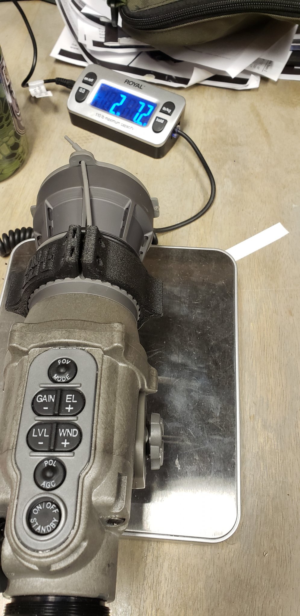

At well over thirty ounces the LR feels like it could be used as a striking weapon. It’s long size and heavy weight makes your heavy LR platform feel like an anvil and it is definitely a draw back to the unit.
Auto Gain Control seems to make the image less than Ideal for me under most instances. I’m always having to turn it off and adjust the manual gain.

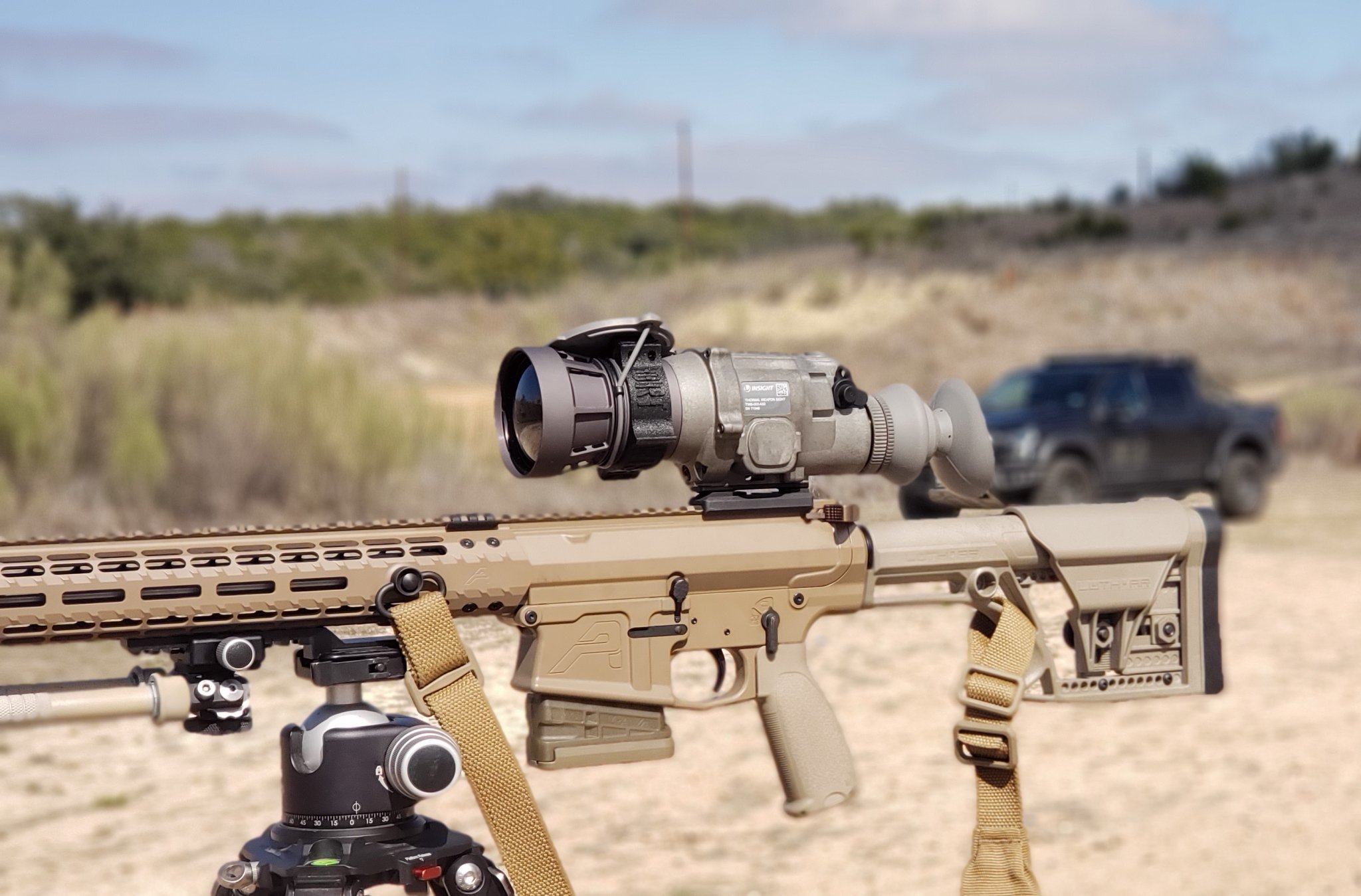

The Good

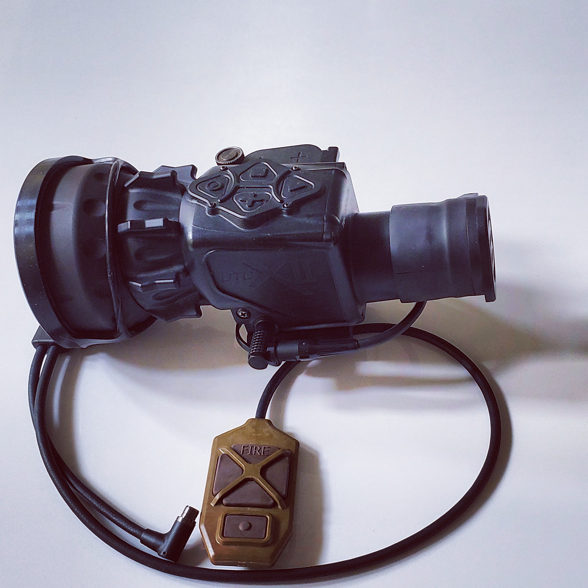

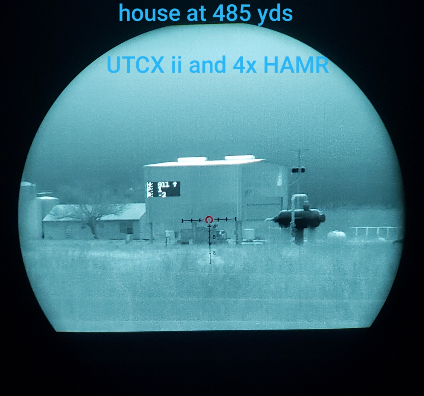

The image quality under day optic magnification is just unreal. The fact that the full display is used ( and reduced to 1x unity via rear eyepiece) to project a 6 degree FOV over a high res display puts a bunch of pixels on target. 16x DO mag is still extremely usable for ID and 20x for taking a shot is not a problem.
The UTC Xii is extremely small and lightweight due to having a 12 micron sensor and 2x battery compartment. It was the very first thing I noticed when playing with the optic. Barely bigger than a fist and almost the same size as the short range L3 CRATOS. The focus control is easy to turn but not too loose. … it has raised levers that are easy to grab. The size and weight make the UTC Xii feel at home on a lightweight AR or a 16 LB Accuracy International.
The UTC has the ability to change the refresh rate from 30 – 60 hz. I have found the best image quality with these units at 60 hz but it is nice to be able to change it for battery consumption. The UTC Xii ships with both a video cable and a USB/download cable that allows for an external USB power bank to be used for power.
I really like the ability to link to RAPTAR-S and the overlay of heading/pitch/roll you can turn on.

The reason they picked a 1.31 inch optical centerline is above my pay grade but I’m sure they had their reasons. Unfortunately I have found these units to be a little sensitive to aligning your day optic height wise. 1.5 is a several inch POI shift for me and 1.42 was about an inch. I do have a 1.34 inch spuhr I will test it on soon. The shift is repeatable but life would be easier as an end user if they made the UTC series at 1.5 inches like everything else. 1st world problems!
The menus are not bad but I do like the simplicity of the LR much better. I’m sure it can be changed but I’m constantly having the menu time out while trying to figure out what to select…..more time on unit will help that.

I've got UTC-x and LWTS-LR and concur with the vast bulk of DRTs comments.
I classify both of these units as "Long Distance Thermal Clipons" ... and these are the ONLY such units we can buy right now. So, if you want one, you'd better get moving. When I bought my UTC-x from a real OASYS dealer back in 2017, I might have bought the last one that was sold commercially as the OASYS program ended around Sept 2017 IIRC.
So since, then only the FLIR T75 really fit in to the LDTC space that we could buy. And I tried to buy some of those last fall and well er ... was unable to.
So as of now, there are just two such units available, the LR and the xii and we do not know if there will be more, for potentially YEARS, once these batches are gone.
Otherwise, I have made and will continue to make other comparison comments in my night shooting thread, so head over there if you want more details from this dummy !! :D

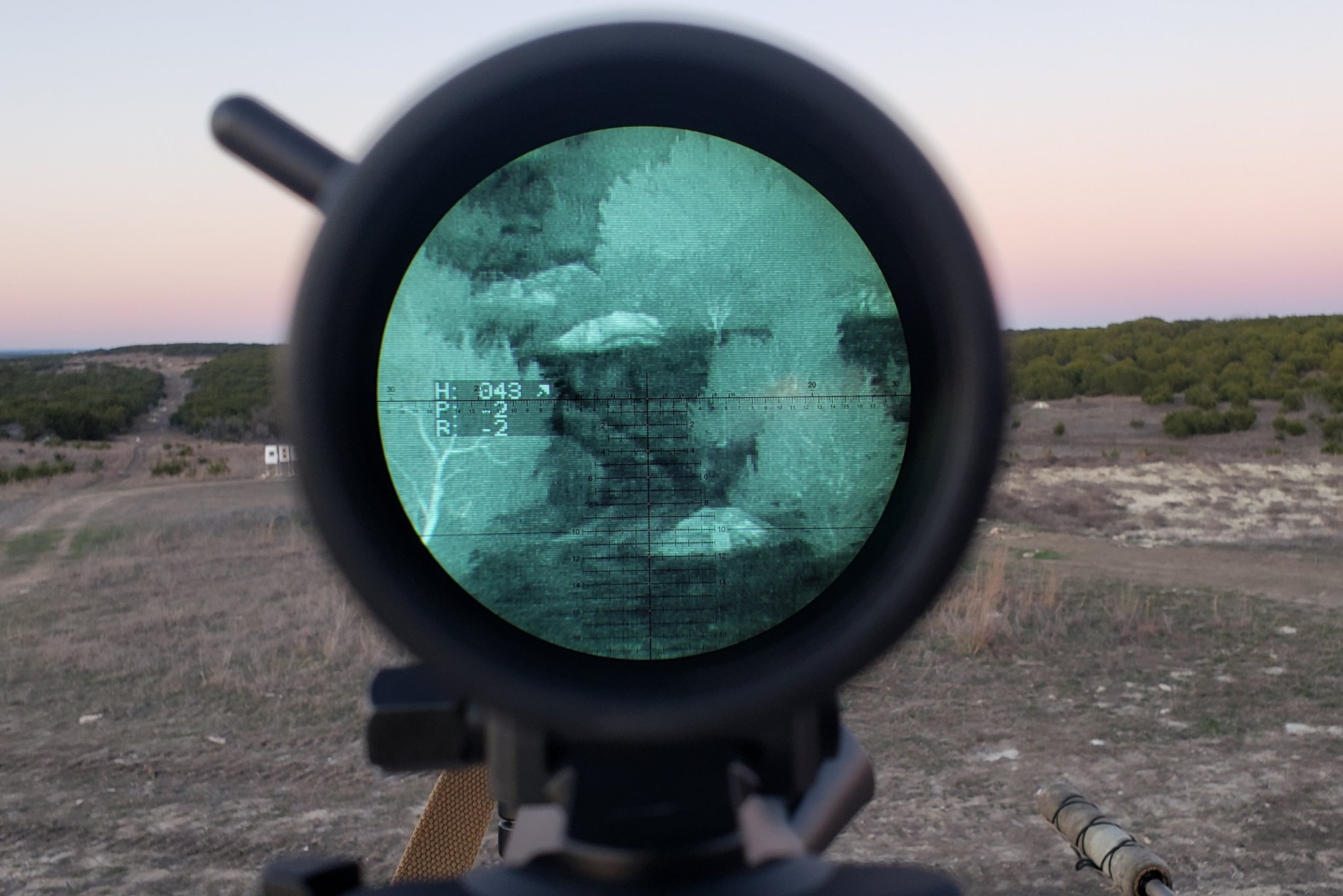

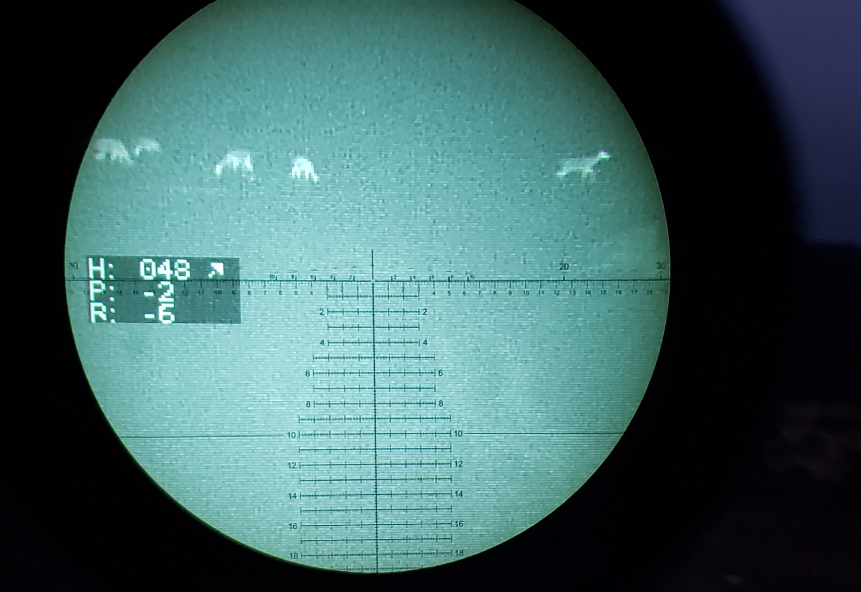

Went out with a newly built 6.5 grendel and the utcxii last night on a Texas hill country low fence property that has a large population of free range Aoudad. A medium sized ewe popped her head over the edge of a steep outcropping just a little too long. I didn't have time to refocus but the utc is pretty forgiving out past 150 or so. Sorry about the music overlay but these guys I'm with were dropping F Bombs all over the place so tried to keep it family friendly.

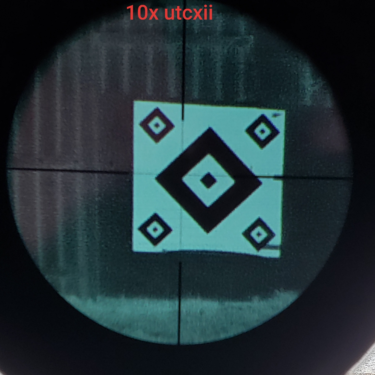

Of course everyone wants to know about the image, image, image I suspect. TBH, up to 10x ... I could hardly tell the difference ... after 10x ... the UTC starts fuzzing up ... but the x and xii keep truckin' on up to 16x ... The xii has a smaller lens (plus to the x) but the xii also has smaller pitch, which makes its lens effectively larger relative to the sensor. These two factors almost cancel out ... but in theory the xii still wins by a tad ... that said .. to find real world conditions where the primate mk1 eb could tell the difference is probably impossible ... and a larger lens physically is still a larger lens ... so in poor conditions ... that would matter also.
But for any real world shooting ... they are all dang close ...

BUT the image is extremely pixellated ... very dark solid lines between each pixel ... and thats instantly when you go into clipon mode ... and the magnification does not matter. Its the worst pixellation I've ever seen. Does that make it unusuable??? NO NO NO .. it is definitely usable .. but you have to ignore the pixellation ... it does not prevent PID of yotes out to 300yds but it makes it tougher and takes longer ... and I had a bunch of new born calves out there last winter .. .and they do a "bounce run" very similar to the yotes ... so I refused to shoot a "yote" outside 100yds ... as I wanted to be 5000% sure it was a yote ... killing a calf is $1000 ... can't afford that !!!
I was able to get 0.5 IPHY groups with the LR ... so nothing wrong with the precision capability ...
