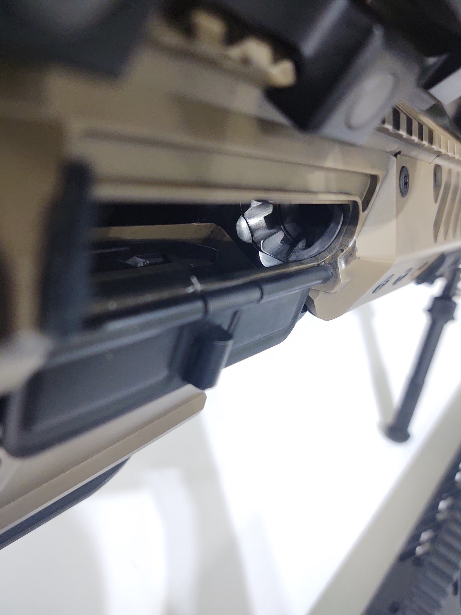

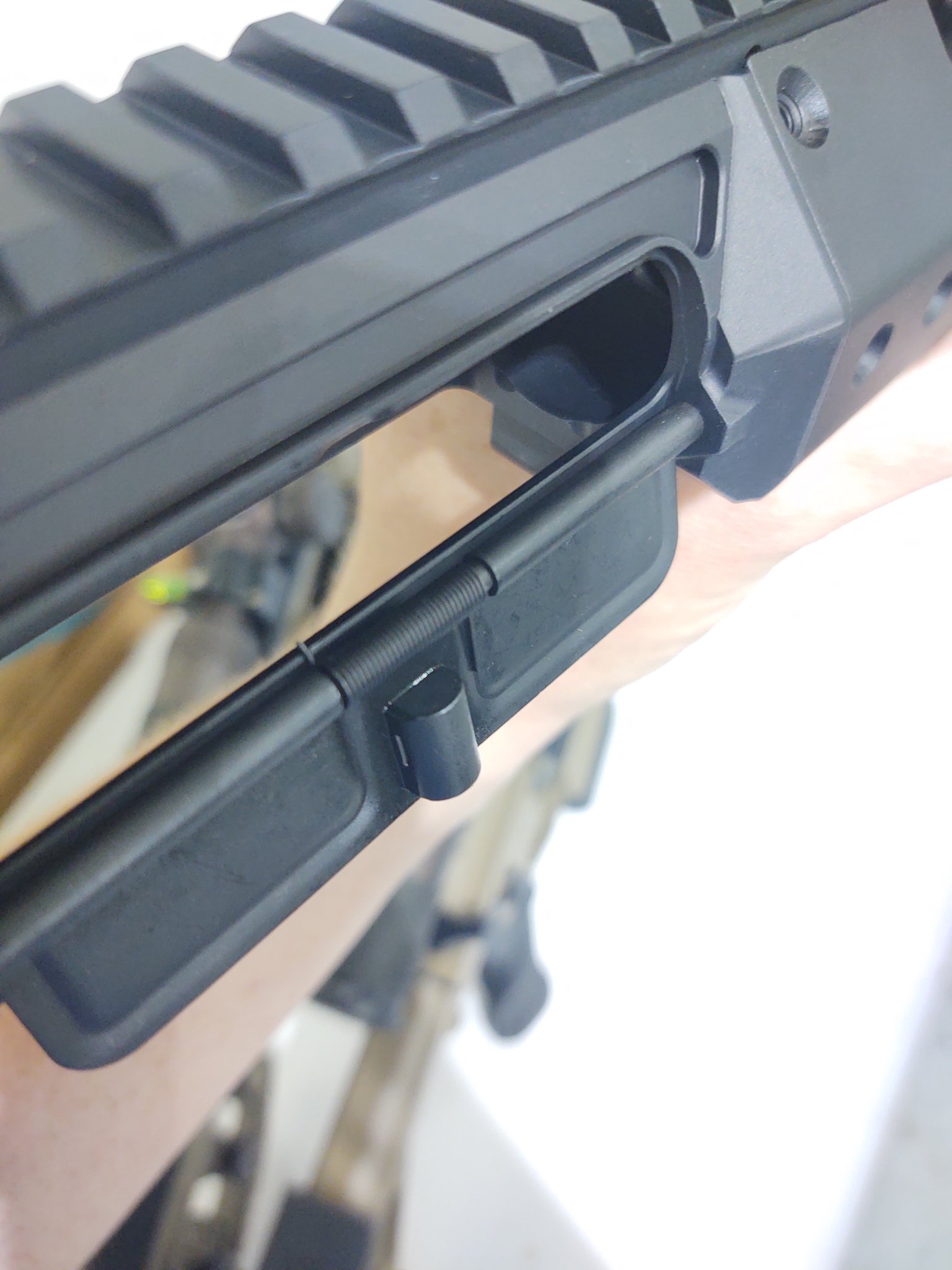

    Did any of your SP10s have problems chambering certain factory ammo? I had issues getting Berger factory ammo to chamber.
    The SP10 doesn't have M4 Feed Ramps, that was one of the first mods I made to my first rifle.
    Reactions: 232593 and rpoL98
    My SP10 and GAP-10 will not chamber Berger 140 Hybrids, they do good with Berger 130 AR Hybrids.
