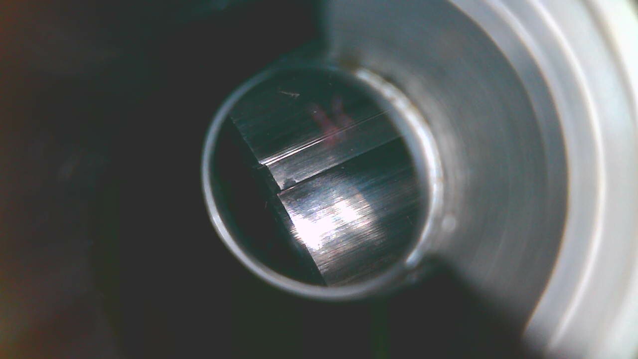

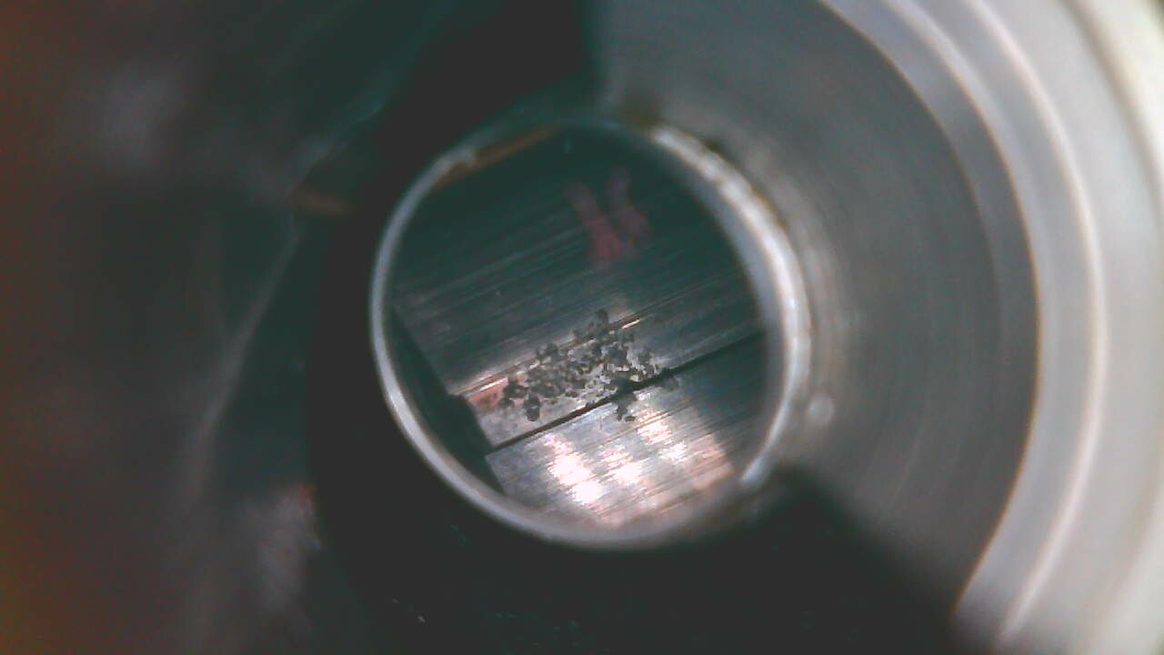

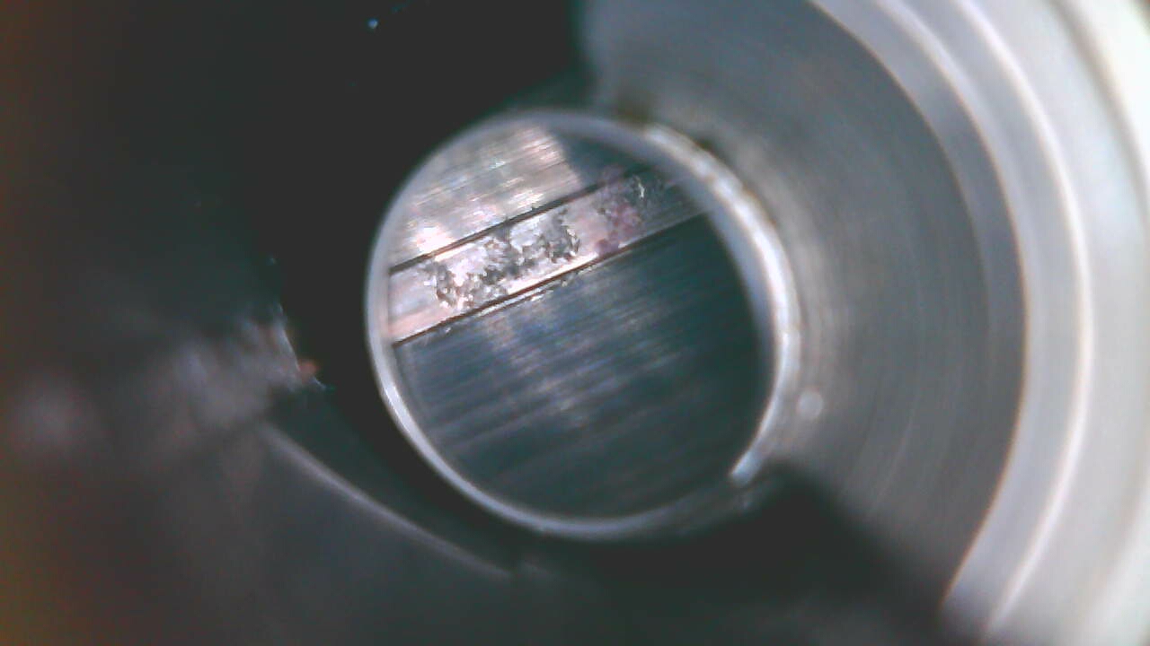

Just thought I’d share my experience with these guys. At the beginning of the year I ordered one of their uppers in 308. Was a 12 week wait, and anyone who’s ever ordered something like this can attest to, it was a long ass wait. Only good about the wait was that it gave me time to build out the lower. I’ll skip all lower details, it’s all the same quality stuff that everyone uses. The day finally arrives that I can get out to the range and start doing the barrel break-in that is recommended by Compass Lake. I wasn’t really shooting for group sizes during this procedure, but I was hoping to see some tight groups. That’s nothing like what was happening. I had multiple box’s of ammo from various manufacturers in weights ranging from 150 grain to 185 grain. Most of it was march grade ammo and all of it shot like shit. Best group I could get over 3 different range sessions was about a 1.125 group. The following group I shot with the exact same box of ammo opened up to 4". The biggest grouping I had with some Barnes match was about 10" So I called Compass Lake. We’ve all heard of good customer service, that isn’t even remotely what I got. I got OutFuckingstanding customer service! I spoke to Conrad, explained to him what was happening and he said to send it back and they will either fix the issue or replace the barrel. He shot it and basically got the same results that I did. So they turned another barrel and shot it, same thing. Seems as if they got a bad batch of barrels from Krieger. As they say, the third barrel is the charm. I couldn’t be happier with how things turned out. Throughout this whole process, Conrad always took the time to answer any questions, provide updates and express his dissatisfaction with the barrels as well. I’ll post some pics of the test groups that were sent to me, hopefully I can shoot half as good. If anyone is in the market for a quality upper backed by some OutFucking Standing customer service, give Compass Lake a call ! The first two groups were fired before fluting. The last group was shot after fluting to make sure that the fluting process didn’t screw anything up

I'm familiar with your upper, Conrad talked to me about it a few weeks ago. All I'm gonna say at this time is Bartlein, Bartlein, Bartlein!!!
I don't know what's going on with Krieger these days but hopefully they get thier shit together soon. I've got several Krieger barrels that are outstanding shooters but they're all probably from 2018-2020 time frame.
I've advised a few Krieger supporters recently who seem to be out of the loop with the hit or miss barrels from Krieger including @Defender3, hopefully they make the move over to Bartlein because there's nothing more frustrating then waiting for a high-end build just to have issues like those stated above.
Compass Lake absolutely has the best customer service and id strongly encouraged anyone who is planning a Custom build with a single point cut rifled barrel give them a call. There are several members on here who are using my barrel designs/specs that Paul has been turning for a few years now and all are having outstanding results that reflect my own Sub Half MOA results.

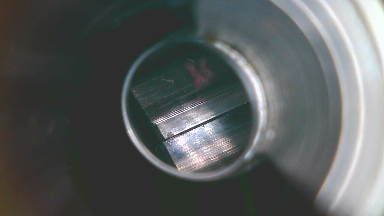

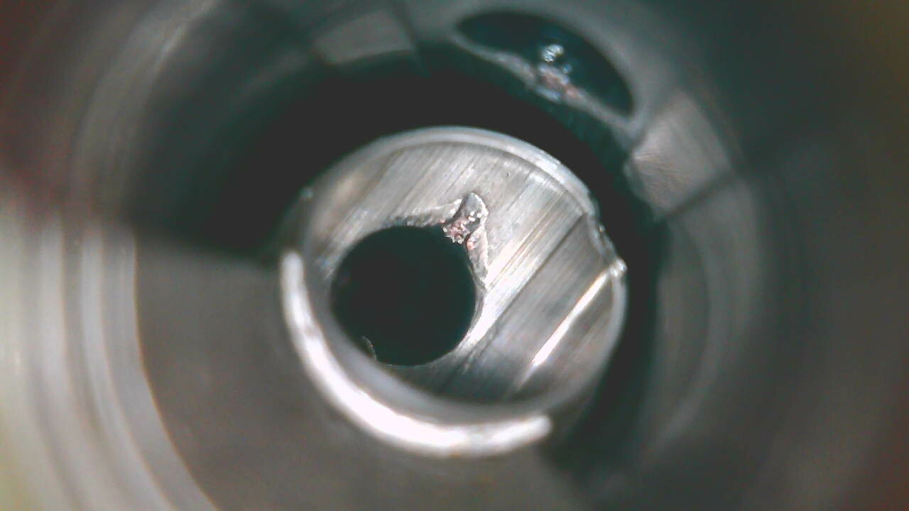

This is a perfect example of "Shit Happens"
This is from the latest LaRue .308 PredatOBR I'm rebarreling, with a barrel that had no sighs of neglect in anyway.
Barrels are only as good as the steel thier made of, and the issue the OP is having is a perfect example of that. For years Frank wouldn't make 18" Krieger barrels with Rifle Length Gas because 50% of them came back with advanced gas port erosion usually in less than 100rds.
