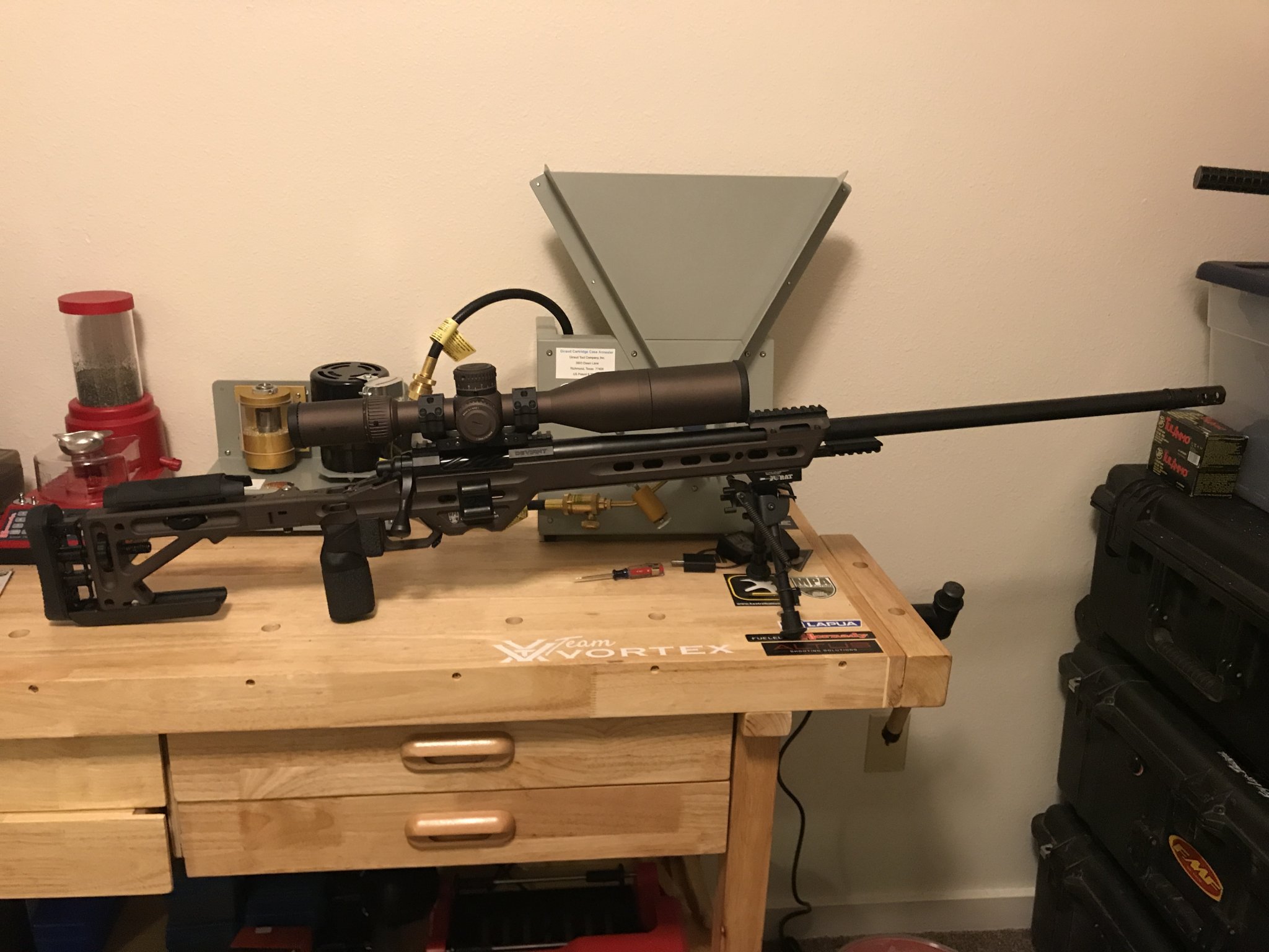

Just got my build complete for this years PRS series.
6mm Creedmoor
Deviant Tactical Action Nitrided
Bartlein Barrel: 28" Heavy Palma 1:7 twist with Surefire suppressor adapter
MPA BA Competition Chassis in Vortex Bronze and enhanced bag rider
Tiggertech Diamond Trigger
MPA Scope Base
Vortex Razor Gen II 4.5x27 EBR C 2
Harris HBRMS with MPA RAT adapter
Gunsmithing done by Charlie Robertson at Score High here in ABQ
Going to fire form brass tomorrow, ladder test Friday, Zero and dope Saturday and local match Sunday. We will see how she goes.

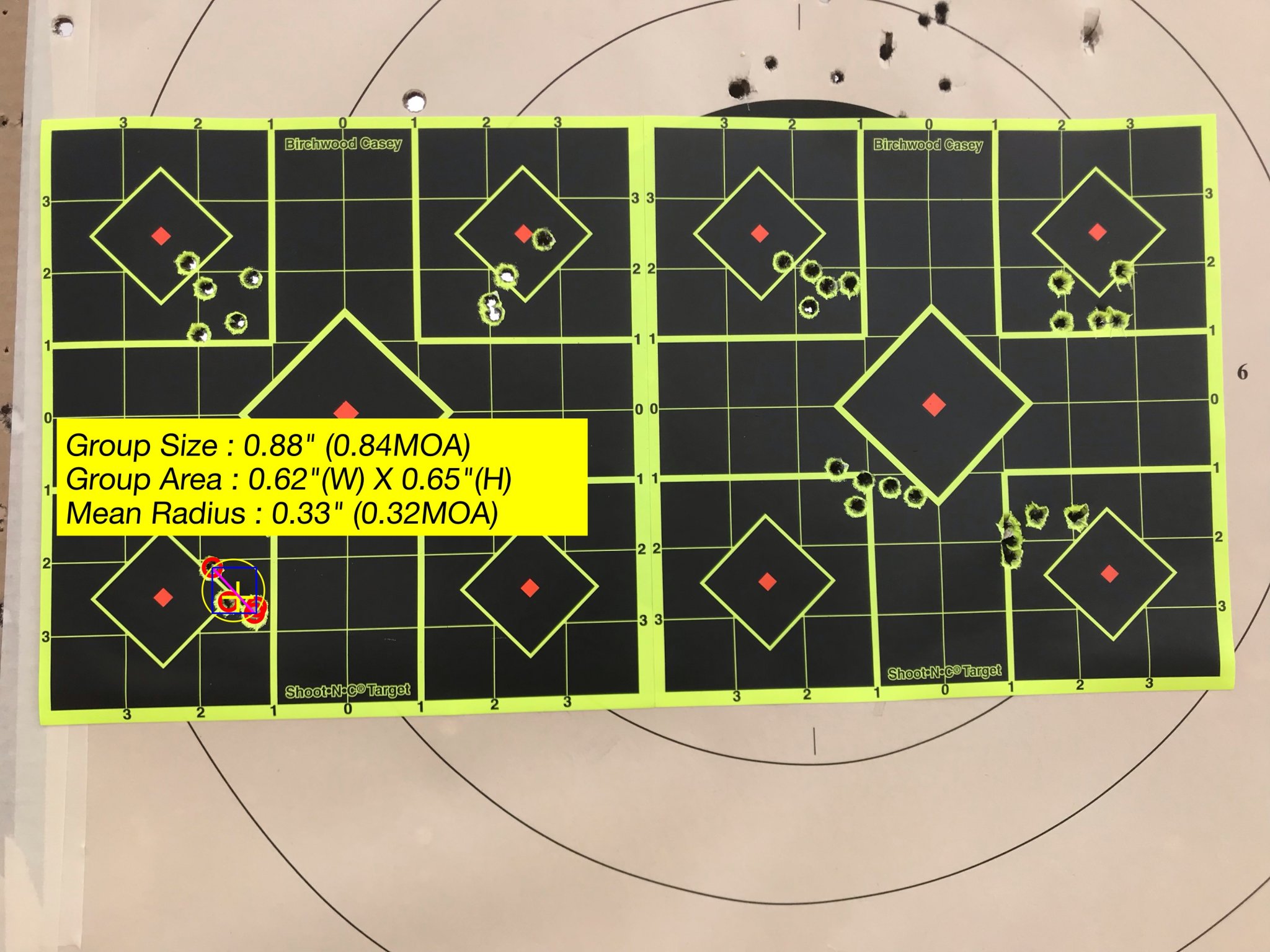

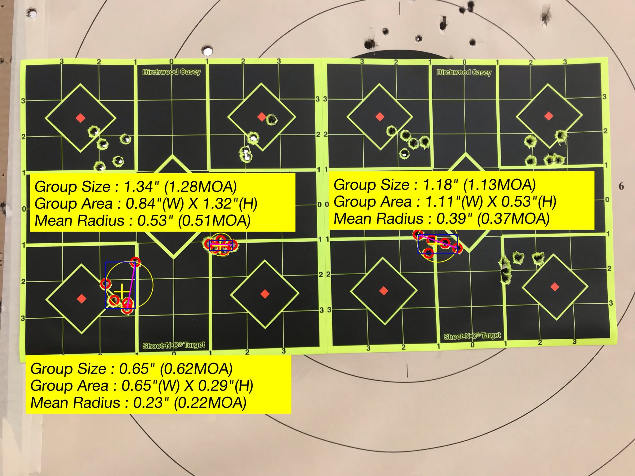

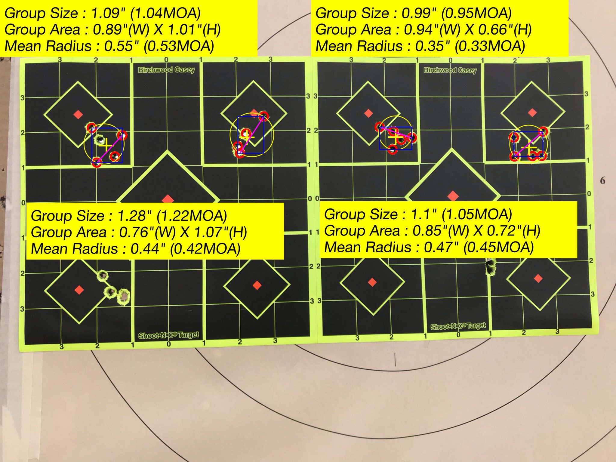

Alright, I did my modified OCW. Top left to right is 39.9 gr, 40.1 gr, 40.3 gr and 40.5 gr. The bottom row left to right is 40.7 gr, 40.9 gr and 41.1 gr. The far bottom right is another rifle. I think by load is going to be 40.9 gr. The ladder test had a drop in velocity there. I should be in a node as well. I am going to do one more test for load development tomorrow. I have been jumping 80 thou based on everything I have been reading on these 100 SMKs. I am going to load 40.9 at 80, 60, 40 and 20 thou for 5 shot groups and see if I can tighten up the group. I will load up 5 extra at 80 thou to run through the chrono and as foulers for the test.
Above is the left group below is the right group for each target

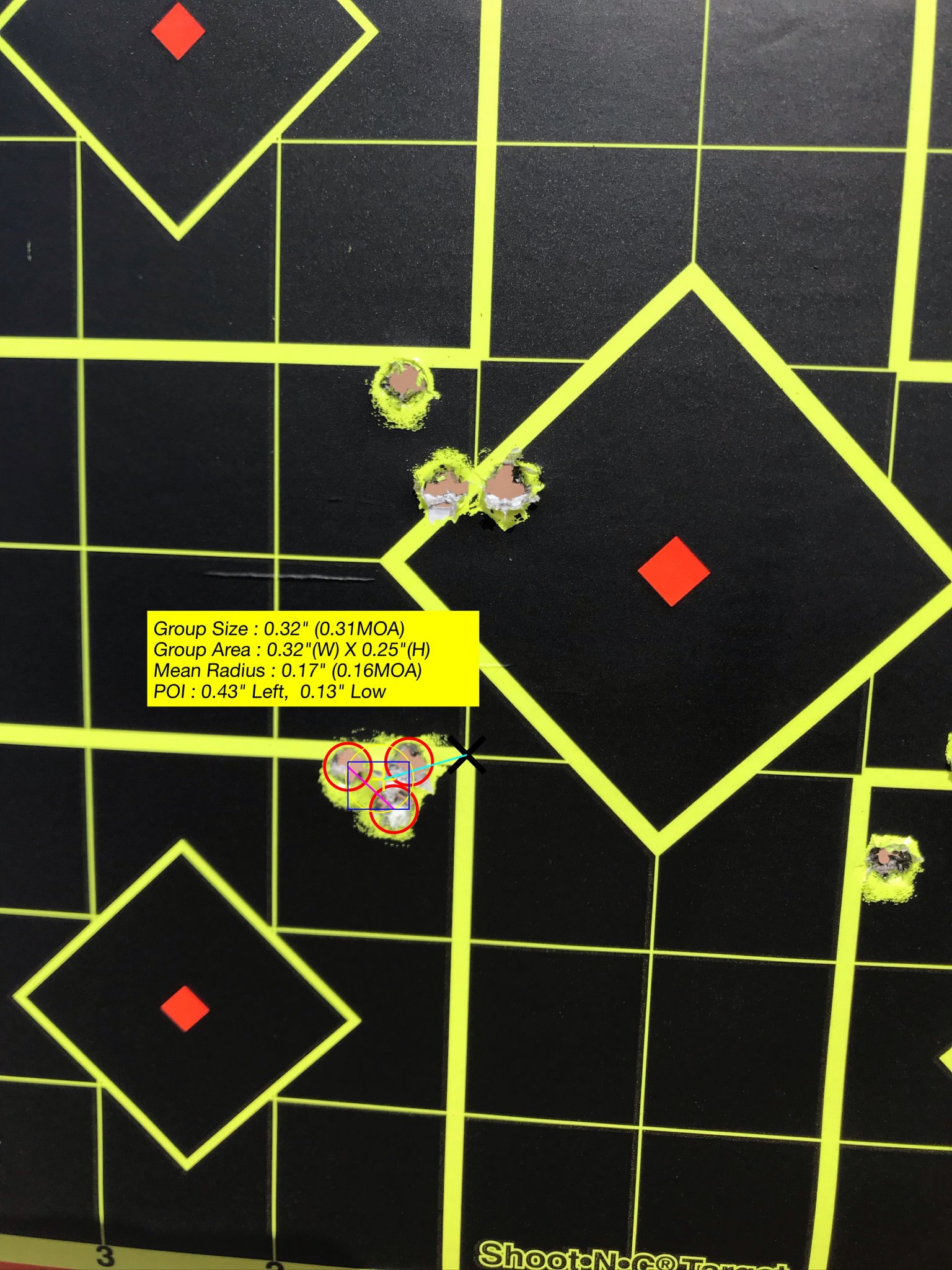

I have finished load development. I went and did a seating depth test and it was such a windy day that I was getting blown on the bench. This caused me to not get the best results. I lucked out and went with what I though was the best. I ended up only working a three shot group for the picture but it is holding this grouping with 5 shot groups as well. I went with 60 thou off the lands then chrono'd and zeroed. 40.9 gr of 4350 3.3 SD at 3121 FPS.
