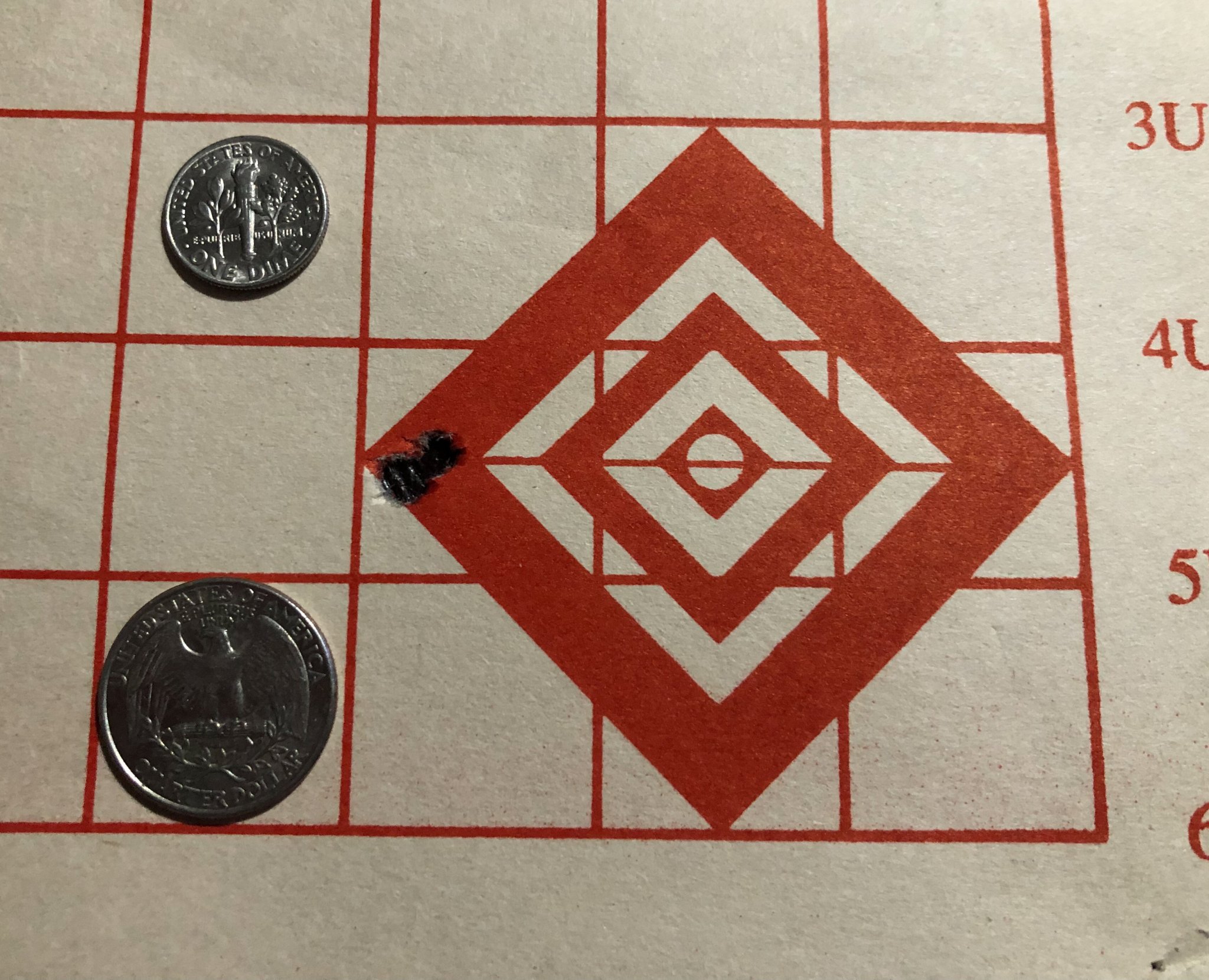

I’m actually curious what groups look like from a precision AR that someone shoots “free recoil”.
I’ve always been under the impression that you can shoot a bolt gun, but you drive an AR.
I've put some time into testing it. You can do okay, not great, with a heavy gun in 223. A lighter gun or heavier caliber and it all goes to shit fast.

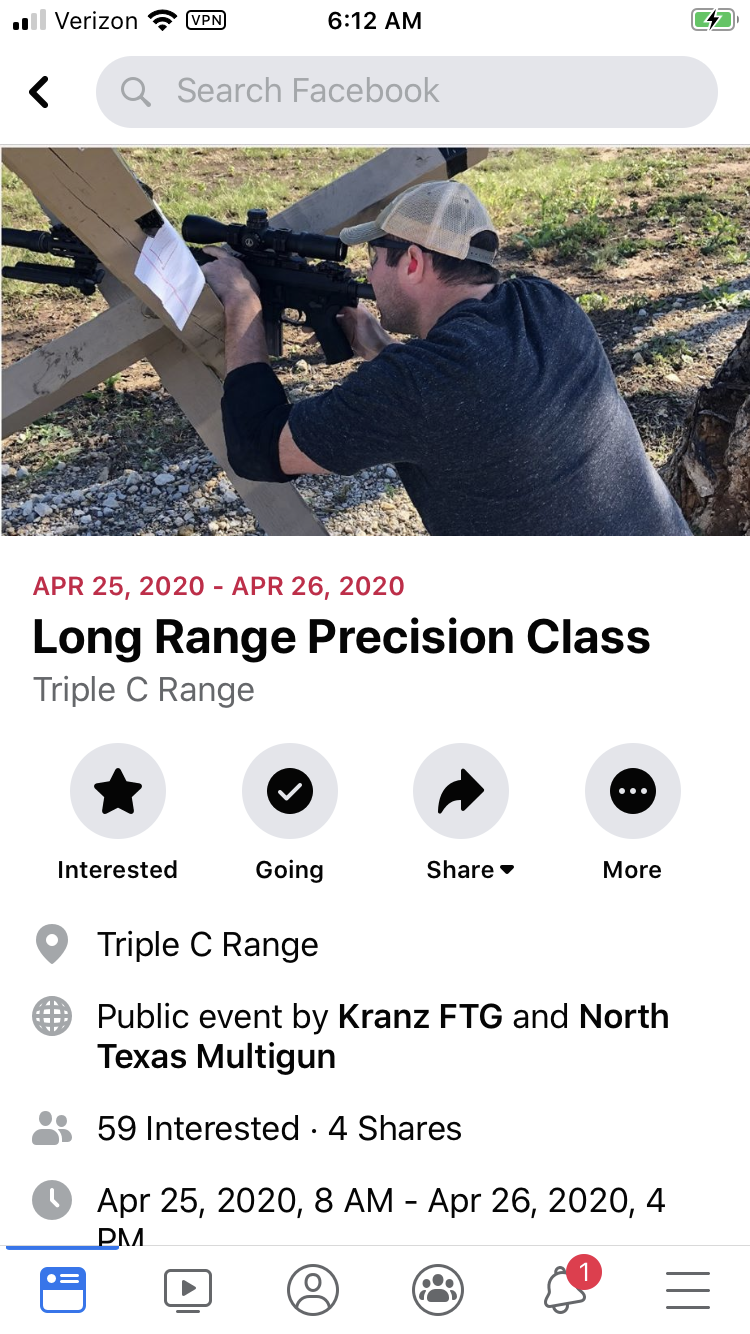

Here is a photo of how we free recoil in DFW. That’s a bolt gun in the photo but the guy who runs the club taught me to do the same with a gas gun. The thumb of the right hand is resting on the right side of the rifle, and the tips of the ring and middle fingers apply pressure to the front of the grip, pulling the rifle into the shoulder. In prone position, the left hand would be squeezing a rear bag, and not contact the rifle at all. I see everyone shooting this way, including gas guns.
That seems to be simply not utilizing the thumb to wrap around the grip. It isn’t “free recoil” like is done in certain disciplines.
This is what I mean by my not understanding what is being said here.
I shoot my AR65 gripped like this but the rifle is not allowed to simply move how it wants under recoil like a well designed benchrest rifle does.
Too much additional movement is involved.
That’s my take away as well. That isn’t what I would call free recoil at all.
