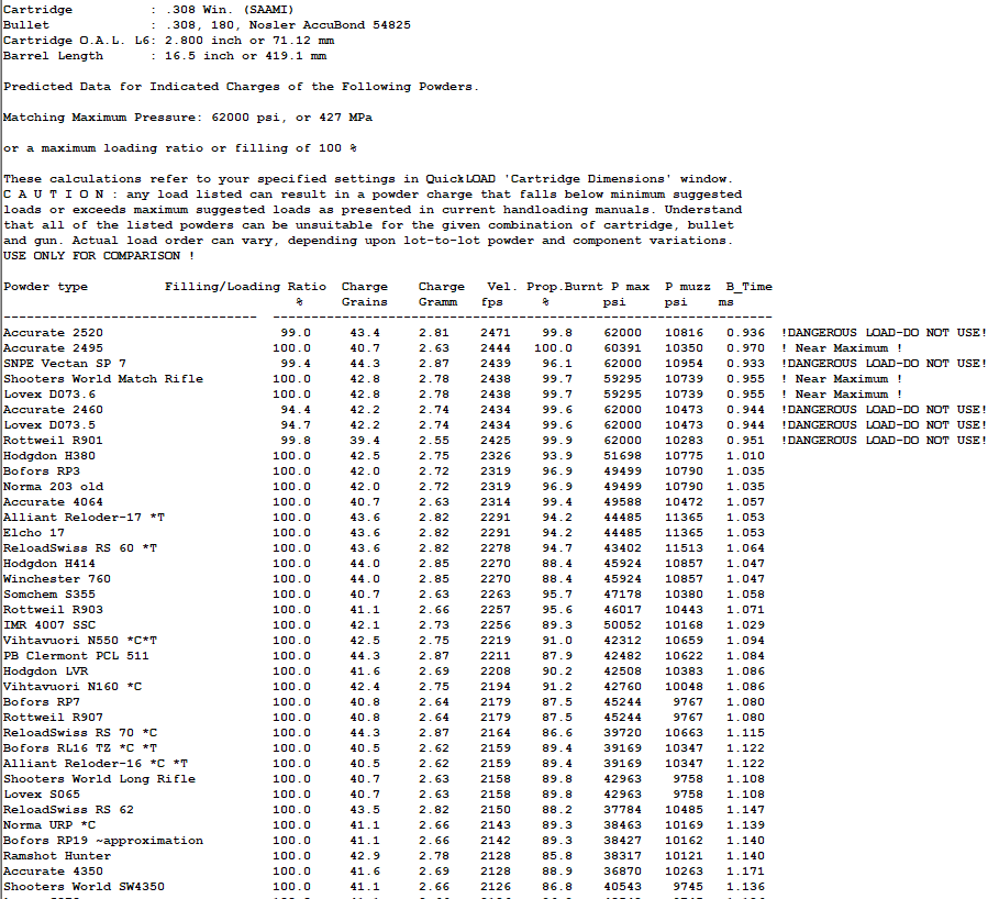

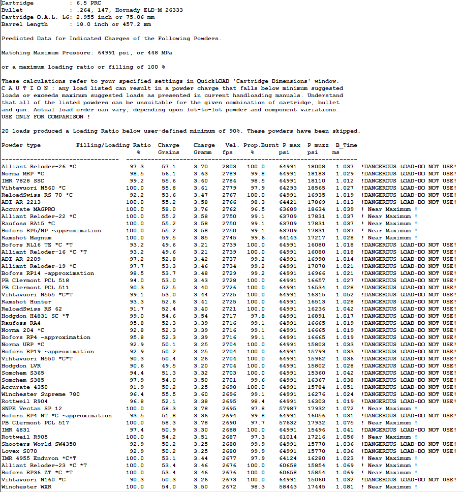

@Nivium tell me which bullets you plan to shoot for each cartridge and I'll run numbers in Quickload to tell you some good powder candidates. Maybe there's a powder that shows up on both lists?

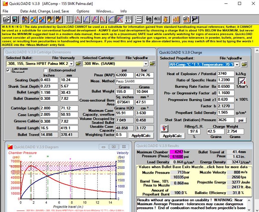

Don't know what your shooting out of your 16.5" .308, but here what my lot of AR-Comp can produce with 155 SMK Palma's:
Reactions: Nivium
Much appreciated. For 308, I've been a 165 grain accubond guy for a few years, but I'm just now restocking everything and thinking about shifting to one extreme. In a 16.5 inch barrel, I think I'm most efficient to use a heavy like the 180 SST with a fast-ish burning powder. That, or I could jump down to the 150s with a fast powder and get a bit more velocity back. Need to be able to comfortably hunt at 350 yards and in, with some big black bear on the menu but nothing bigger.
Same issue with the 6.5 PRC. I run 147 ELD-Ms, but have considered switching to the lightweight hammer hunters for more velocity. Still thinking it's most efficient to go 147 or 156 berger with a fast-ish powder suited to the shorter barrel.
Any thoughts on bullet weight for my next order? Thanks again
100% gonna need to shoot heavies from the 308 and load them way out.
555 or 560 would be where i'd start in that case
This is what I'm thinking. 180 grains out of the 16.5" shouldn't be significantly slower than the same bullet in a 20 inch with the right powder for the shorter barrel.

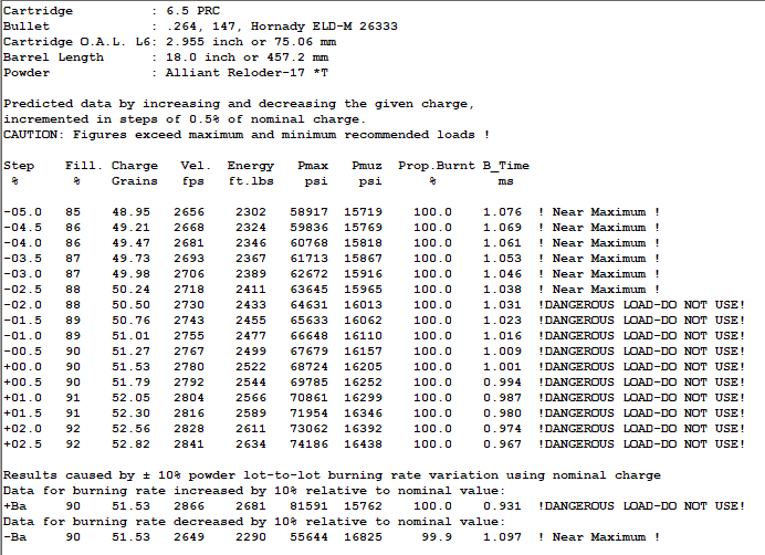

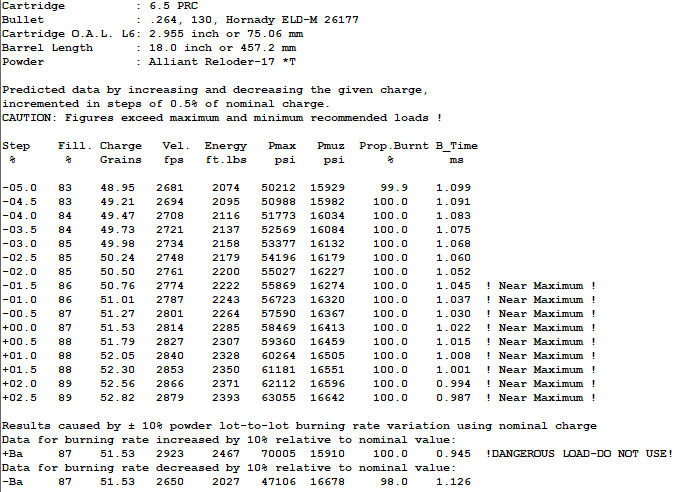

So as expected, there's no real obvious powder that would work well in both cartridges. You're just not going to be anywhere near optimized with a single powder, though an argument could be made for RL17 in both, but it's fairly anemic in the .3o8WIN and a bit hot in the 6.5PRC.
I did some comparisons and even tried a lighter 130gr bullet to see if RL17 would work, but you're still getting sub-par performance out of both.
16.5" .308WIN w/165 Accubond
16.5" .308WIN w/180 Accubond
18" 6.5PRC w/147 ELD-M
18" 6.5PRC w/147 ELD-M using RL17
18" 6.5PRC w/130 ELD-M using RL17
