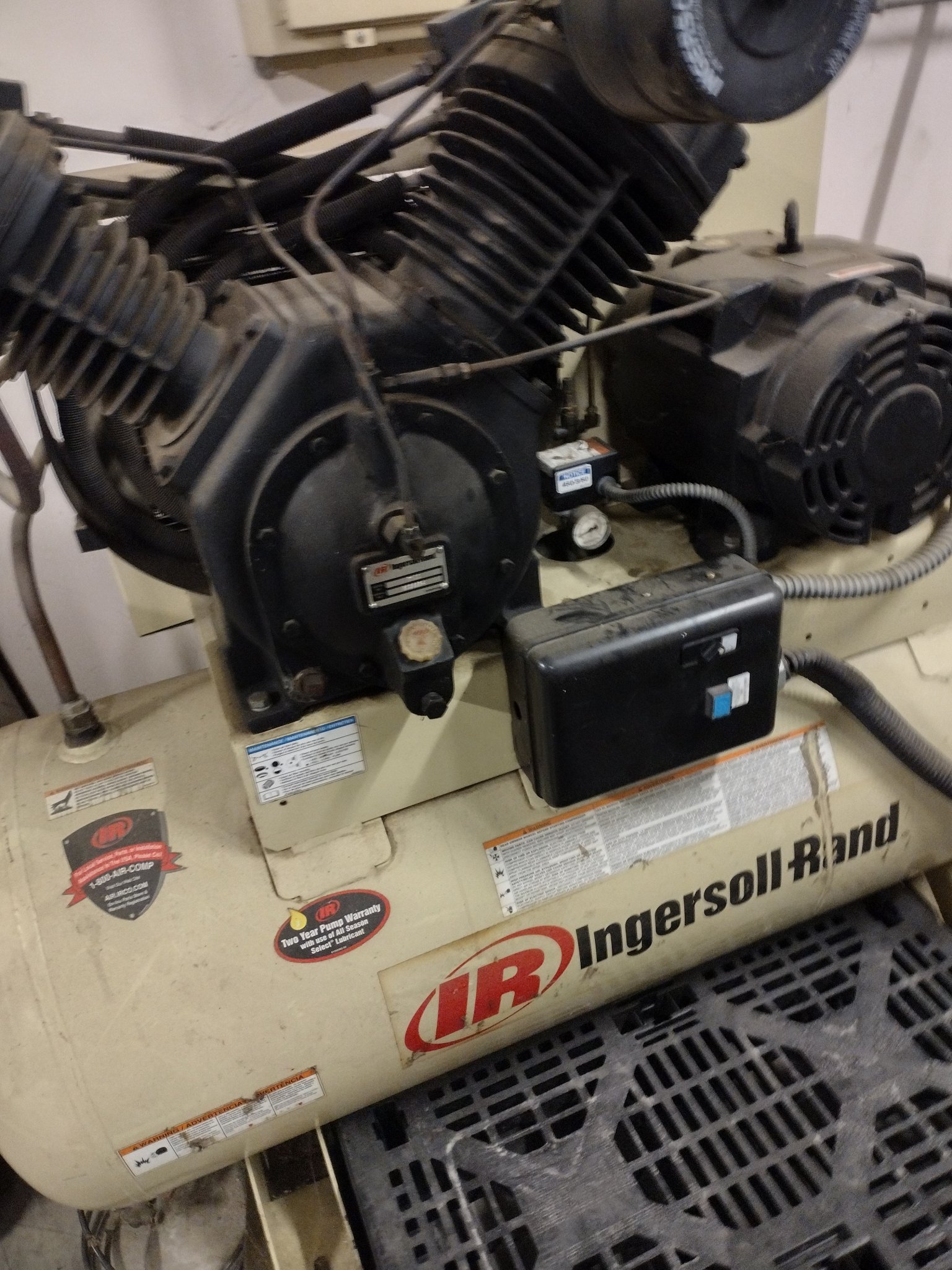

    The 210v 5hp compressor motor on my Ingersol shit the bed and I’m having a hell of a time finding a replacement. Any ideas of where to look? Tried Grainger but no luck.

    Any idea what went wrong with the motor? First thing I'd check would be start/run capacitors
    This!
    I've had our big Compressor 'stop' on lots of occasions. And it's never the motor. It was always the points on the pressure switch or the capacitors.
    Also, if your compressor is in a 'cold' area (mine is in the unheated barn attic)... when it gets really cold, the motor trips as the compressor is too cold to turn (oil thickens up.) So we wrap the compressor in heat tape for the winter and it runs like a charm.
    Before assuming the motor is bad... it's often the starting components.

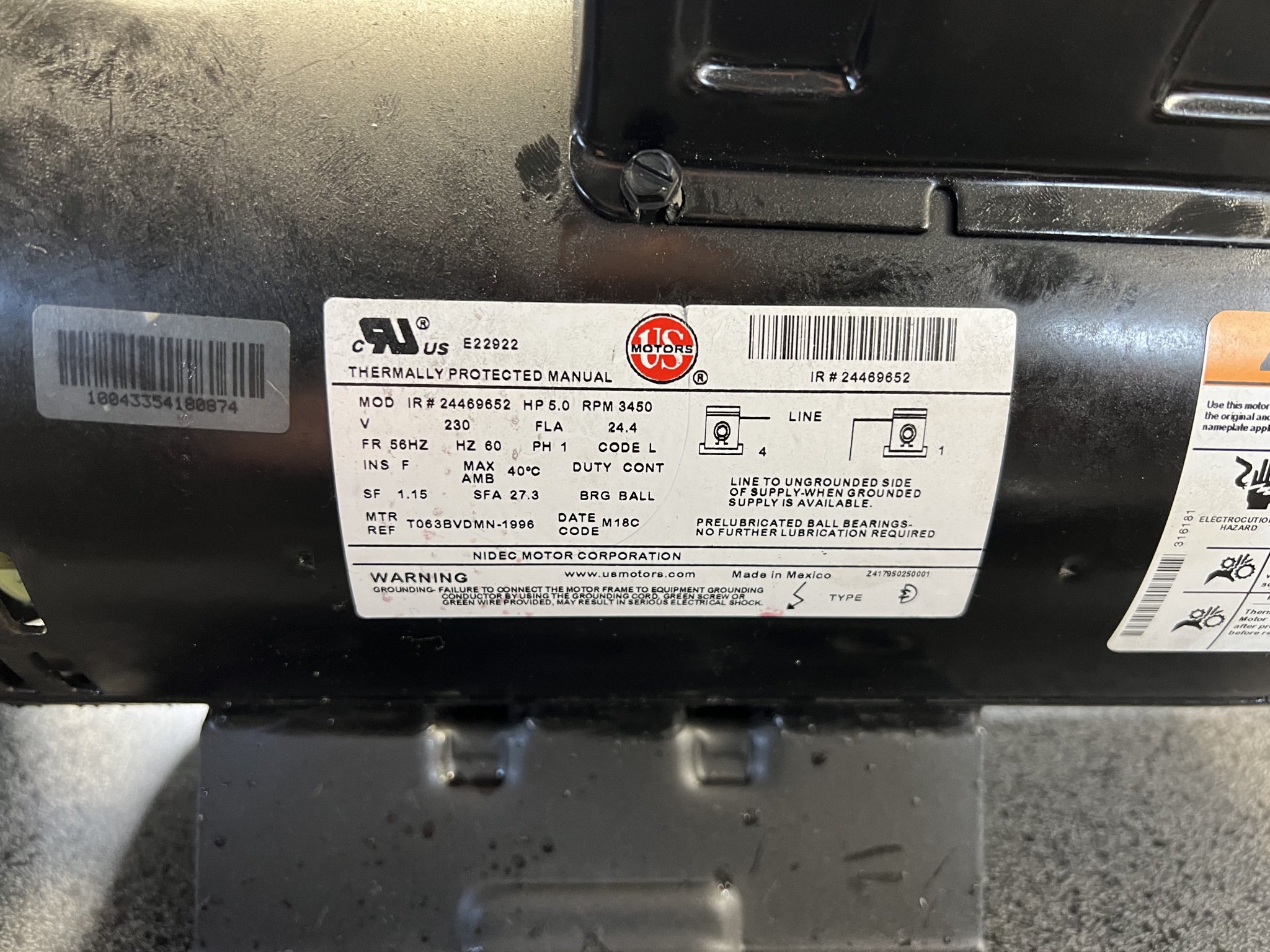

    Well it smelled like an electrical fire the last time I kicked it on. It was running but sounded strange. Got hot and started smoking.View attachment 8011320
    When the magic blue smoke gets out it's done. Most old motor shops can't rewind one as cheap as buying a new replacement, which won't be as good as a rewound one. If you go the Harbor freight route, be sure to buy the extended warranty! I've had good luck with their sump pumps, 35 years in the pool business.
    Rewinding is very expensive. I had a motor rewound a year ago as I wanted to keep it but for most standard motors in the single digit HP range it’s often cheaper to replace.
    Being in industrial maintenance we do still have a shop in Dothan; Alabama electric, that we'll take larger hp motors in to be rewound on occasion. Years ago Robbins electric would do our pool pump motors until it became cheaper to replace them, they went out of business because of that.
