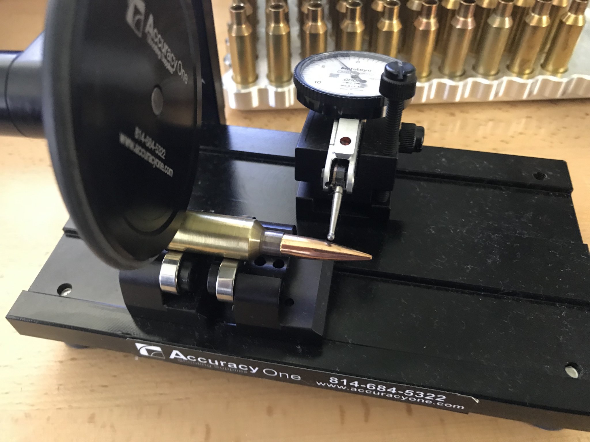

I shoot benchrest and use the Accuracy One to final check and sort my match ammo
I'm super anal about my reloading and I do suffer from reloading OCD
Reactions: CanSniper
