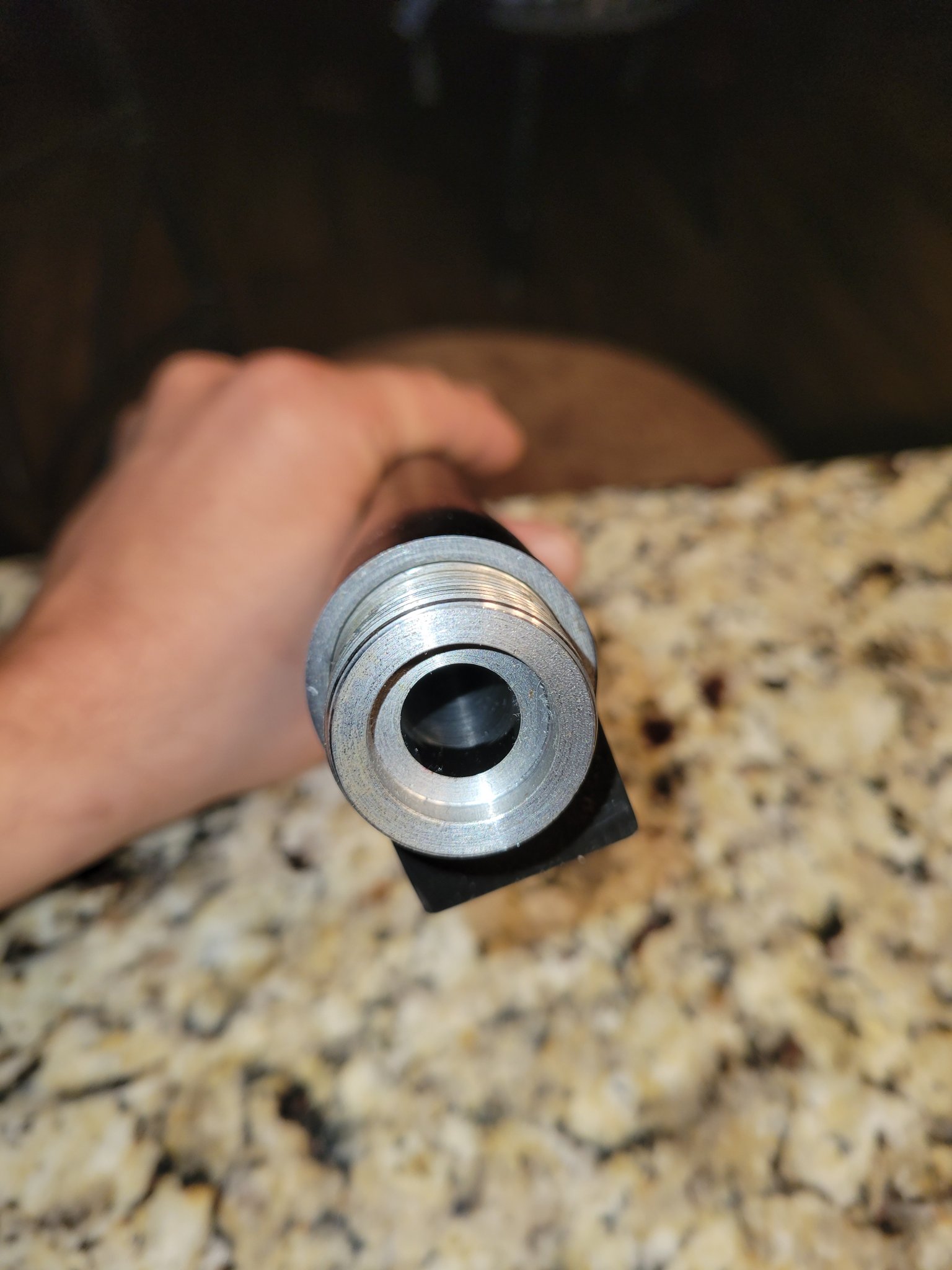

I had a 243 (factory rifle) that wouldn't shoot under 3/4" no matter what I loaded for it. So talking to my gunsmith he told me to bring some of my loaded anmo and fired cases over to look at.
He rolled my loaded ammo on his concentricity guage and the worst of the bunch was .003" out. The fired cases told the real story. The fired cases showed the chamber was not concentric to the bore.
We tried to clean it up with an ai reamer be it was too bad out of whack so the action was trued up and I've got to decide if I want another 6mm barrel or if I want to build a 7-08. I really want to try a 6bra but I've got no dies or brass and I've got a pile of 243 stuff already so...
Pic of bad chamber after we tried to clean it up. The guages have their place.
Reactions: Feniks Technologies
Wooow. Thats bad. Years ago i had a customer piss and moan about my screwing up his 22-250 barrel. Long story short, his dies were the issue. 5000+ reloads on them and they were bending his brass like a banana. I used my dies to "fix" the brass he supplied. I did the whole thing on video, he still didnt believe me. Some customers are no-brain drop kicks.

Runout gauges are better used finding problems such as the barrel above, or issues with your dies.
They are far less valuable predicting if your ammo is going to perform or not.
