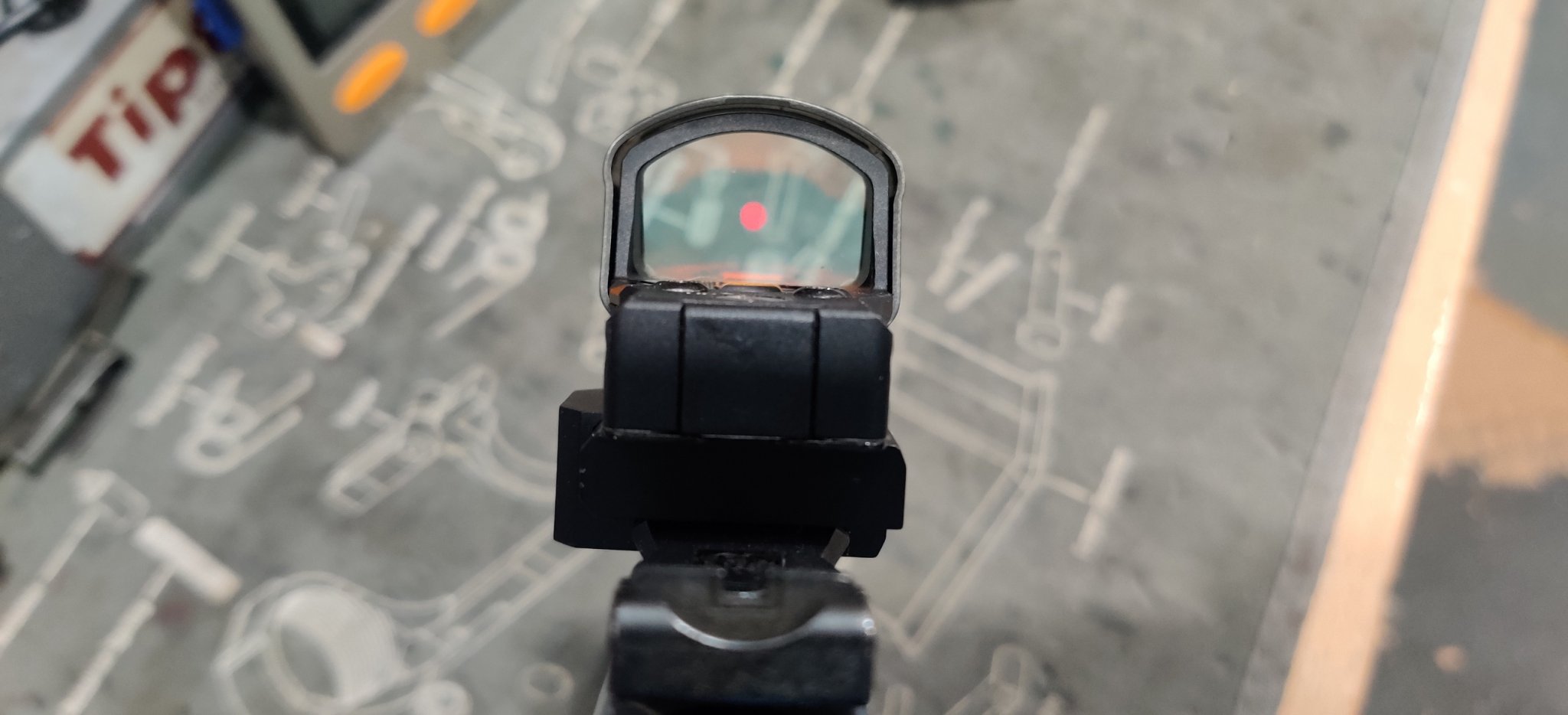

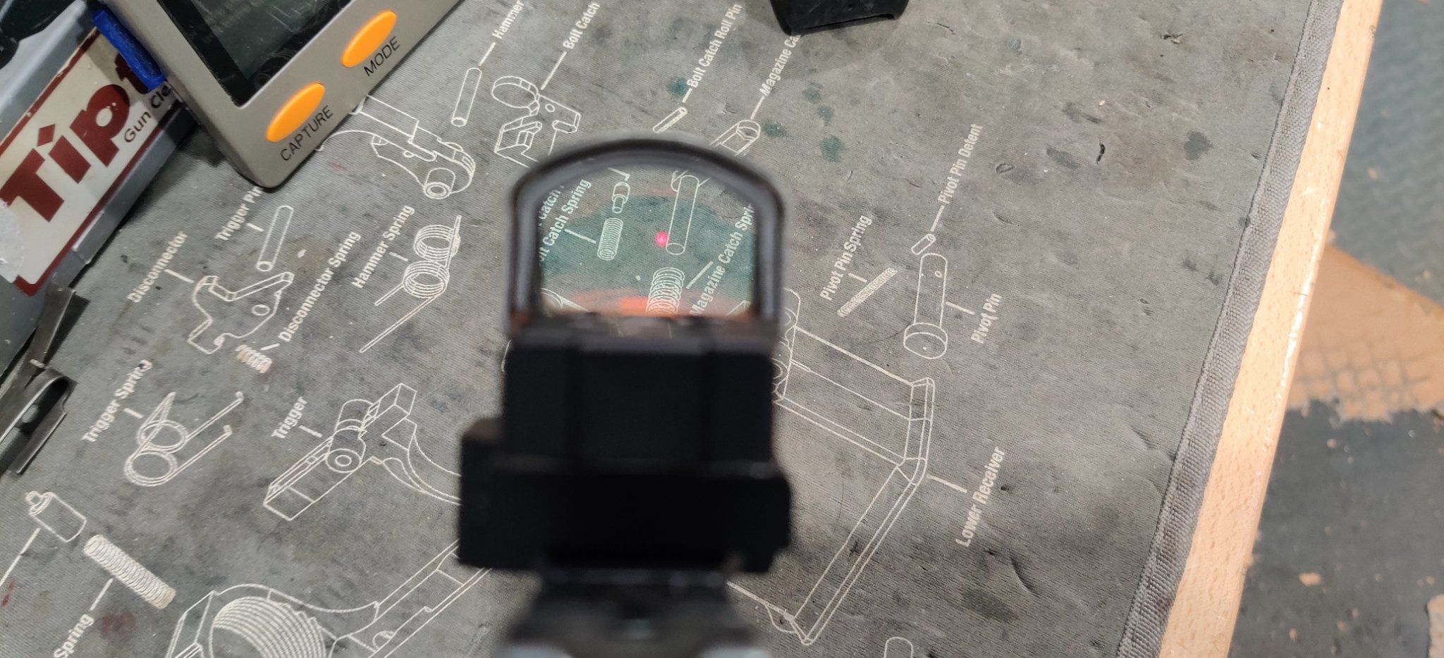

I don't know much about C mores and the round reticle. Do you mean the round hood on the sight?

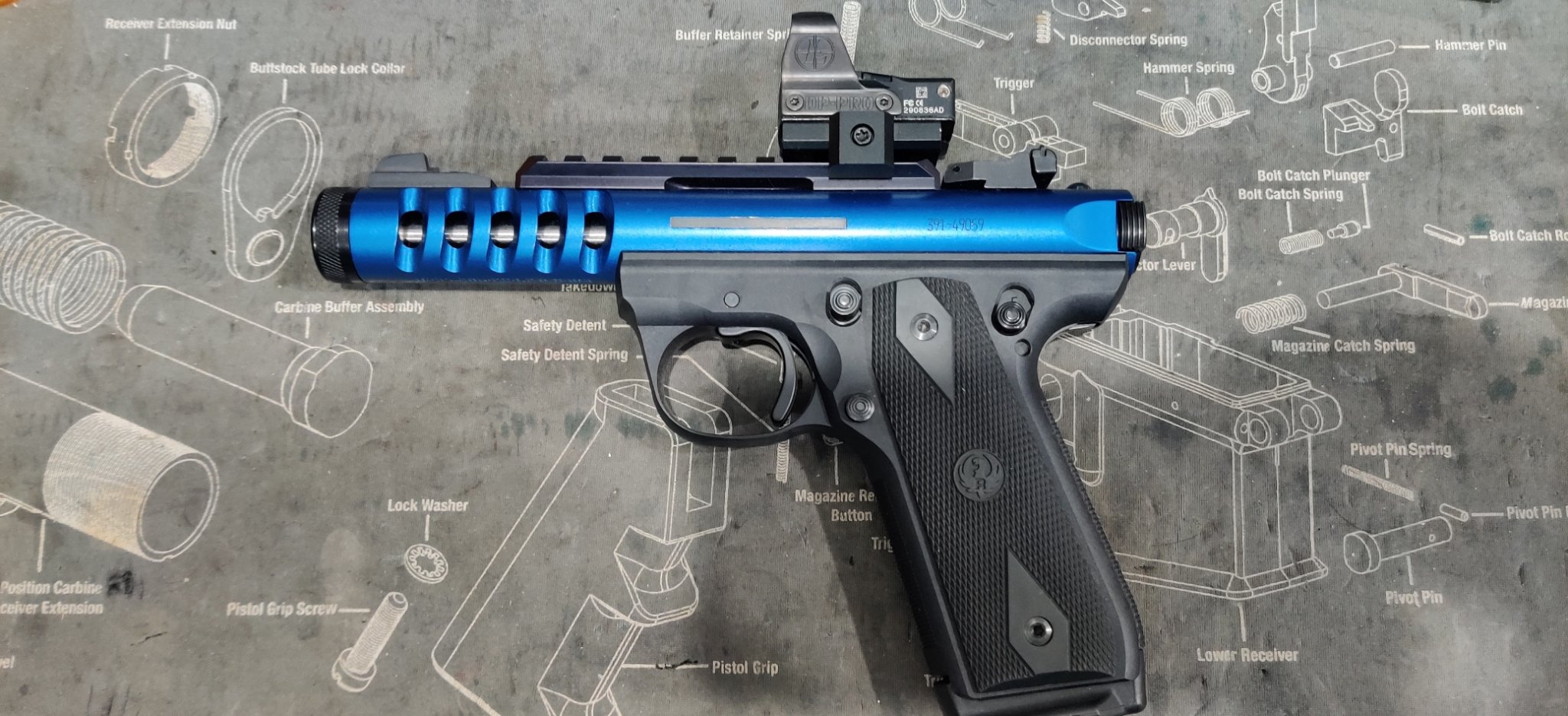

I have a trijicon SRO. It has a round hood vs the square on the RMR. The SRO is a great red dot sight, and its very versatile. I've mounted it on 22 pistol and my AR pistol. I think you would like it a lot.
ALSO, you sure you want an 8 MOA Dot? That is gigantic, and if you are shooting for precision, the dot might be too big...covering smaller targets. Easier to pickup but not so good for precise aiming. I have a 3.25 on my RMR mounted on a glock 19. Its perfect for that gun. On my 22 pistol, which has an SRO, it has a 2.5 MOA Dot, which is great. I would even like to try the 1 MOA Dot for the the 22 to see if I like it.
Lastly, do you know if you have astigmatism? The degree to which you have it can affect how the red dot looks. I have astigmatism, so the red dots are exactly a crisp red dot. Its like a red dot with a bit of sparkle around it...Its not bad, and I'm ok with it. If your astigmatism is bad, it can be like looking at a red blur.
https://scopesfield.com/best-red-dot-sights-for-astigmatism/
The gun on the right has an SRO and the middle gun has an RMR.
Ignore the drop test and the full auto lol.

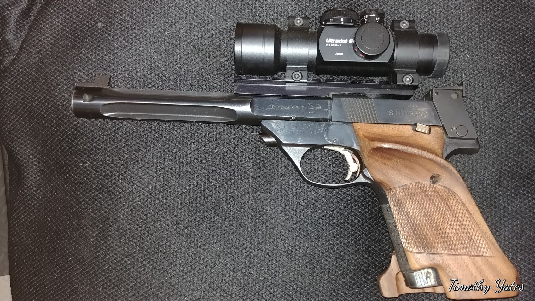

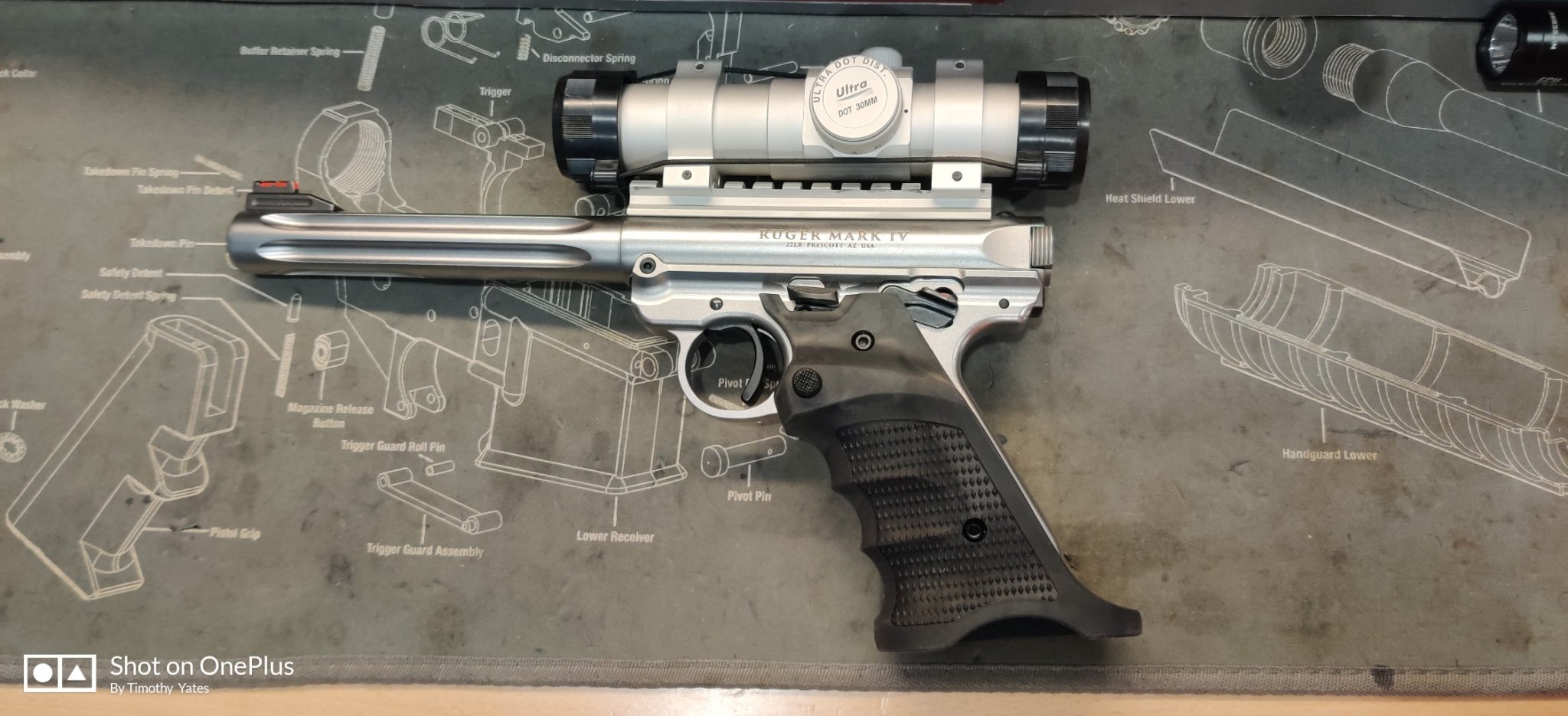

I've gotten away from C-mores though I do still have one or two left. For rimfire pistol, I actually like the Aimpoint 9000SC. Being a tube sight doesn't really slow you down if you've got both eyes open.
Trijicon SROs go on my centerfire action pistols. If you go with a mini reddot, try and find an adapter plate that mounts directly to the 22/45 receiver. That'll save you the extra height versus a rail and clamp mount.

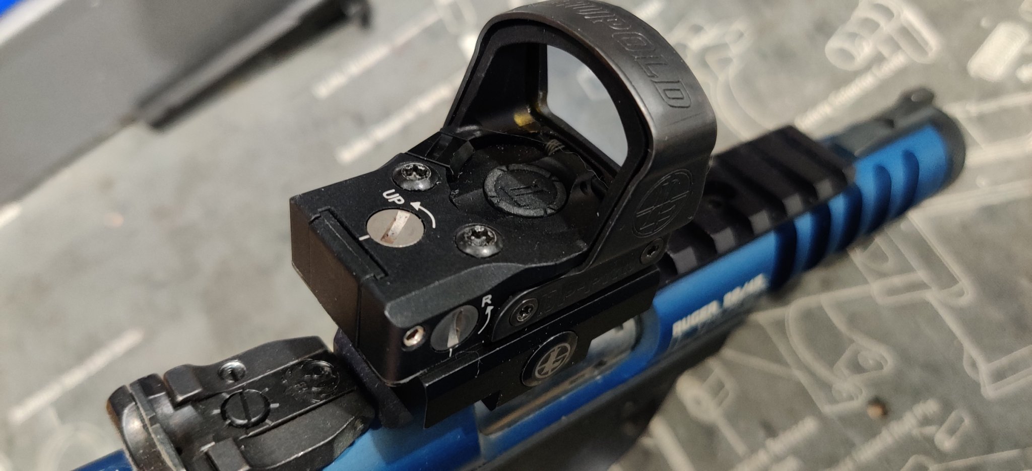

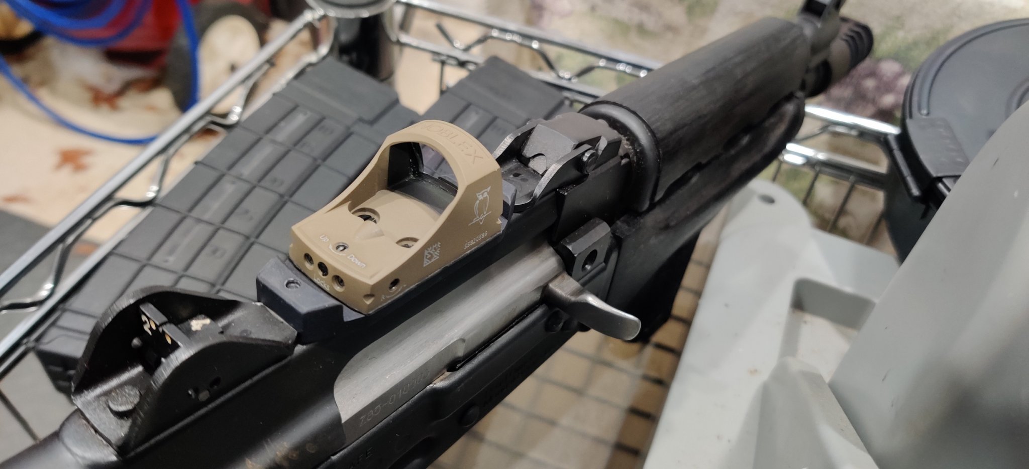

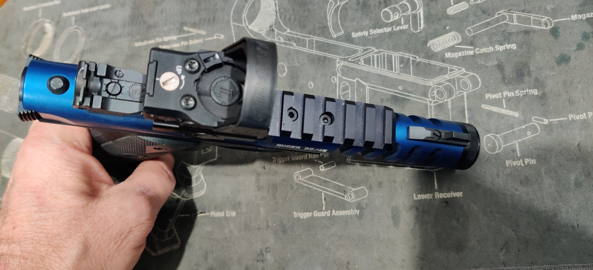

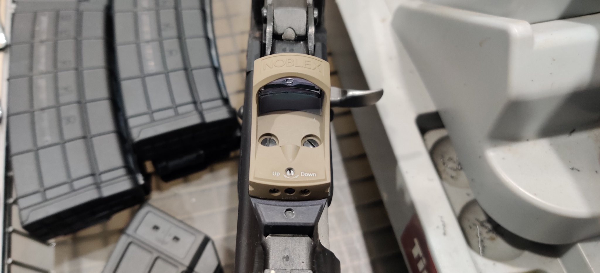

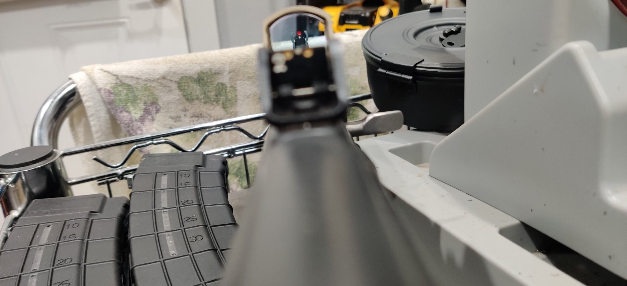

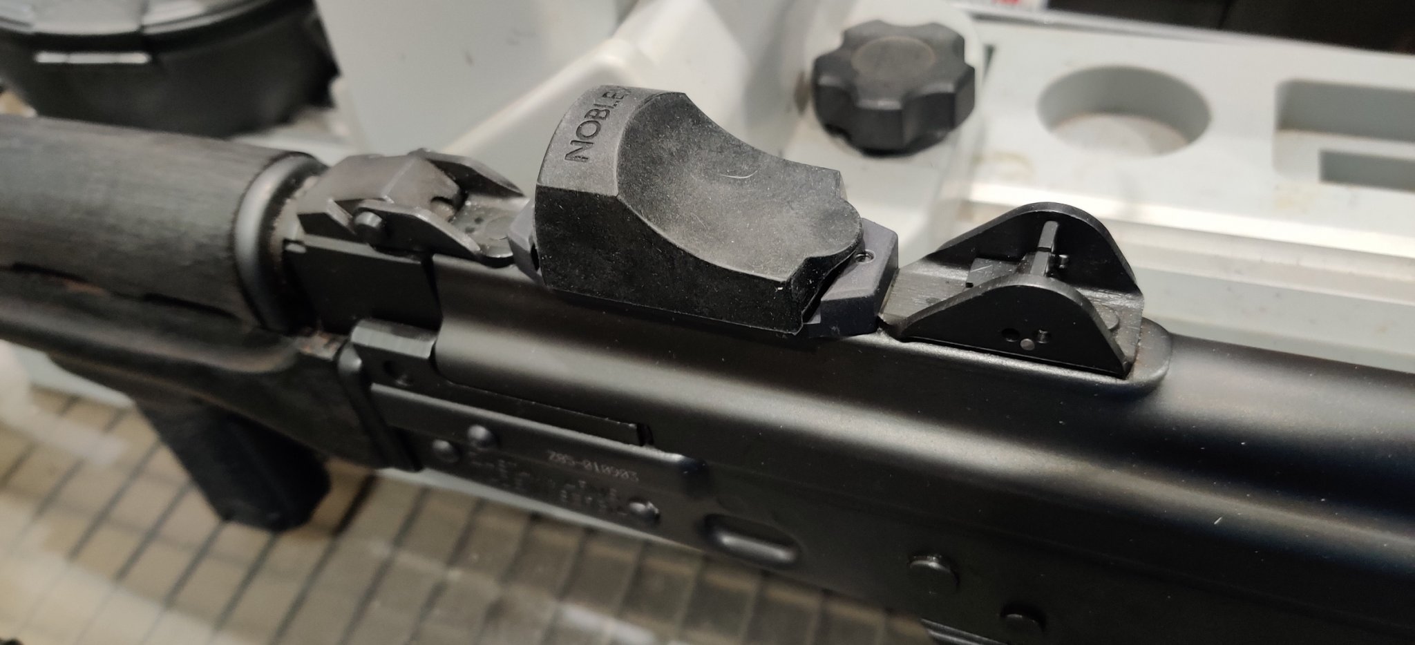

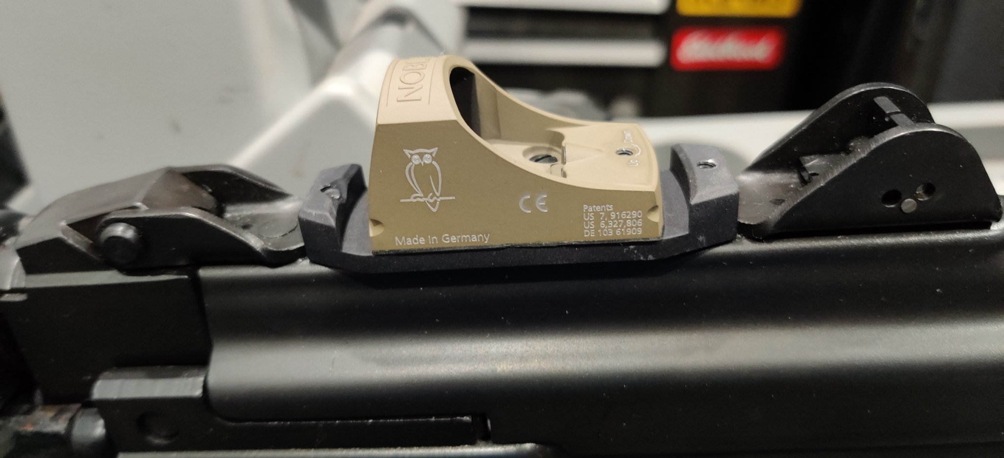

If you want one of the best red dots on the market you should take a serious look at the Leupold Delta Point Pro. I won't go into detail but if you are interested, investigate it. Here are a few photos showing what it looks like on my Ruger MK III 22/45. I normally use a TR-25 on the Ruger but had the DPP laying here waiting on a vz.58 pistol I have coming. American made.
Others I would suggest looking at are the Ultra Dot lineup. American company, made in Japan.
Another good one I really like and can recommend is the Noblex. Made in Germany.
