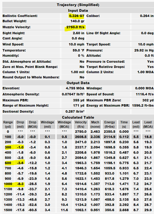

Real World
Here is a chart for a known 6.5 creed 140 eld load. I know this is where it hits, this will be what I compare to.
.326 g7 and 2750 fps
300=1.0
600= 3.6
1000=8.3

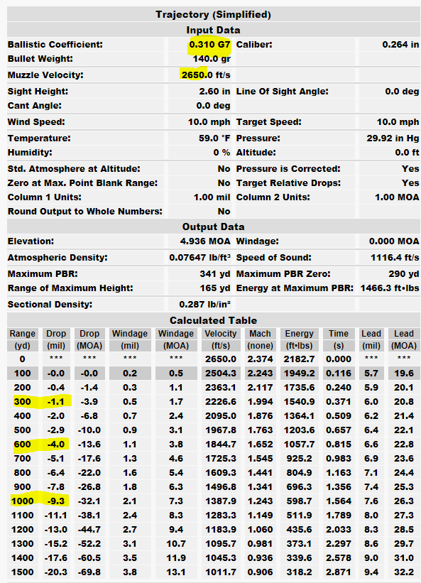

Slow Velocity
This is with 2650 fps entered, 100 fps slower. At 300 yards its calling for .1 more elevation than real world, at 600 its .3 more, at 1000 its .8 different. A pretty good difference.
So we know that it is calling for us to dial in more elevation than necessary at all distances and getting progressively worse.
My first step would be to chrono the rounds to see what they are actually doing so that I can get a good actual known velocity to begin my data collection. If I didnt have a chrono I would then start increasing the velocity in steps that get my 600 yard dope to line up.
300=1.1= .1 off
600= 3.9= .3 off
1000=9.1= .8 off

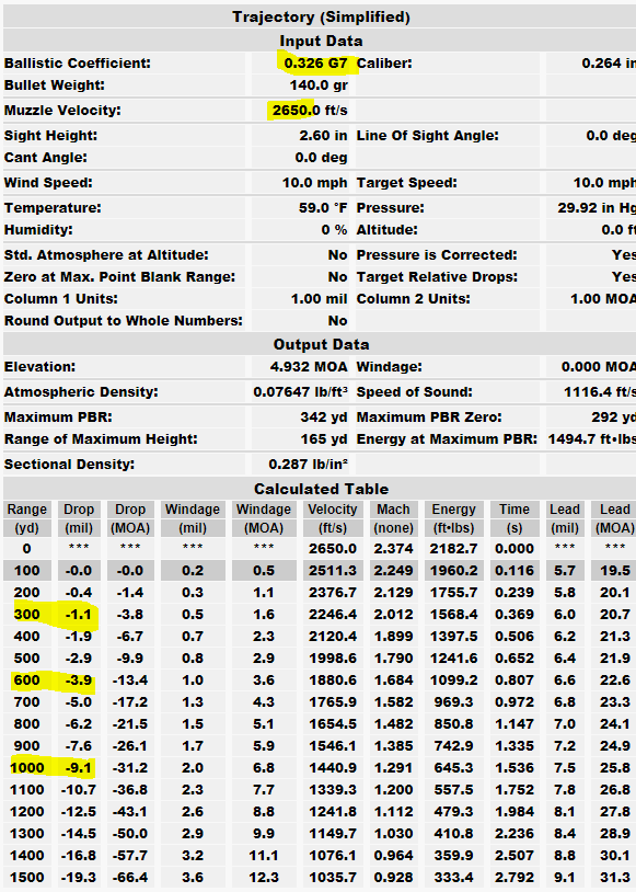

Slow Velocity, Wrong BC
This one has the velocity that same 100 fps slower velocity as right above but I also dropped the BC down from .326 to .310.
300 yards is still only calling for .1 mils more than the real world example, 600 is .4 more and 1000 yards is 1 whole mil off.
So you can see that with the way off BC value in addition to the velocity being low that the 300 yards target is only .1 mils off of real world, the same as the above example with only the velocity wrong. The 600 yards target is .4 off of the real world call but its only .1 worse than the chart with only velocity wrong, the bad BC only contributed to 1/4 of the error in the dope with the velocity comprising the rest of the error. At 1000 yards the dope is a whole mil off but thats only .2 more than the example with only incorrect velocity so I would say that velocity is responsible for 80% of the error here.
300=1.1= .1 off
600= 4.0= .4 off
1000=9.3= 1.0 off
Correct Velocity, Wrong BC
So now that we have shown that the velocity is the largest driving force in our trajectories lets correct it.
This chart is for the correct 2750 but with the incorrect BC value still.
At 300 yards the dope required is correct. At 600 the elevation required is correct. At 1000 yards the elevation required is .2 mils off.
So by truing the velocity we took care of the majority of the problem. Now we just need to true up this BC to get it to match at all distances. I would see what my real world elevation requirement is for 1000 yards and then adjust the BC value until I get the correct answer in the calculator.
300=1.0= 0 off
600= 3.6= 0 off
1000=8.5= .2 off
And a quick little chart with the calls in the same table

The above graph is quite misleading, because it uses the same scale, which obviously makes for bigger "mess" of G1 vs G7, but using a different scale, based on change percentage (the right way to do this) the overall net difference is much smaller. I'm not saying that G7 does not yield a "flatter" curve, just pointing out how to do a proper comparison.
On the other hand, no need for "dozens and dozens" of data points (marketing BS), because any CD-based curve uses no more than 10 or 12 points. At KO2M a number of guys ran G1 ballistics and still made the top five... G7 is overrated when comparing to G1. Any serious test will clearly show that G1 can produce head-to-head numbers when compared to G7 given the proper data.
