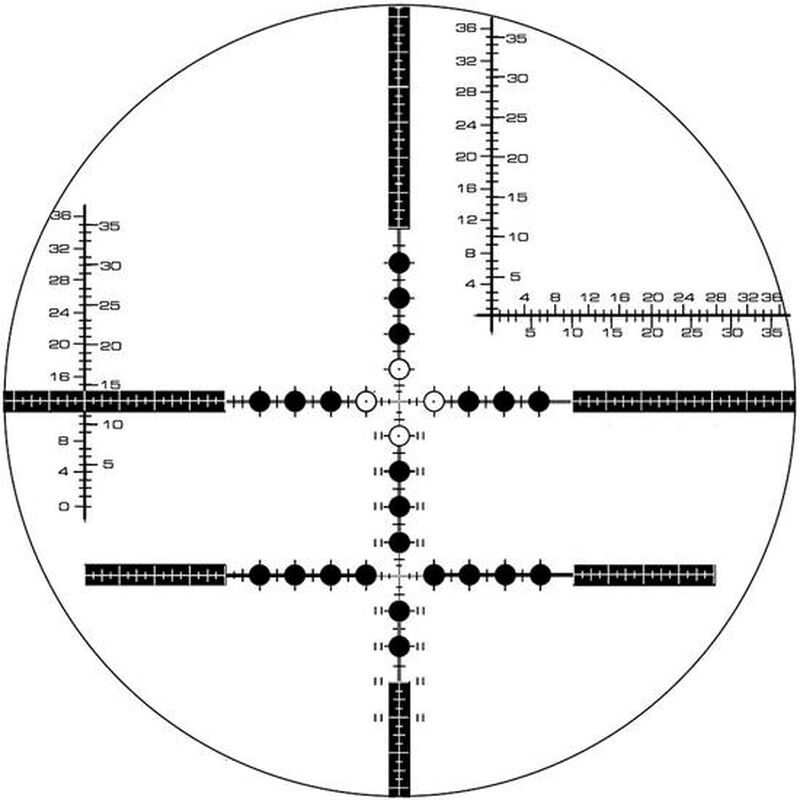

My primary load and zero is 77gr @ 63y. It has to be at 63y for the BDC to work.
However, I like to use 55gr for plinking. It has to be at 100y for the BDC to work.
The amount of clicks needed to go from 63y to 100y is dependent on the velocity of the round you are using. I'd need to go from my 63y zero which I use for my 77gr stuff, to a 100 yard zero for use with my 55gr stuff. Strelok says 2 clicks for 77gr stuff. 3 clicks for 55gr stuff.
What scope are you running?

Zero for the load that impacts low at 100 yards and set the zero stop. DOPE yourself to whatever yardage you like. Write all that shit down.
Now, dial back to zero and shoot the load that impacts higher at 100. Find the zero dial up. Make a note of this "zero". Now, DOPE yourself to whatever yardage you like. Write all that shit down.
It doesn't matter what scope you are using.
EDIT: I guess it matters a little if you don't have a zero stop scope. If not, upgrade to one that has zero stop just for the simplicity.

I think you’re letting the solver make it too complicated. If all you want to do is hold with the BDC- Zero the 77gr load. Now shoot the 55 gr load at 100 and note where you need to turn the turret to zero it. Mark the turret where it zeros the 55gr load at 100. Now you can start at zero and use the 77gr to hold over or you can start at the mark and use the 55gr to hold over.
If you want to be able to dial-
Zero the 77 gr load where you want it zeroed. Now shoot the 55 gr load at 100 and input the impact location into your solver. Don’t turn the turret to zero. In your solver set your zero as not on center, usually called zero offset I think(random example 1.5” high and .5” right or wherever it lands). Then you can just select that bullet and find the distance you want and it will tell you where to dial.

If you cannot zero it at 100y..
Your strelok gun profile has 100y zero for the imi load.
So to enter your PMC profile, enter new cartridge and input distance to 63y.
Then change the zero until it matches your PMC zero.
I recommend zeroing to whatever distance you most often can shoot / verify
Zero the one that requires a 63yd zero at 63 yards.
Shoot the 100yd zero load at 100yd.
Note POI error.
Dial that difference when you shoot that load.
Reverse that dialing when you go back to the other one.

I’ll disagree with the BDC being stupid. It has it’s place and tweaking the elevation a bit can have a man on target with effective hits out a long ways. It’s not necessarily a “precision” tool but works well to 500 yards on targets far smaller than mansize. For semi auto’s and deer guns out to reasonable distances, they work well. Beyond that, not so much.
BDC is fine for the round it’s designed for. But doing what’s going on here is more trouble than it’s worth.

what scope? Im having trouble understanding how a BDC lines up exactly with 2 different loads?
You must not have played around with BDC scopes. A scope with a 556 bdc will line up nicely with 55gr - 77gr and even across different barrel lengths. Fudge the zero a a few clicks one way or another and practical hits are easy to do out to 500 yards or so. While it may not be dead nuts, you can be within a few inches high or low all the way out.
I like to line up the 300 yard hold fairly close and let everything else line up as it does. If you aren’t walking around with a rangefinder all the time, being close enough is close enough because even if something lines up perfectly, the man judging distance will probably be off.
